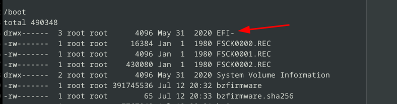

16 minutes ago, Thundermonk said:
From what I can tell it was using UEFI boot.
You are using legacy:
otherwise this folder would be named EFI (without - at the end).
Maybe try to switch to UEFI and see if that helps (click on the blue text Flash on the Main page, at the bottom click Permit UEFI boot and click Apply).
After that you should be able to boot with UEFI.

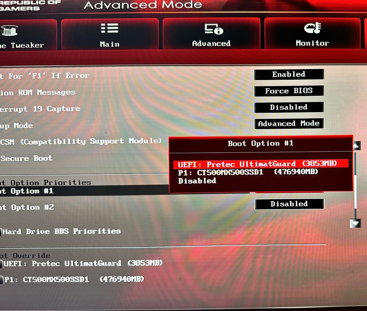

Not sure if you are looking at a different motherboard bios?
The only refrence I could find to UEFI was in the images attached, changing it to "UEFI only" causes it to boot in to the bios constantly. Could that folder be a handover from a previous system I used to run? The seccond image to me suggests its booting in UEFI?
The above screenshot is your USB boot device... You have to click on the Flash drive on the Main page as mentioned above in the Unraid WebUI and follow the steps from above to allow UEFI boot.
When the folder is named EFI- it is not possible for your BIOS to boot into UEFI mode AFAIK, this is what the Permit UEFI boot actually does in the Unraid WebUI, it changes the name from the EFI- folder to EFI
Maybe this is why it's working, because you are allowing Legacy too and it eventually falls back to Legacy.
Apologies, totally misunderstood what you meant. I have changed it to permit UEFI boot mode and the folder is now just EFI so looks like that worked. Fingers crossed this works!
Once again, thank you for taking the time to help.

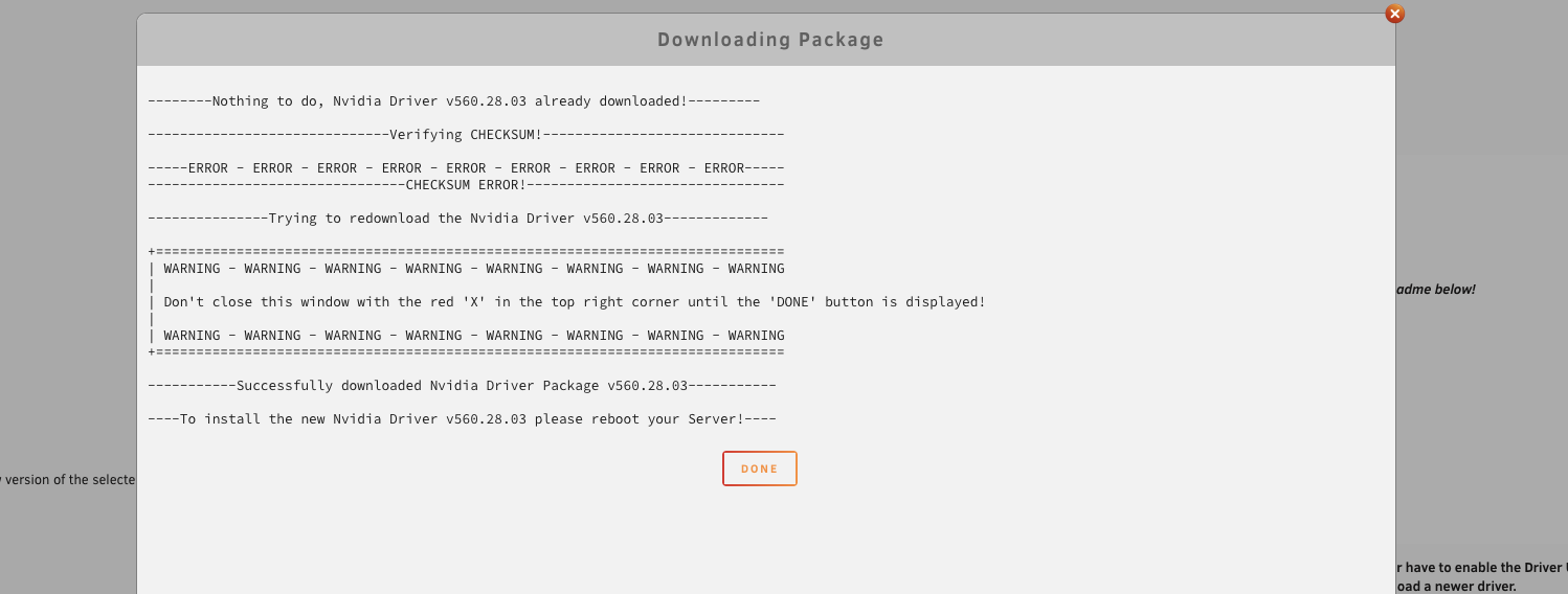

Hi guys. First my apologies if this was asked before. I just could not find this specific problem and is asking for advice and help  please. I am running an unraid server (v6.12.11) on an ASUS ROG STRIX B560-A GAMING motherboard and Intel i7-11700K. It runs fine with Plex and a couple of other docker applications. I also had a Gigabyte GeForce RTX 3060 GPU to transcode plex media, etc. I took this out as the Intel processor's internal GPU works just as fine and besides, I just now build a new server on an AMD processor (ASRock X570 Phantom Gaming 4) with an AMD Ryzen 9 5900X processor. The Ryzen does not have an onboard GPU, so I had to plug in the GTX 3060.
The new server runs fine and will be replacing the older machine, why copyig all the data (Some 65Tb's worth). IT is still busy copying, etc...
The problem is, the new server absolutely refuses to install the NVIDIA driver from the APPs. I installed the GPU Stats plugin, even the Intel GPU Top, but then removed it again as that was just to get the NVTop plugin to install, etc... After all of this, the driver refuses to install and gives me the following message:
Any advice or help will be much appreciated. Many thanks.
Please post a screenshot from the full plugin page.
Are you actually sure that your server has full and unrestricted access to the Internet?
The plugin uses the GitHub API which is known to cause issues with Unifi hardware and AdBlockers.
Please make also sure that you have at least 300MB of free space on your USB Boot device for the driver.
