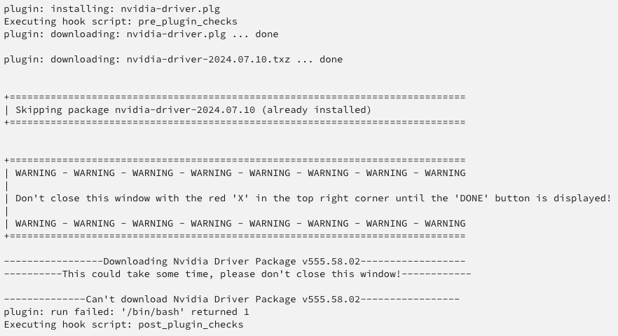

Updates are still failing to automatically download. Just happened again with v550.100. Works perfectly fine if I download manually. Should I try reinstalling the plugin?
Hope you can help.

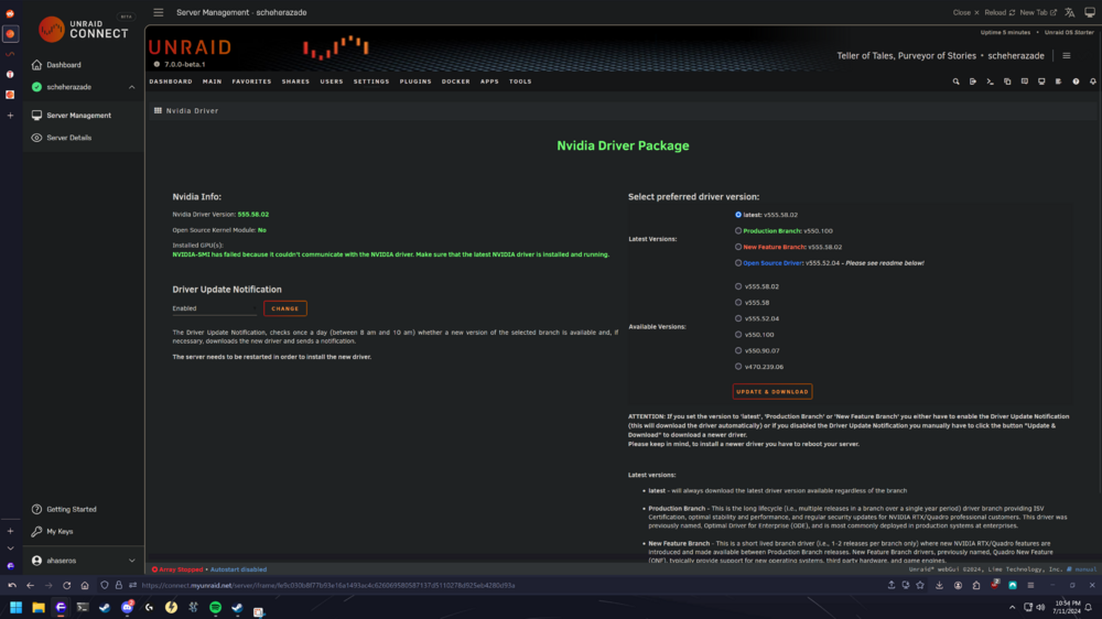

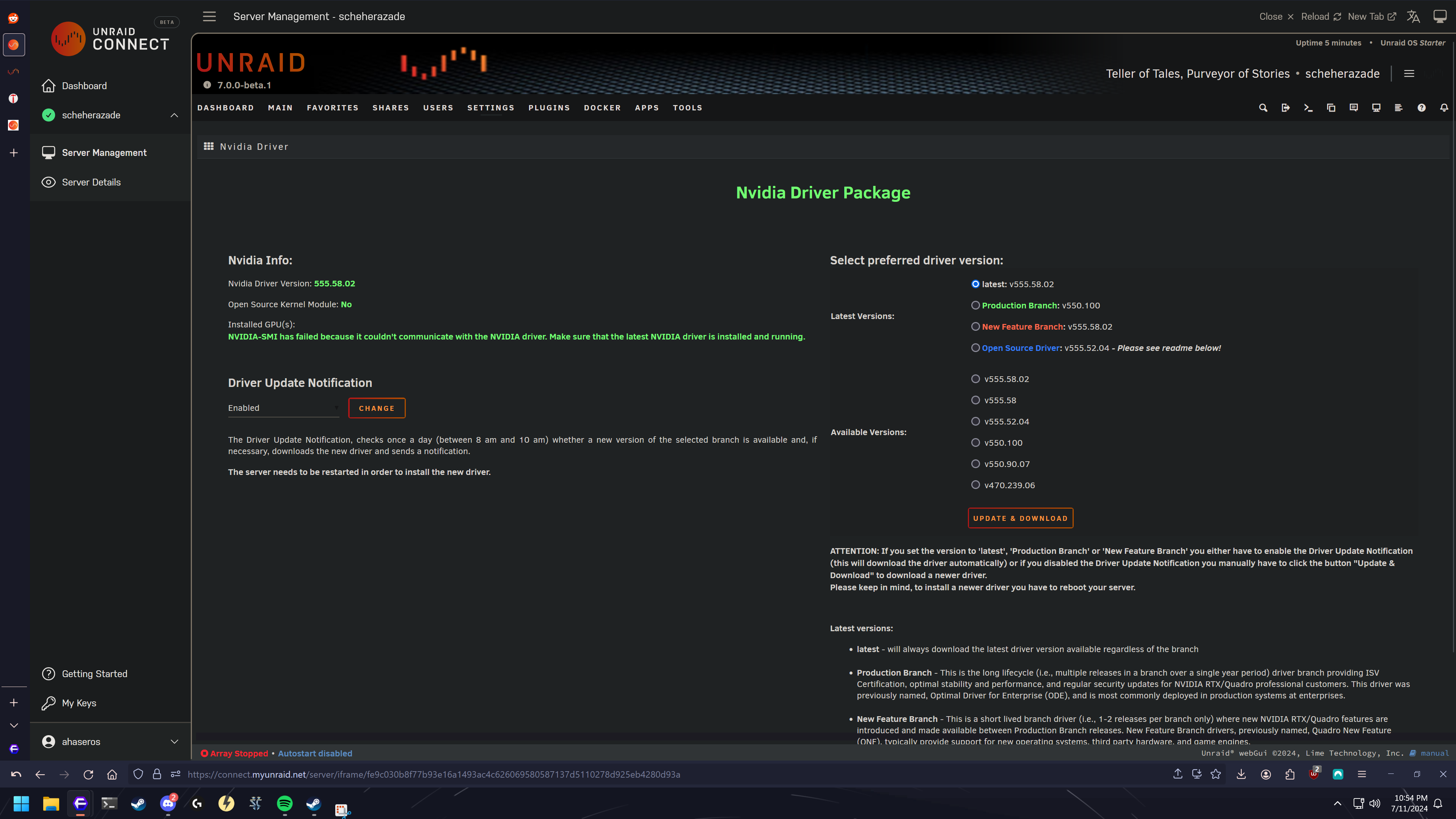

No.
Are you sure that your sever time is correct? I will have to wait until tomorrow morning and see if my test server pulls the updated automatically (last time it did).
May I ask for what do you use the card in your server?

6 hours ago, shiftylilbastrd said:
It's used for Plex transcoding. Just double checked server time and it's correct.
TBH, if you got trouble with the update check disable it because if you just use the card fro transcoding the driver updates won't do much for you anyways.
You have to wait a bit longer until my Test Server checks for updates so that I can see if my Server pulls the update.
EDIT: I found and fixed a bug in the update check for Production and New Feature Branch, please update the plugin, it should work next time if Latest Production or New Feature Branch is selected.

Hello,
I get an "Error" that I can't download the Nvidia Driver.
How can I troubleshoot this problem?
My P400 shows up in System Devices.
Can not install the Plugin with and without the GPU installed.
Please post your Diagnostics and a screenshot from you plugin page.
Thanks for the fast reply and sorry for the Unnecessary post.
I just noticed that the Plugins and Drivers are Stored on the USB Stick.
And I had an 1GB USB Stick which was almost full.
Replaced it and now it works.
Hello! New unraid user here.
I have constructed a NAS including a 3050 6gb low profile card. I am running in to the issue with 'NVIDIA-SMI has failed because it couldn't communicate with the NVIDIA driver. Make sure that the latest NVIDIA driver is installed and running.' I am also having some issues where display cuts out on the card after a short time. I believe that my card is at least getting sufficient power from the pcie slot on my aorus b550i pro ax board, mostly due to the following:
1. running `lspci` reveals:
07:00.0 VGA compatible controller: NVIDIA Corporation GA107 [GeForce RTX 3050 6GB] (rev a1)
2. and running `modinfo nvidia` reveals:
lename:       /lib/modules/6.8.12-Unraid/kernel/drivers/video/nvidia.ko
alias:          char-major-195-*
version:        555.58.02
supported:      external
license:        NVIDIA
firmware:       nvidia/555.58.02/gsp_tu10x.bin
firmware:       nvidia/555.58.02/gsp_ga10x.bin
srcversion:     7CC59AD55E0DD69F0C28592
I am attaching my page and my diagnostics as well. Any help would be appreciated.
scheherazade-diagnostics-20240711-2254.zip
Edited by ahaseros
Here is your issue:
Jul 11 22:48:55 scheherazade kernel: nvidia 0000:07:00.0: Unable to change power state from D3cold to D0, device inaccessible
Jul 11 22:48:55 scheherazade kernel: nvidia 0000:07:00.0: vgaarb: VGA decodes changed: olddecodes=none,decodes=none:owns=none
Jul 11 22:48:55 scheherazade kernel: NVRM: The NVIDIA GPU 0000:07:00.0
Jul 11 22:48:55 scheherazade kernel: NVRM: (PCI ID: 10de:2584) installed in this system has
Jul 11 22:48:55 scheherazade kernel: NVRM: fallen off the bus and is not responding to commands.
From what I see you are using a outdated BIOS too, make sure to upgrade your BIOS first after that continue with the steps here in this post.
It seems that you are using a Ryzen CPU, please make sure to disable C-States in the BIOS entirely, check if Support for large Address Space in the BIOS or Above 4G Decoding and Resizable BAR Support is enabled in the BIOS.
When it is still not working after you did all of the above try to boot into legacy mode instead of UEFI and see if that helps.
It could also be the case that this is caused by a Firmware bug (BIOS issue) however I would first recommend to try the steps from above and see if you can get it working, in it's current state it seems the card is not answering and the driver can't initialize the card.
Are you sure that your power supply is also up to the task and is capable of delivering enough power?
