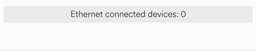

  1. talk about giving up too early, literally just found a solution. thank you my95z34 over at reddit https://www.reddit.com/r/unRAID/comments/1ba2ncl/unraid_gui_isnt_working_says_error_refused/ not sure what this does but this command /etc/rc.d/rc.nginx start did the trick for me and i can connect on the ethernet again edit: if any other newbies see this in the future let this be a lesson to make sure you have telnet/ssh access set up so you can do exactly this solution if it happens to you. In hindsight im glad to have had it enabled otherwise this'd be a pain to resolve.
  2. hi all, have always connected over wifi never been an issue, now recently got plug in the wall ethernet connection. Can connect to the internet just fine it all works but for some reason I no longer connect to the unraid server at http://192.168.0.229/ which it has been since 2 year ago. I can telnet to the machine and sign in I can ping the ip address I can see the shares in windows explorer when i connect with ethernet i get connection refused my media applications are accessible via cloudflare tunnels still. so the tower is very much up and running but for some reason I can't get the ui to resolve in browser. Any handy telnet commands I can try to reset some things on the system? Not sure at all what's going on here. To be clear the only change recently is access to the router is on the ethernet cable not the wifi. tower is ethernet connected to the router, I can see the machines both in the router dhcp settings and both with reserved IPs. i.e. on this machine the router shows me the machine with it's set IP address but when I try connect to that IP the router is telling me is there it won't connect.

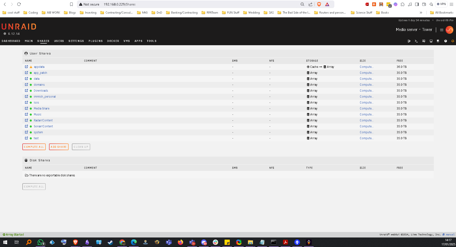

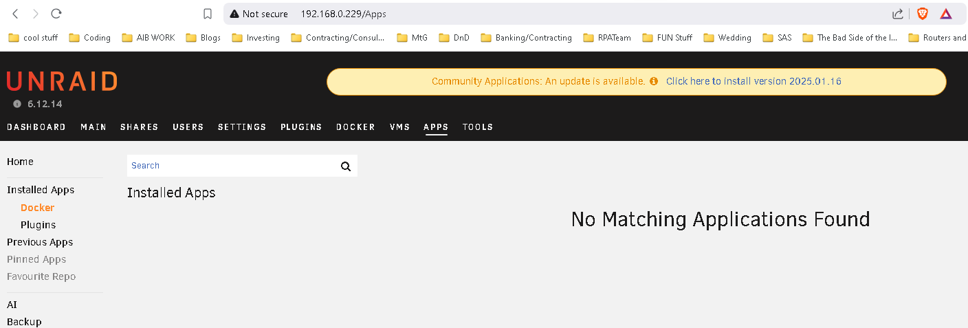

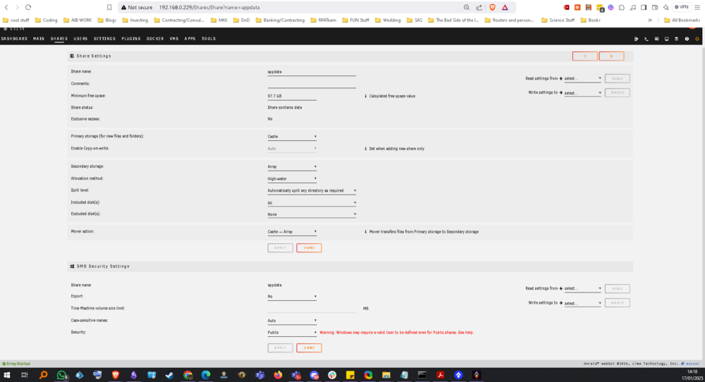

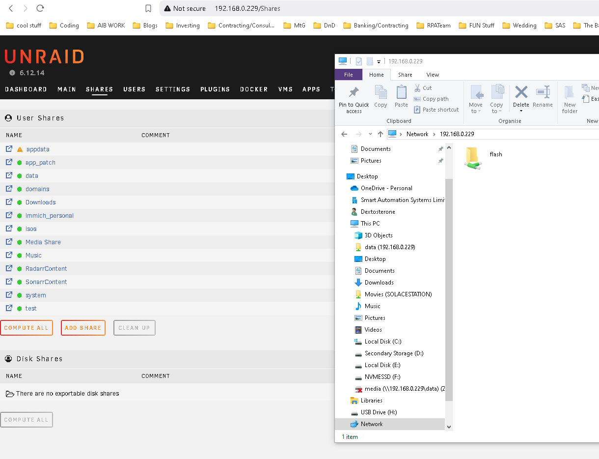

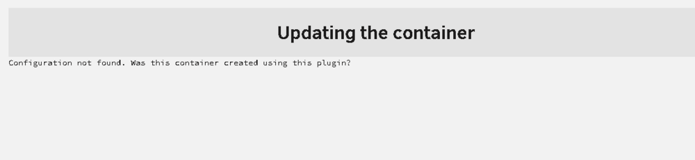

  5. ok thank you @JorgeB and @itimpi the SMB issue I see now is fixed. ei totally missed the export option I thought that meant something else, not sure why. I can now see exported shares over SMB. I still have an issue with plex launching though i suspect it won't only be plex having the issue its just the one I'm looking at. I tried updating it and it says I want to look at the settings and see if there's maybe a conflicting port, transcode option or GPU detail to look at but i can't get to the edit image details in the docker tab, it doesn't show for some reason. most interestingly I tried looking at the apps in the community applications centre but it says i have no matching applications found interestingly I know immich is working and cloudflare as i can get to the served port on open internet so they work alright but they're not showing in comm manager. any ideas on this?

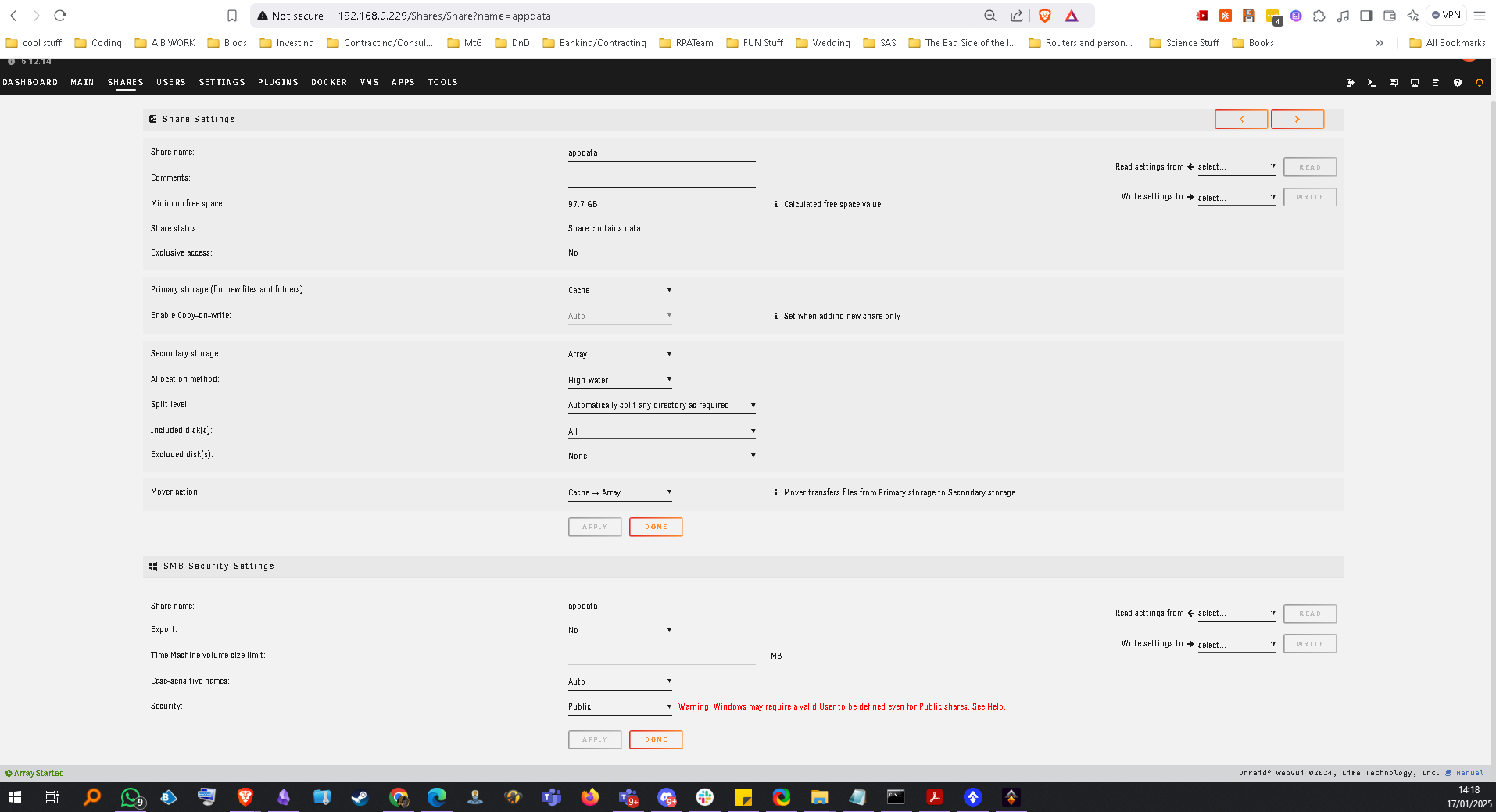

  6. Hi Jorge, Not sure what you mean by exporting them. That screenshot is the full shares page. here's a new image of the shares page zoomed out slightly to show nothing else on the same page unless, apologies do you want this page e.g. the details of the share (this one is appdata when i click on it)

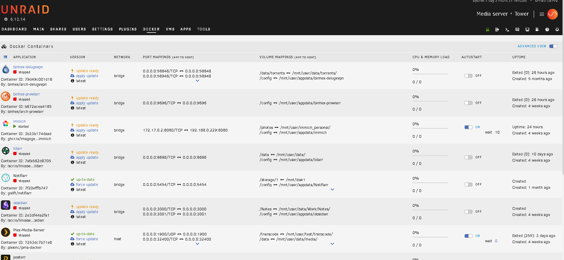

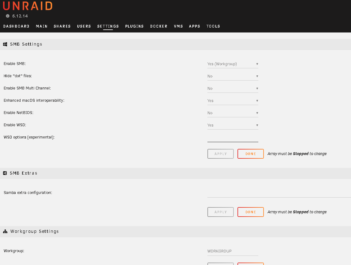

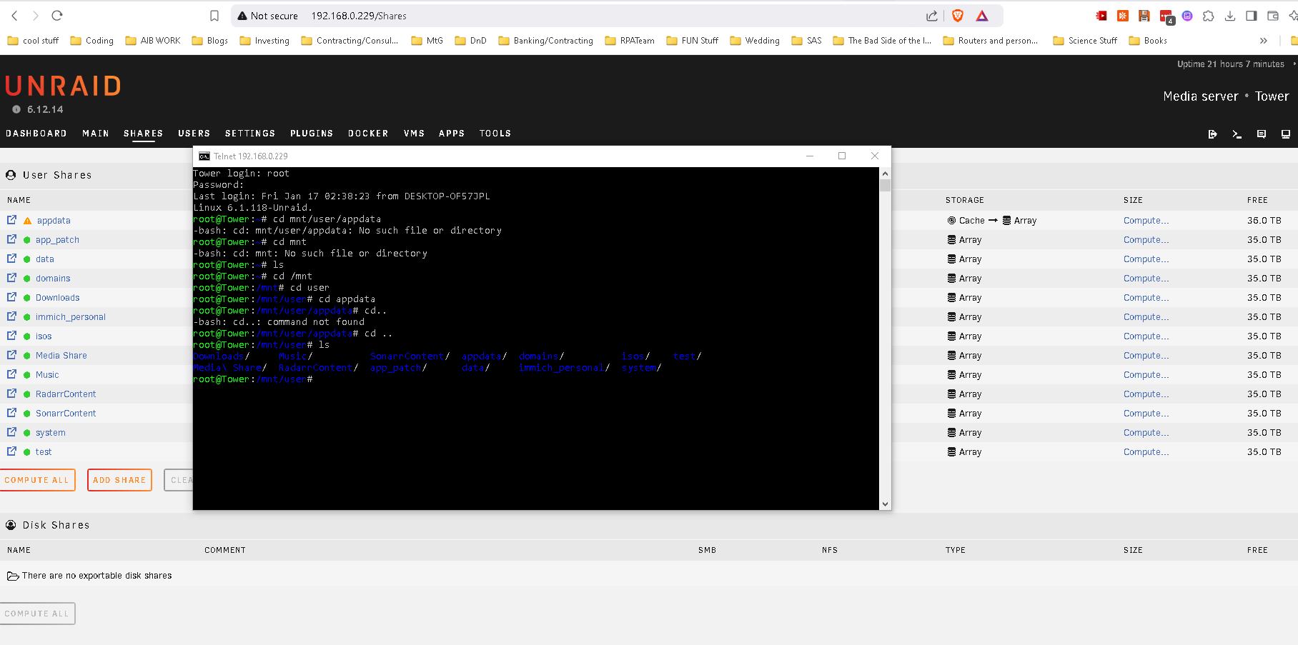

  7. hi all had a power outage last week and seems like the USB corrupted. rebuilt the USB and now curing recovery of the server I'm encountering one thing after another. Current issue, potentially one of the last: I can see my shares on the system but with all the SMB settings turned on they won't show on my machine when I connect. here you see my flash I've made public jus to see something and the other shares in the background that are all there and visible. I can telnet to these shares on the machine: e.g. so the content definitely there and viewable just not sure why windows won't connect. another symptom, potentially unrelated but in case it is related: some of my docker containers work without issue immich, PostgreSQL and cloudflare but the other images e.g. plex won't start and show 'bad parameter' at a guess this is because the config for appdata is on the cache and it can't see it for some reason. other docker images like sonarr have the head challenged auth issue which I need to reset but can't until I can get to the file drive (could probably do it on SSH but i haven't done that before only done it via smb update the txt file directly). one other note: when I rebuilt parity my second disk had an error and disconnected, not sure why will look into it, just going to new config it potentially but it's there as an issue either way after the outage so if any one has any ideas, I'm looking to understand where should I debug next. are there some other settings I can configure and try out maybe see if that 'resets' the smb function or an alt way of connecting to the machine maybe. just a little stuck where to go next. thanks SMB settings
