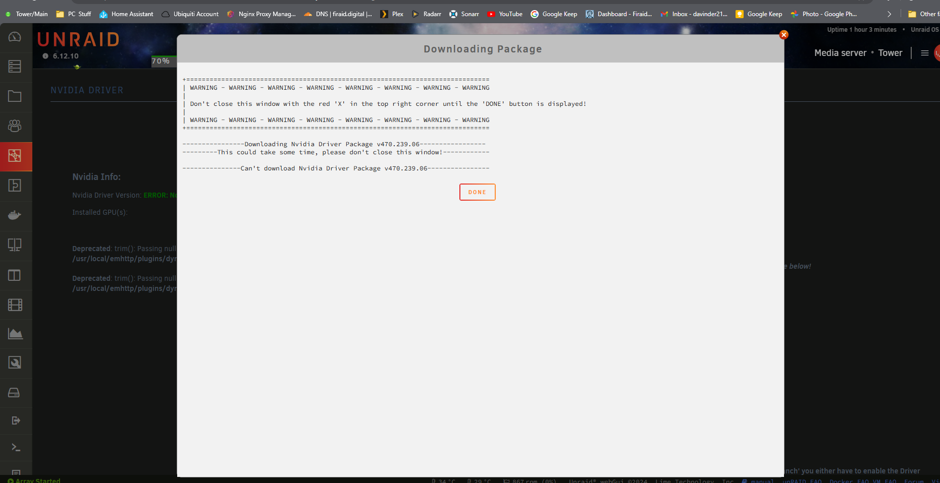

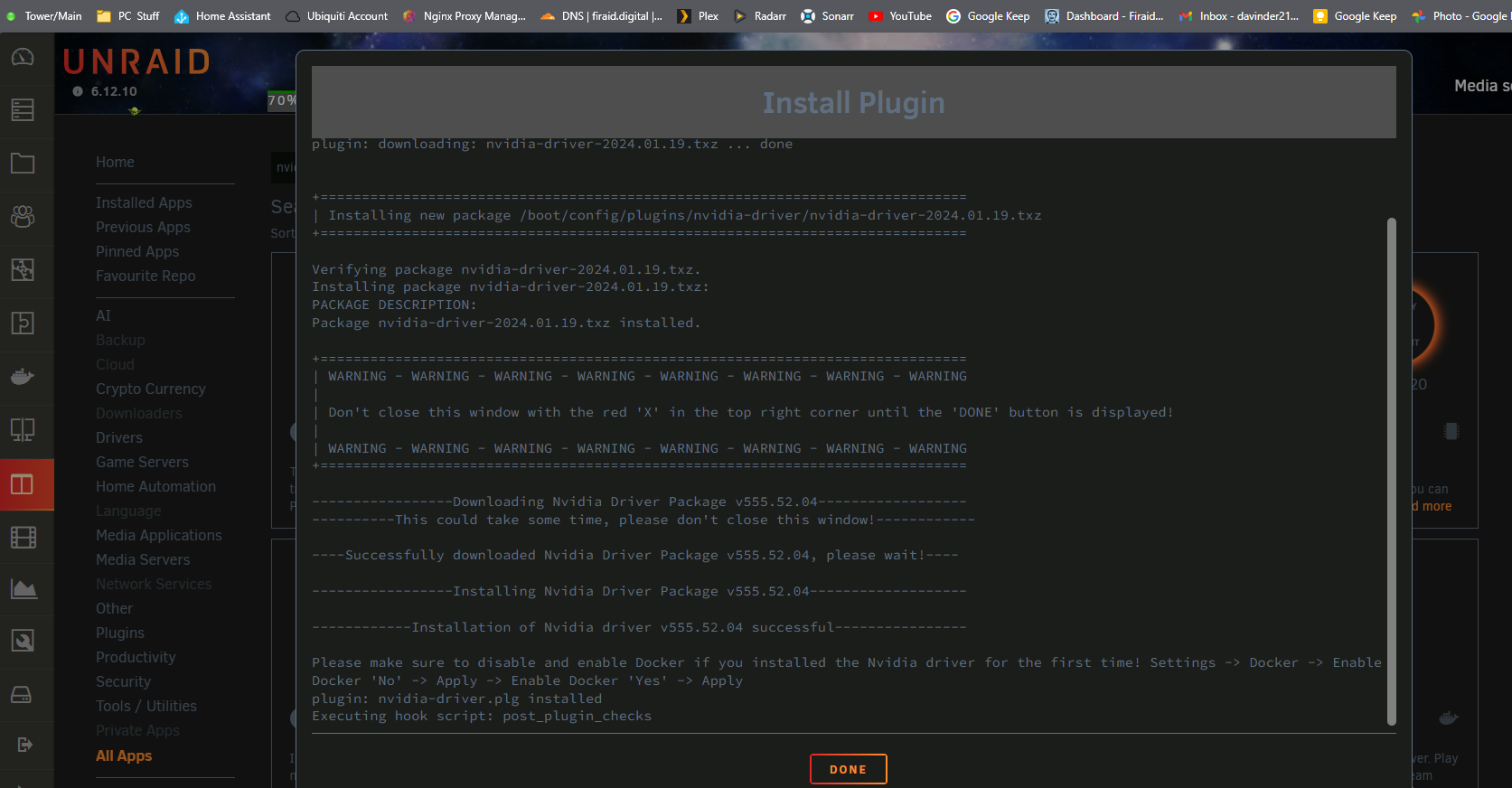

10 minutes ago, ich777 said:
In your screenshot I see this:
This is a indication of a corrupt installation from the Nvidia Driver plugin, to fix this do the following:
  1. Uninstall the Nvidia Driver plugin
  2. Reboot
  3. Pull a fresh copy from the Nvidia Driver plugin from the CA App
  4. Reboot (or restart the Docker service)
Perfect TYVM
Looks good now
thank you for the swift response

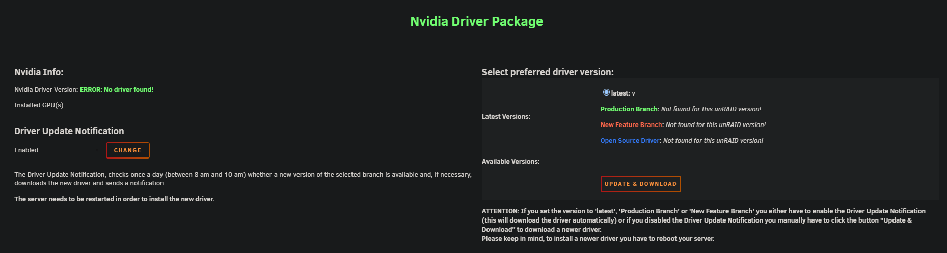

4 hours ago, thesr5 said:
now i get this error message
Please post a screenshot from the Nvidia Driver settings page.

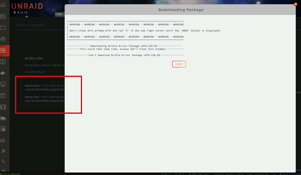

Hello, i've just realized my gpu is not being recognized anymore in UNRAID, this is what i seeimage.thumb.png.5412edca9ec9feff608b20e503bbcfa9.png
If i click on "Update & Download" i get this message:
how can i solve it? I've tried restarting the server to see if it was going to dowload an update but nothing, if it matters my gpu is a P4000.
Nedless to say i obviously have (had?) the nvidia drivers installed and everything was working fine.
