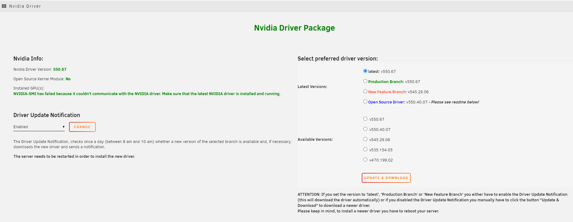

Hello,
I just got an Gigabyte GeForce RTX 4060 OC Low Profile. The "Supported products" shows RTX 4060 so I hope the Low Profile is not a problem.
The error that I am getting is
NVIDIA-SMI has failed because it couldn't communicate with the NVIDIA driver. Make sure that the latest NVIDIA driver is installed and running.
I have followed the instruction and it did not work so I gave the server a reboot but that didn't work either. So I tried uninstalling, reboot, install, then finally another reboot.
I found this in the syslog but I am still new to unraid so I am not sure where to go next.

6 hours ago, aysonohbata said:
there is no card in the devices listed ...
may check
1/ latest bios on your mainboard (1645, yours is 1630)
2/ card sits properly in the pcie slot
3/ GPU is in which slot ? major one ?
4/ power supply attached (properly)
5/ BIOS setup
 - above 4g enabled
 - rbar activated
 - primary display igpu (onboard from your 12700k)
that would be my first steps to look for ...
in sum, your syslog currently shows only 1 VGA device which is your iGPU, like there is no dGPU (Nvidia), so rather a hardware issue and no software ...

I thought my graphic card didn't require the extra power cable but it did. I think it worked once I plugged it. Thank you for your help!
If there is a connector for external power on a Nvidia graphics card then it is always necessary to plug it in.

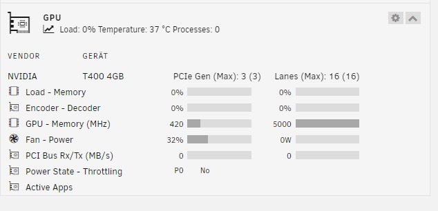

Hello everyone,
I installed an Nvidia T400 in my Unraid server on Saturday. The card is recognized in the POST screen. I then installed the drivers and the GPU Statistic Plugin. After the successful driver installation, I followed the instructions and switched both the Docker and VMs in the settings off and on again (of course 'applied' in between), and restarted the server. I am also greeted by the GPU statistics on the start page:
Then I wanted to go into the plugin for the driver, but in doing so the GUI hangs. Closing and reopening the browser window does not work. But e.g. my Adhome Docker is still running. So I perform a hard reset and the same thing happens again, the GUI hangs up. Hard reset again, this time all dockers stopped, but again the GUI hangs up. Then I uninstalled the Nvidia driver plugin, restarted the server and installed it again. But the problem remains :( I sometimes waited up to 10 minutes for the plugin. The constant hard resets are certainly not good for the USB stick either...
What else could be the problem?

44 minutes ago, BastiKA84 said:
AMD Ryzen 7 1700
Since this is a Ryzen first gen CPU make sure to disable C-States in the BIOS.
I assume you have the card still installed in your system and you have simply uninstalled the driver correct? This seems more of a hardware compatibility issues and has nothing to do with the plugin itself.
Your BIOS version is also out of date:
    Version: 3810
    Release Date: 11/21/2022
The newest version on the Asus site is 4604 (08/04/2024) <- I expect that this update also will help the crashing but please also disable the C-States since on Ryzen 1st gen this was quiet a big issue if it's enabled.
Make also sure to enable Resizable BAR Support and Above 4G decoding in the PCI settings.
Also make sure the Power Supply is still up to the task, your T400 shouldn't draw too much power but just to be on the safe side make sure it is still adequate.
BTW In your Diagnostics I see that the plugin is still installed. However make sure to follow the things above that I recommended and see if that solves your issue.
May I ask if a normal shutdown is working? Just press the Power button 2x short and you should hear *beep beep* and this is the indication for a normal shutdown.
It would be also helpful if such a thing happens if you could pull the Diagnostics, connect through SSH to the server and type in `diagnostics` this will generate Diagnostics that you can pull from /boot/logs/ after the reboot.
