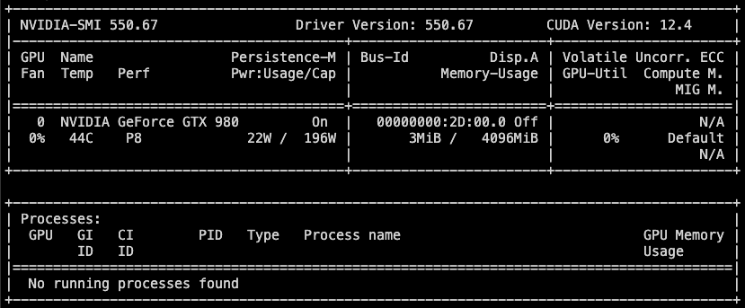

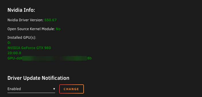

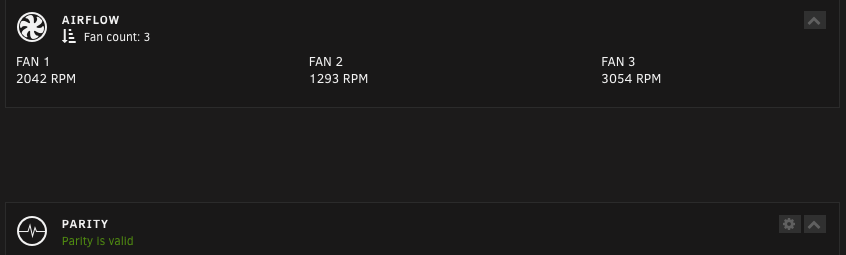

  2. Hello, I am having an issue after upgrading to 6.12.10. I then reverted to 6.12.9 after various tests and the issue persists. After upgrading to 6.12.10 the Nvidia plugin disappeared (my Plex Docker not starting is what tipped me off to this), I reinstalled the plugin and it shows the GPU is installed. Additionally, `nvidia-smi` shows the GPU is detected. However, the Dashboard in Unraid has a blank space where it would normally report the GPU information and Plex does not seem to be leveraging the GPU (the Plex container does start). I have previously tried uninstalling, rebooting, reinstalling, rebooting, etc. Currently, I uninstalled, disabled Docker, reinstalled, and started Docker but the issue persists. I have attached my diagnostics and included some screenshots below. Any help would be greatly appreciated. Maybe there is a more complete way to uninstall and purge related data before attempting to install again? supremacy-diagnostics-20240410-1543.zip
