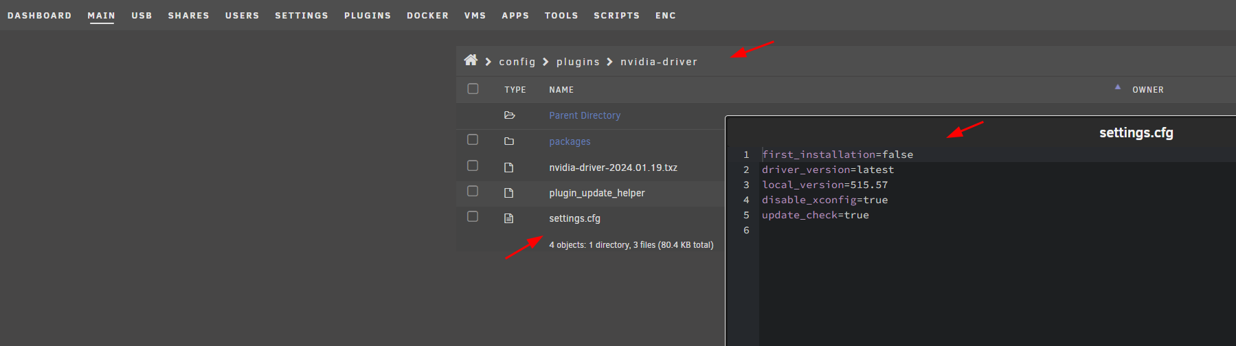

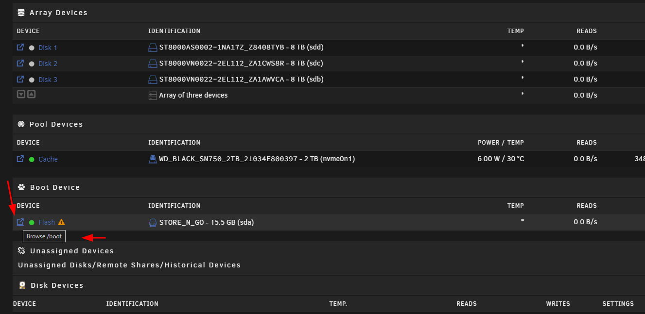

Noob question, how do I access /boot/config/plugins/nvidia-driver/settings.cfg from the GUI?
may ahead, why would you do that anyway ?
but to answer the question ...
1 hour ago, alitech said:
Noob question
From the Terminal:
cat /boot/config/plugins/nvidia-driver/settings.cfg

Hi there
settings.cfg
Thanks for this, here are the config files and the nividia driving config also
Did you yet try what I recommended earlier?
