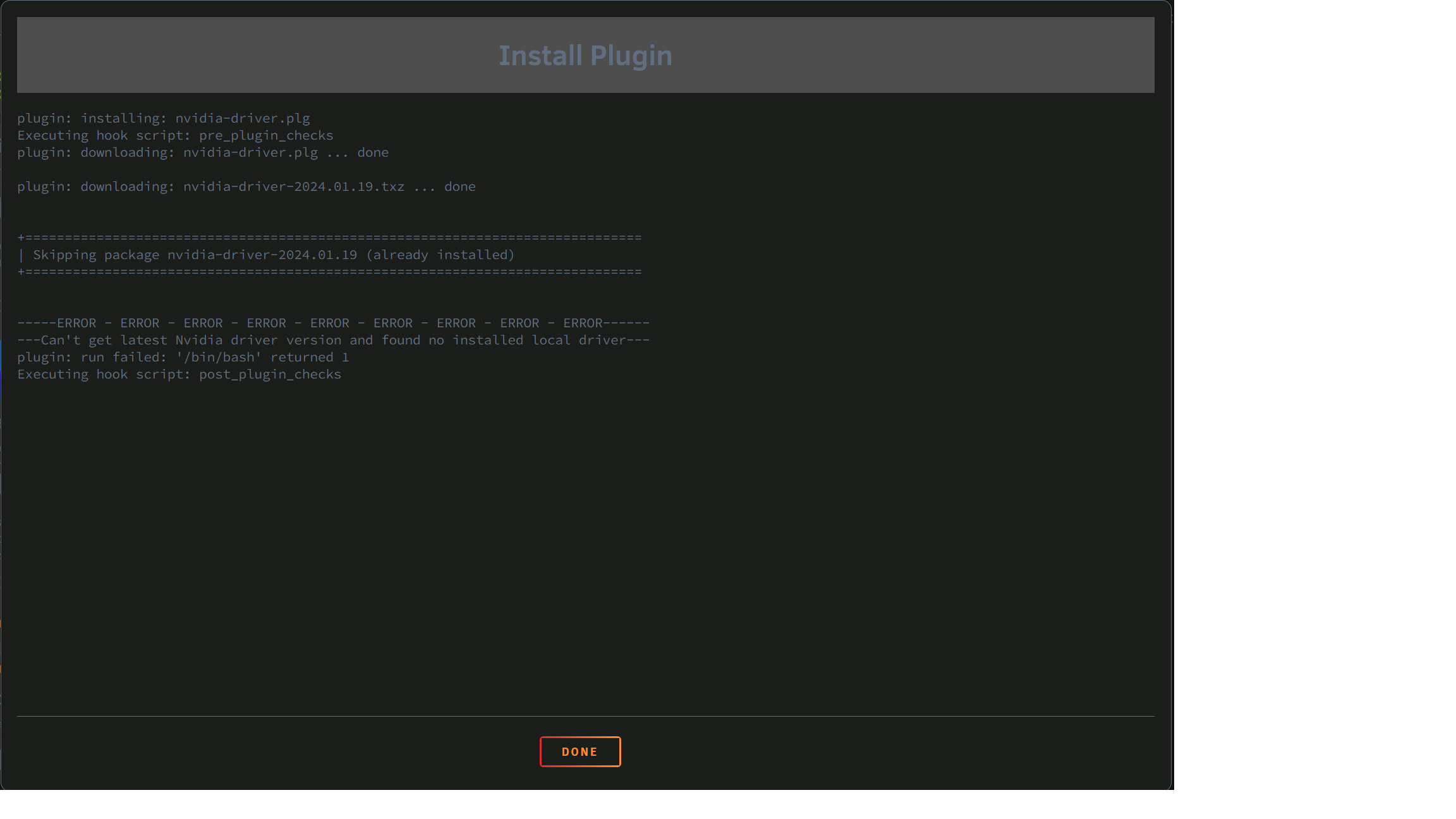

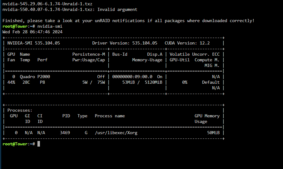

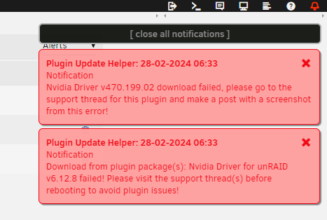

Hello,
working to update my PC from 6.12.3 and I got the following notification from plugin update helper. What is the best way to get past this error? Attached is the nvidia-smi output in addition to the diagnostics if needed.  Please let me know if I can provide any additional information to help.
nvidia-smi output
tower-diagnostics-20240228-0849.zip
Edited by charlesabarnes
forgot a sentence
Try to reboot since the driver plugin tries to download the driver on reboot too.
Keep in mind that the reboot will take a bit longer because of the download.
If that doesn‘t work:
Remove the plugin
Reboot
Install the plugin again
Reboot

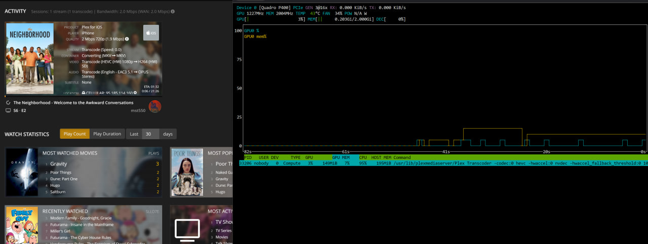

Hi, Plex is not transcoding anymore .. same as the guy above
I'm using latest Linuxserver container .. latest nvidia driver .. every used to work fine .. didn't change anything since a year except updating both
also I can see the GPU in the Plex Console via "env" command
tried to downgrade the GPU didn't work
tried -gpus=all didn't work
tried -gpus device=GPU-XXXXXXXXXXXXXXXXXXXXXXXXXX didn't work
it seems latest plex update issue ? not sure
Update : Solution ( Shut down Plex then delete Codecs Folder from Plex then turn the container back on. )
Edited by Thamer Alfuraiji
solved

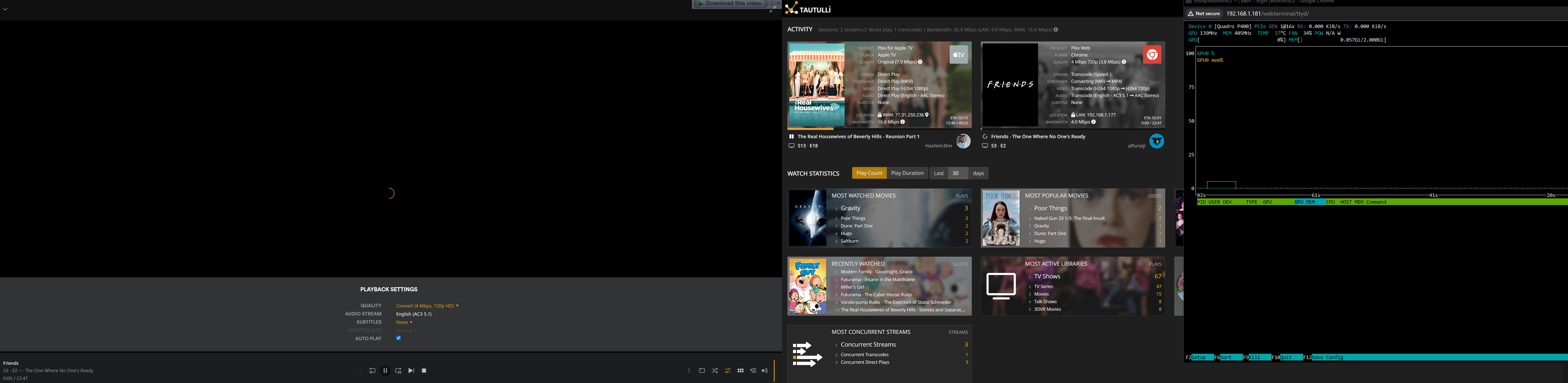

Update : So Plex is actually see GPU and can activate the transcoding process but GPU usage at 0-3% and nothing will stream
this issue occurs only by using all clients + optimization except Plex HTPC on WINDOWS  it works fine even from 4K to 720p !!!!
here is an attachment of ios asking for transcoded session ... stays stuck like this.
second one ( Friends ) nothing shows in the NVIDIA-SMI (NVTOP)
solved
Update : I think the GPU and the NVIDIA Driver aren't the issue .. because I tried to have a direct stream for Video but transcoded audio and same issue happened that means it's a CPU Transcoding issue because as far as I remember GPU can't do audio so only CPU transcode .. so I did turn off GPU transocoding and CPU only transcoding didn't work
now I'm downgrading the container to see if it's a plex update issue .. so far I have reached caontainer version 1.32.8.7639-fb6452ebf-ls202 ( 4.116.1 inside plex server ) and still facing the same issue
solved

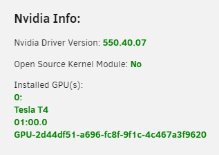

I try to use a Tesla T4 (which is Turing based) but with this plugin and any driver version no GPU is found. At the host can see it. Can you inlcude the Data Center Driver? https://www.nvidia.de/download/driverResults.aspx/221557/de
01:00.0 3D controller: NVIDIA Corporation TU104GL [Tesla T4] (rev a1)

I just updated to 6.12.8 and the nvidia driver failed to install. I have tried to manually add and I get the attached install error. Any ideas? I expect this was a problem in the past.
