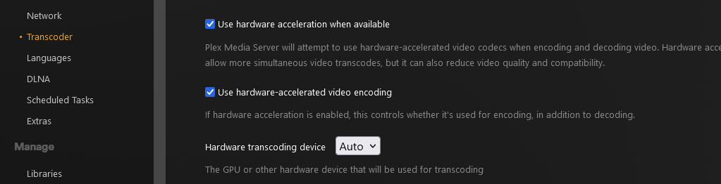

Still nothing.. now the card doesnt even show up only "Auto"
Are you really sure that you‘ve added --runtime=nvidia
I can‘t see it in your screenshot.
Btw are you also sure to force a transcode? If the media doesn‘t need transcoding it wont utilize the card.
Yes and Yes also made sure it isnt HDR but just 1080 for test.

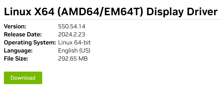

On 2/20/2024 at 5:52 AM, AgentXXL said:
You're not using the correct driver for the T1000. If you go to the Nvidia site and do a search for the latest driver for Linux x64, you'll find that you need to use the 535.154.05 version.
When I check the website for the same card I see this driver version:

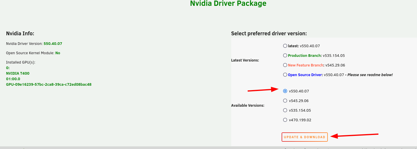

Hmm is there a way to downgrade driver version?
9 hours ago, gekoch said:
550.54.14
I've now removed this driver version, please try to install driver version 550.40.07 it is working flawlessly with Plex and Jellyfin on my server.
I will investigate what is causing that and re-upload the driver when I found the cause of the issue.
Yes, on the plugin page, maybe the new driver is the cause of the issue as another user pointed out already, please downgrade to driver version 550.40.07.
