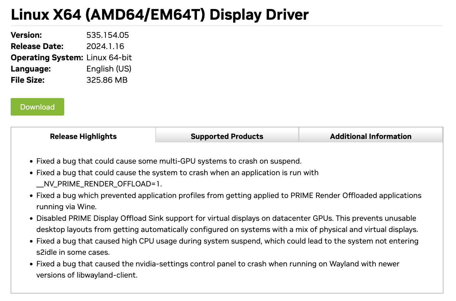

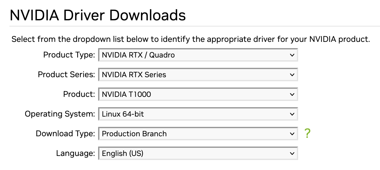

18 minutes ago, G Speed said:
I just set plex up to transcode, but when I do it just gives me a black screen.. Nothing happens
If I revert back to direct play everything works fine
Not sure what i'm doing wrong
You're not using the correct driver for the T1000. If you go to the Nvidia site and do a search for the latest driver for Linux x64, you'll find that you need to use the 535.154.05 version.
BTW you can see all the latest driver versions for the various driver branches from Unix here.

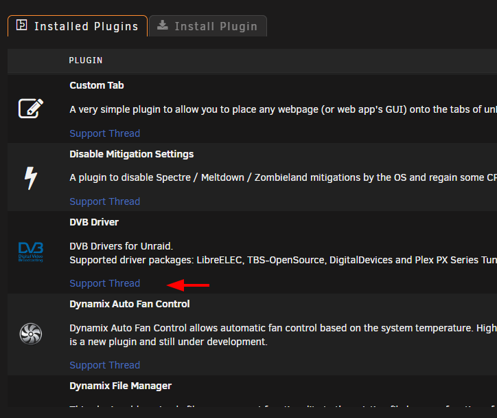

On 2/18/2024 at 11:16 PM, joey911 said:
would you please add "additional setup required for Docker, see forums" or something? Took me a while to find the key values and such but once I did it worked like a charm.
1 hour ago, joey911 said:
Hi, You answered the wrong question.   My question was ...can you amend the store description to note that addtional setup is required and to see the support form?
personal oppinion, while you are looking for a solution to use your dGPU in a Docker, you prolly will land in this support Thread, its always recommended to read 1st and then decide what are the todo's.
every plugin & docker also has a link to its support Threads, here you have a 1st class manual on Page 1 ... so actually, a liitle responsibility should be there to look for the matching Thread and the readme.
when we start writing everything anywhere ... it ll end up in even more questions as nobody starts thinking for themselves anymore, my personal oppinion.
Sad enough you didnt find the linked support Thread
sample
so rather learn your systems (not personally attached to you, thats a general thing) and howto use it and howto use all the already helping points included instead asking for more and more and more text ... which actually alsmost nobody reads anyhow ... sample, see how many questions are here already about VM usage with this plugin, while this is mentioned in the description, on page 1, on readme, ...
i hope you know what i mean, make no sence to add more text, its more or less already to easy to setup and alot dont like to read anymore (more click and fire and forget) anything and rather ask questions which are answered already ... ;)
