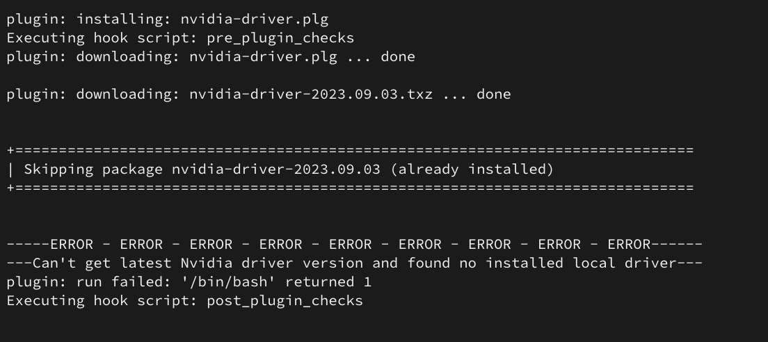

Hey guys.
I'm having trouble installing the nvidia drivers again after I uninstalled them awhile back due to not needing them anymore. I slotted my old card back into my system and am looking to utilize it in docker again but I'm getting this error that doesn't really point me in any direction. If anyone has seen this and can tip me off in the right direction please do. The screenshot of the error and my Unraid diagnostics are attached to this reply.
Thanks!
Are you sure that your server is able to reach the GitHub API?
Do you have any AdBlocking somewhere on your network?
Do you have any Unifi gear on your network?
Make sure that the server can communicate with the GitHub API and from what I can see something is preventing it from communicating with the API.
However, I would also strongly recommend that you upgrade to the latest Unraid version 6.12.6
I'm honestly not sure why the github api was being blocked, but an update to 6.12.6 fixed it. Thanks for the pointers

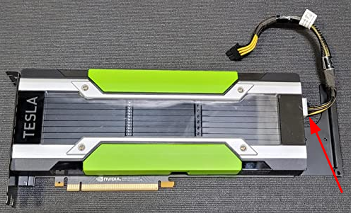

Hi guy´s, i think i fucked up.
I´ve got a P40 for real cheap and i thought it would be a great card for Unraid - Docker - Stable Difuion / Comfy-UI.
But i think it is not supported in the driver v545.29.06 :D
Is there a way to get this to work in docker?

40 minutes ago, dezai said:
Attatched the Diagnostics / Screenshot from the P40 in System Devices / Screenshot from your great driver with the working P2000
Did you read the first and second post in this thread how to get it working in a Docker container?
The card is recognized just fine.
Can you spot why it's not working:
Jan 20 12:18:36 R730XD kernel: NVRM: GPU 0000:82:00.0: GPU does not have the necessary power cables connected.
Jan 20 12:18:36 R730XD kernel: NVRM: GPU 0000:82:00.0: RmInitAdapter failed! (0x24:0x1c:1436)
Jan 20 12:18:36 R730XD kernel: NVRM: GPU 0000:82:00.0: rm_init_adapter failed, device minor number 1
I also noticed this:
Jan 20 12:18:36 R730XD kernel: NVRM: Persistence mode is deprecated and will be removed in a future release. Please use nvidia-persistenced instead.
Did you install the user script from SpaceinvaderOne? If yes please remove it and simply append this line to your go file:

Ok i did some research and it was the last thing i thought about.
I´m using the R730xd with 2x750W PSU ,CPUs are 2x120W ,P40 250W, so i thought i´m fine with the 2x750W (i´ve also tried non redundant mode).
After some research i found out, that Dell is limiting the GPU TDP to 150W (even if you use the 225W Riser) if you are using the 750W PSU.
So my GTX 970 is working fine / P2000 is also working just fine.
But the P40 doesnt work.....
I´m trying to get 2x 1100W PSU´s now.....
Yep i did use the Spaceinvader Script, i´ve deleted it now and put the nvidia-persistenced command in to the "go file"
And yep i´m using your Driver for a long time :)
So a little conlusion.....if my Dell server would give the p40 250W - it should work out of the box with the driver? 😮 😮
I think you missread what I've meant, it says this:
Are you sure that you've plugged in the auxiliary power to the card since it needs auxiliary power connected (I think it's a 8pin PCIe power cable from the PSU)?
Yes, as long as you've connected the auxiliary power:
No no all good :) it is a 8Pin EPS 12V from the Riser and a 8 Pin EPS 12V in the GPU - and i´ve got a cable for exact that setup / R730 - Tesla P40.
But the R730xd can only Support 250W GPU´s with the 1100W PSU´s.
In my server are the 750W PSU´s - if you are using those the PCIE Riser only gets 125-150W to the 8 PIN 12V EPS Connector.
Thats the reason why every GPU in my house is working correctly but the P40 did not.
If you are using the 1100W PSU you will get 225W to the 8 PIN 12V EPS Connector / 75 from the PCIE Slot.
I´ve got 2x 1100W PSU´s from a reseller for 17,50€ each, i can test it hopfully next week.
Part from a reddit thread with the same Problem:
 GPUs require a redundant 1100W power supply and GPU enablement kit
I will get back in touch here when the PSU´s are in the Server.
Edited by dezai
Hey Guy´s, i can confirm that the problems from the "wrong cable errors" came from the 2x750W PowerSupplies.
I´m now using the 2x1100w and it is working.
But i have another problem, Tesla P40 doesnt go to the Idle State - it stay´s at P0 and uses 50W, is there a fix for that?
