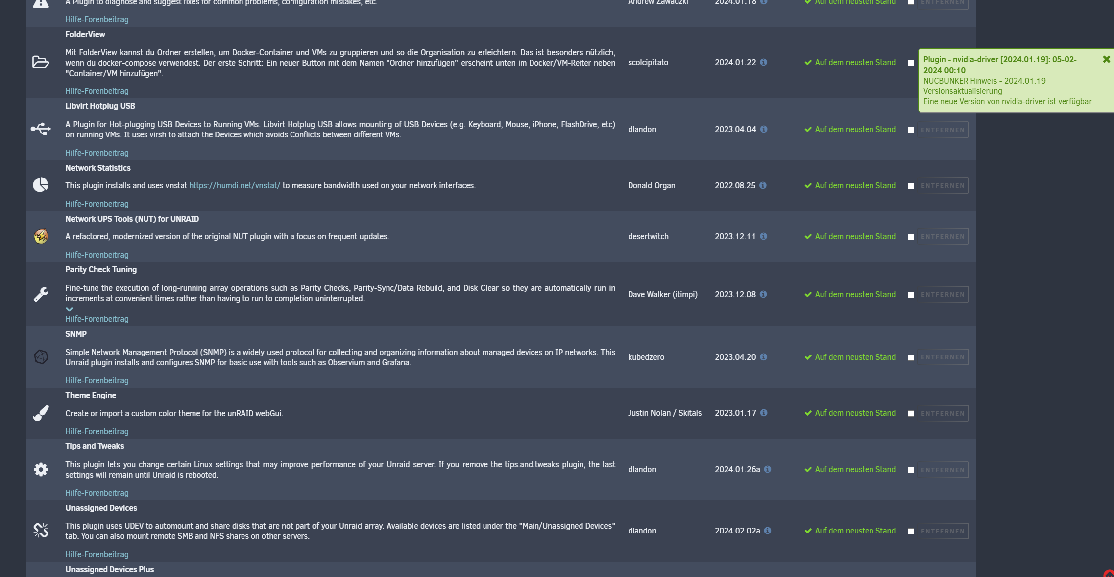

Hi y'all,
I'm unable to update the Nvidia plugin & the warning tells me to not reboot until I've fixed it!
Just updating from UnRaid 6.11.5 to 6.12.6.
Firstly the Nvidia Driver plugin seems to want to download v470.141.03 even though it seems to be on 525.89.02 already?
I've checked my Pihole and ad blockers and nothing seems to be blocked.
Any ideas please? Maybe I'm missing something obvious
Also many thanks for the plugin, I've been using it for a while and this is my first problem with it!
Does your server has a active Internet connection on boot? So to speak does the PiHole that you where talking about run on your Unraid server?
If your server has a active internet connection on boot then simply restart but keep in mind that the boot will take longer since it will download the driver on boot.

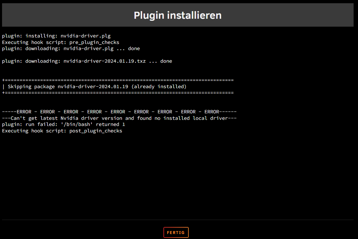

hello Ich777
I can't install your nice drivers. I previously had an A380 from intel installed for Plex. Now I wanted to install a T400 for space reasons. but the driver can be installed.
I get this error:
plugin: installing: nvidia-driver.plg Executing hook script: pre_plugin_checks plugin: downloading: nvidia-driver.plg ... done plugin: downloading: nvidia-driver-2024.01.19.txz ... done +============================================================================== | Skipping package nvidia-driver-2024.01.19 (already installed) +============================================================================== -----ERROR - ERROR - ERROR - ERROR - ERROR - ERROR - ERROR - ERROR - ERROR------ ---Can't get latest Nvidia driver version and found no installed local driver--- plugin: run failed: '/bin/bash' returned 1 Executing hook script: post_plugin_checks
danke für jede hilfe
nucbunker-diagnostics-20240204-1811.zip
Yep, it has internet on boot, the PiHole is on a separate host so no worries about that.
I'll try the reboot, thanks!
Edit: reboot seemed to work fine, nvidia-smi reports that the driver has been updated. All good. Thanks for the gentle guidance!
Please remove the plugin, reboot, check nothing blocks access to GitHub and after that  try to reinstall the plugin from the CA App.

27 minutes ago, Benjamin Weynen said:
Unfortunately, nvidia driver does not appear in the plugins tab
And what error message did you get? diagnostics, new screenshot?

At the moment it says in CA that the driver is pending?
Didn‘t you wait until the Done button appeared?
Do you use any Unifi gear since its nutorius for blocking GitHub API requests from GitHub which I use to determine the latest driver version.
I really can‘t help here sonce this seems like some kind of network issue.

11 hours ago, Benjamin Weynen said:
🤨 i dont understant this failure 😅
This is because the plugin is partially installed, you still haven't uploaded new Diagnostics.

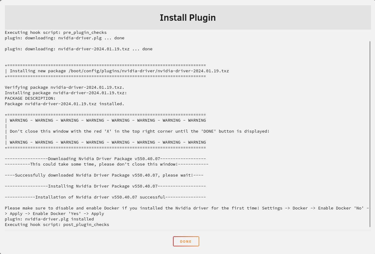

almost the same issue
Sorry but something on your network seems to be blocking access to the GitHub API, I can't reproduce this over here:
Even on the plugin page everything is working correctly:
Please try to execute this command from a Unraid terminal:
rm -rf /boot/config/plugins/nvidia-driver*
after that reboot and then try to install the plugin again from the CA App.
Please keep in mind that you have to reboot in between!
I executed the command and restarted, the error still exists. and now I will send you a current diagnosis according to the procedure and errors. Thanks for your help. Is there a way to manually download and install the driver?

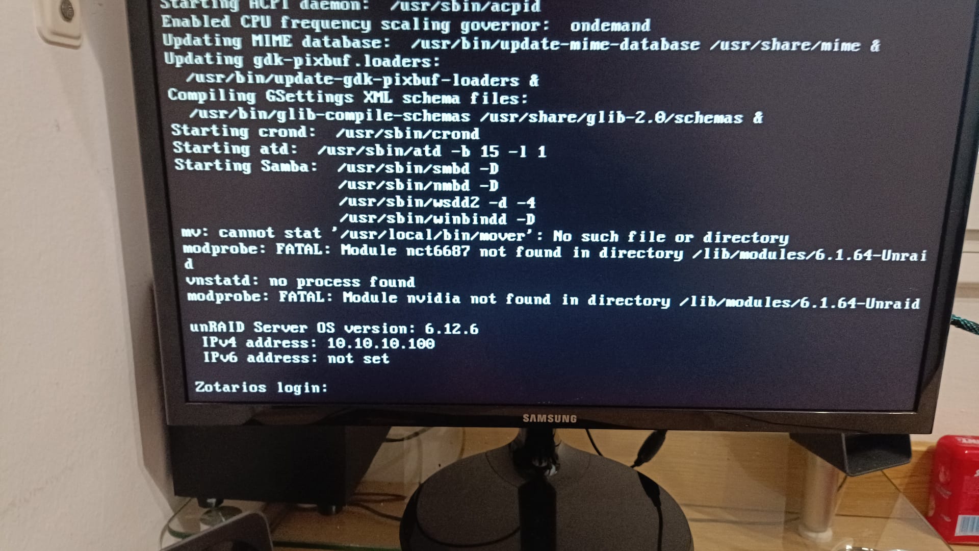

Hello there!
My flash drive died and I had to use one that I had spared at home. After flashing the backup stored on myunraid, I encountered a boot error displaying the following message:
1648037920_ImatgedeWhatsApp2024-02-05ales17_35.53_25208a26.jpg.8c7cbbb366529acf45899aff5b024e4b.thumb.jpg.ea75f7b2a2dffd3fb4bfd8d7304d8fa5.jpg
No changes at the server had been done since the backup and the drive fail and all the plugins/dockers are up to date.
Additionally, I observed a discrepancy in backup sizes. The myunraid backup was approximately 0.5GB, while a personal backup I created a month ago is around 1GB. I am considering trying the larger backup to see if it resolves the issue.
Tha Backup does not include the driver itslef.
Please uninstall the Nvidia Driver and also check if it is in the Plugins section in the Plugin Errors tab if it is then remove it, reboot, install the Nvidia Driver plugin from the CA App and reboot again.
Please do the above step by step.
I assume you don‘t have a active Internet connection on boot or no DNS server on boot because this happened.
Next time please include Diagnostics.
I wouldn't know how to do so, because the webui is not responsible. Maybe I can try to boot the server with the gui image?
Same problem... how could I get them?
