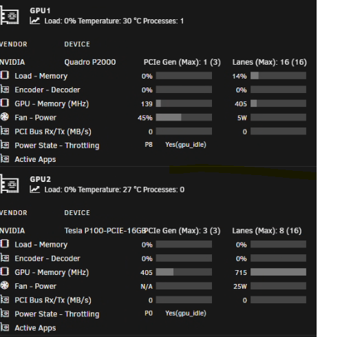

looking to add a tesla p100 to my unraid server. I have the data center driver. how would I go about compiling it for unraid? The prices if a p100 is low as of late just wanted to see if I could get it to work.
Edited by Kleinish888
added picture
What's the exact issue?
Is it the second card? It is working as far as I can see but without Diagnostics I can't say much.
I was looking to replace the p2000 in my server and use the p100 for transcoding on plex. With the current driver I get a driver crash likely because of the incompatibility with the card. I was figuring that if I compile the vgpu driver that I use on my proxmox server to work with unraid. I could use the p100 for this task
Can you please post your Diagnostics?
The Tesla P100 series should work.
I have no idea what is going on on your system.
here is the file. I have been doing some testing it seem to be working. however I am noticing when transcoding more then one 4K DoVi/HDR10 (HEVC Main 10) (hw). The movie will not load

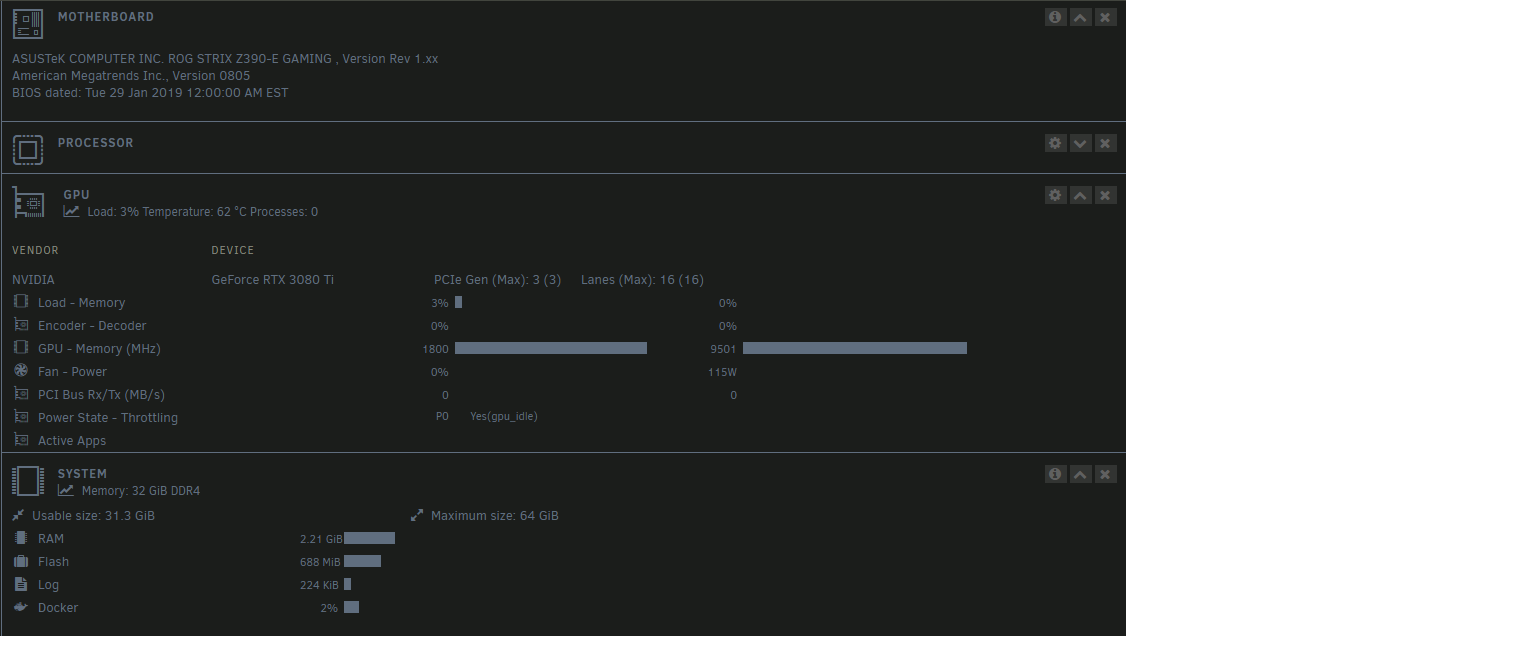

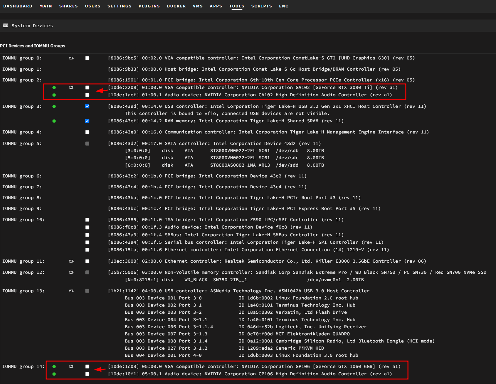

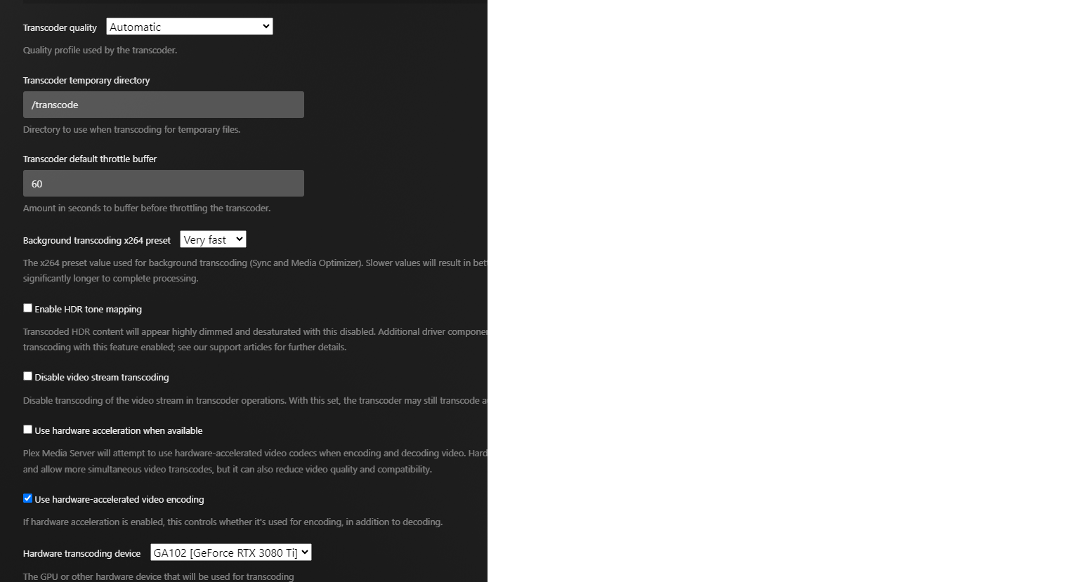

My 3080 Ti doesn't show up to use for docker. It allows it to passthrough to VMs, but GPU Statistics doesn't show any GPUs. I don't have any VMs running.
I already saw your posts in the GPU Statistics plugin support thread.
Does it work in your container or does it simply not show up?
As always without attached Diagnostics I can't help.
It doesn't show up or work inside containers
I spotted something in the logs. DM'd them to you ❤️
Sorry but you are still on 6.11.5, why?
Please upgrade to 6.12.6 and install the latest Nvidia drivers there since you are on driver version: 535.54.03 and the latest one is 550.40.07 (...no I won't compile the new drivers for such an old Unraid version).
However the problems you are experiencing can be caused because you are using it for a VM and Docker containers, it will of course work in most situations but not always.
Please upgrade to Unraid 6.12.6 and see if the issue persists.

Heya, I'm wondering what is your guidance on using this plugin with GPU being occasionally passed into a VM?
I couldn't find any information apart from don't download if you are planning to pass through to a VM, but I've read in other forum posts that I could pass it through to a VM when it's not being used by a docker container?
Plex can see my GPU right now, but I've selected the iGPU for transcoding.. does it mean it's also being used by docker and I can't pass it through to a VM?
Page 1 ... readme ... Post 1 the description and notes about VM Usage and Docker Usage ...
yes, thats correct
if you have a iGPU, then VFIO bind your Nvidia card so its gone from the Host ... then you have no issues passing your NV card to a VM while using the iGPU for transcoding.
thats the most common setup ... otherwise its always a "either or" ... Docker OR VM ... and can likelycrash your Server.
Yeah, so wha I'm trying to figure out is how do I go around the "will likely crash your server" - is it random or does that only happen if the GPU is being used elsewhere? binding to vfio is suboptimal because the GPU eats power all the time then.
exactly ... if another app tries to access the device while "in use" ...
your decision, if your Server crashes ou know why ;)
actually, i use it here like this with 2 VM's and my dGPU's are not bound to VFiO ... all Apps (Dockers) where only pointed to /dev/dri to use the iGPU and i personally had no issues, but you are warned and know why ... in case ... ;)
and i use nvidia-persistenced to keep them in sleep while not in use (VMs off, as far as it goes ...)

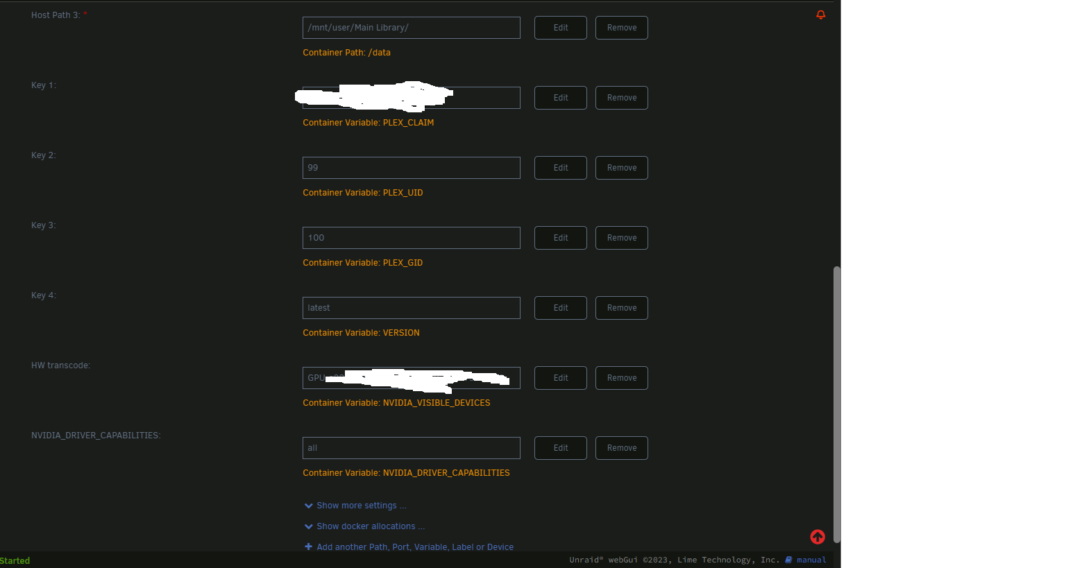

having an issue with my official plex docker unraid 6.12.6 nvidia driver installed and followed the instructions. plex shows the gpu but is not using it for transcoding. anything im doing wrong? i also cant update the nvidia drivers to a different version it says "nothing to do driver 535.146.02 already downloaded" not sure if thats effecting anything.
homel1-syslog-20240216-0458.zip
