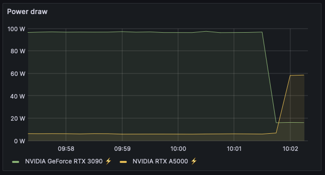

Is there a way I can re-prioritize the gpu order in nvidia-smi?
~# nvidia-smi
Mon Mar  4 07:50:18 2024
| NVIDIA-SMI 550.54.14              Driver Version: 550.54.14      CUDA Version: 12.4     |
| GPU  Name                 Persistence-M | Bus-Id          Disp.A | Volatile Uncorr. ECC |
| Fan  Temp   Perf          Pwr:Usage/Cap |           Memory-Usage | GPU-Util  Compute M. |
|                                         |                        |               MIG M. |
|   0  NVIDIA GeForce RTX 3090        On  |   00000000:01:00.0 Off |                  N/A |
|  0%   37C    P2             96W /  350W |    1164MiB /  24576MiB |      2%      Default |
|                                         |                        |                  N/A |
|   1  NVIDIA RTX A5000               On  |   00000000:82:00.0 Off |                  Off |
| 30%   33C    P8              6W /  230W |    2435MiB /  24564MiB |      0%      Default |
|                                         |                        |                  N/A |
What I am actually trying to do: I would like to use the A5000 before the 3090 for containers (but I want to be able to use the 3090 when I need to)
I am using this user script to bring power states down hourly, but what I really need is for my containers to prefer the A5000.
Right now I pass through NVIDIA_VISIBLE_DEVICES-ALL to each container, if I pass through a GUID list with the A5000 first would that impact priority?
Thanks for letting me pick your brains.
AFAIK no since it is tied to the bus number and therefore you would need to physically swap the cards on your motherboard.
Please don't use that script.
Simply put that in your go file:
nvidia-persistenced
As long as you don't use any of the two cards in a VM this will do the same and you only have to issue it once.
nvidia-persistenced
I removed the old user scripts. I also found weird behavior in the unraid frigate template, setting `NVIDIA_VISIBLE_DEVICES` is not respected by the image, but using `CUDA_VISIBLE_DEVICES` works as expected.
You should report that in the Frigate thread and not here since I don't know anything about the image and it not strictly speaking tied to the Nvidia Driver plugin if you have issues...
I even don't know what kind of workload that Frigate is putting on the cards and also what other variables are you using in the template.
It would be also beneficial if you include Diagnostics since I really can't tell what's going on on your server nor do I know what driver are you using and so on.

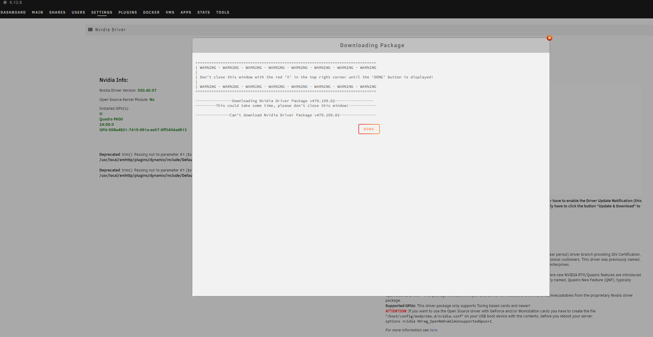

Something wrong with configuration? unable to update
Please remove the Nvidia Driver plugin, reboot, install it from the CA App and reboot or restart the Docker service.
What did you do? Did you upgrade your Unraid version or did the plugin notify you about a new driver update?
Many thanks for your reply.
No this happened by itself, it was a problem before the upgrade, I just wanted to get an answer on this.
If I do remove this, will the settings I made elsewhere (i dont remember where) will remain in tact? Just reinstall and everything should be back and running as before??
Please post your Diagnostics before doing all of that and also the file: /boot/config/plugins/nvidia-driver/settings.cfg
I assume you are referring to Docker containers?
Yes, the containers won't be able to start when the driver is removed after the first reboot, after the second restart you should be up and running again just fine.
May I ask why did you click the Download button in the first place? Was something not working or did you simply just try to change the driver?
