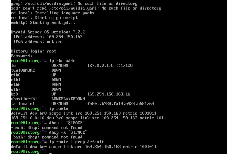

  2. I am unable to access the server after a power outage. The server seems to be setting an IP address that cannot be accessed. I have attached a screenshot here, I am baffled, i just looked up how to check network config. Any ideas on what could be the cause and if there are any commands I should run to set this back to normal?

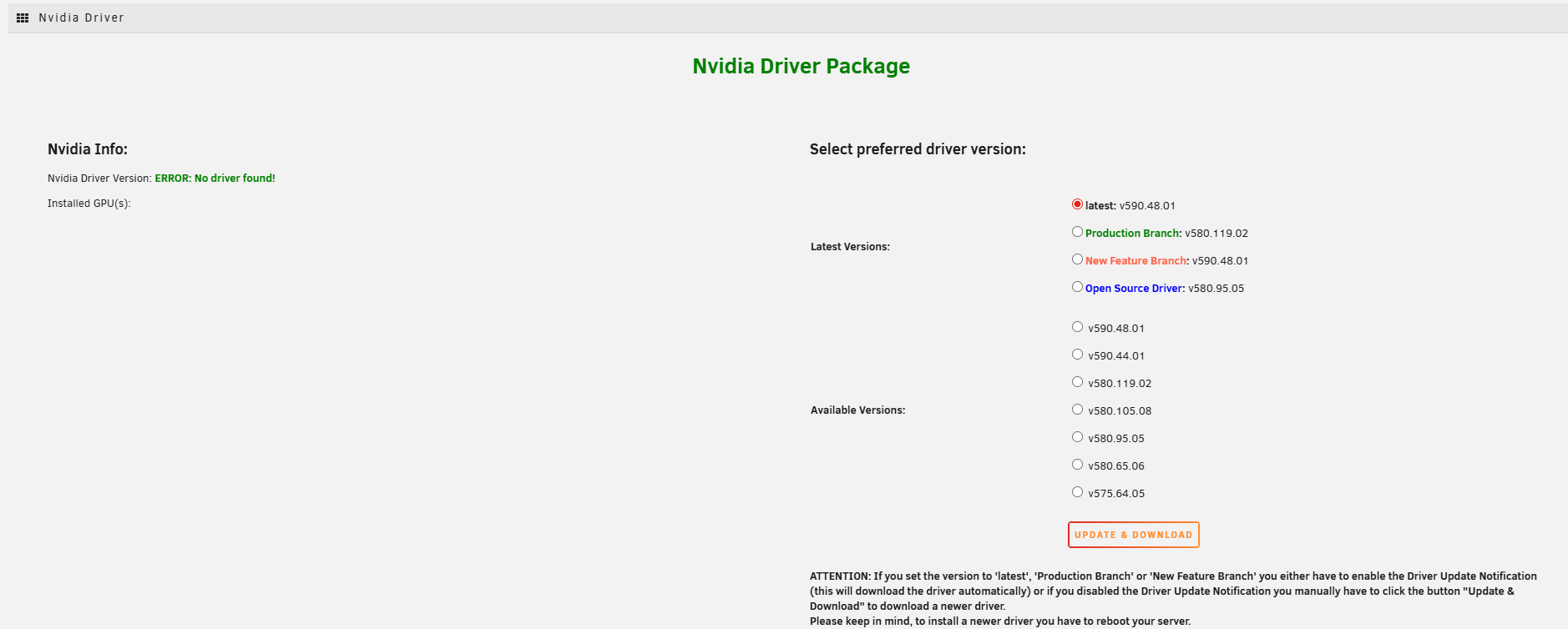

  3. Can anyone help with this? I can see this error However the GPU is available and is shown in the system devices. I am not sure how this can be fixed? Any help much appreciated. I tried downloading the 580 drivers but I get an error unable to download. I am stuck

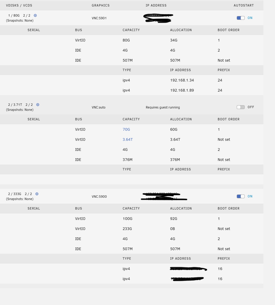

  4. Hi all In an effort to make my server more efficient and the cache running only for move tasks to array, I would like to move all of my VMs and Dockers to a new pool that I have created with a 2TB SSD. This should clear up my cache to just do cache tasks as it fills up very quickly and halts the system. By following some videos from Spaceinvader, I have been able to create a new SSD pool for VMS and Docker however I am unable to find a tutorial on how to move the VMs on to the new SSD pool that i have created. there seems to be nothing out there showing a step by step and I am not an expert with Unraid and fear messing things up royally. I think there are scripts to use for this purpose? I dont know how to do scripts yet Is there a step by step guide on how to do this? I am on 7.1.2. Second thing: I have created another pool with a 10TB drive to be used for Data for my VMs. I do not want to use the Array to store data from the VMs as the disks will continually be running. I would like to share the 10TB drive across about 3 VMs that will have a dedicated portion / partition of the 10TB drive. Like each vm will have about 3TB each to use from this 10TB drive. I would like to get a tutorial on how to do that also. Can someone help?
  5. I have checked the vdisk allocation on the VMs, they are maximum of 230GB however the cache is always filled up to 50% which is 500GB as it is a 1TB NVME drive. Trying to figure out what else the cache is using.

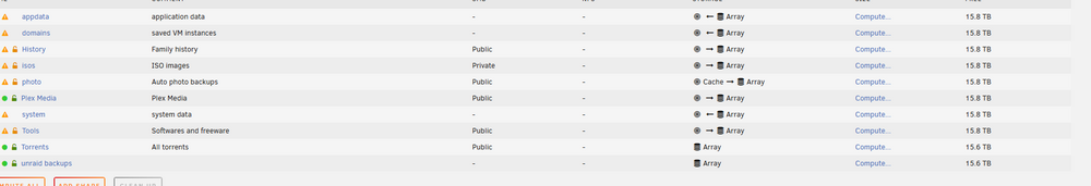

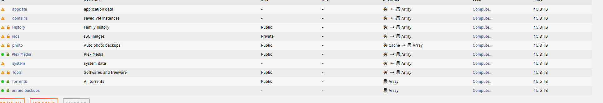

  8. Yes I understand that, however the CACHE--> ARRAY config Does that look ok for everything?

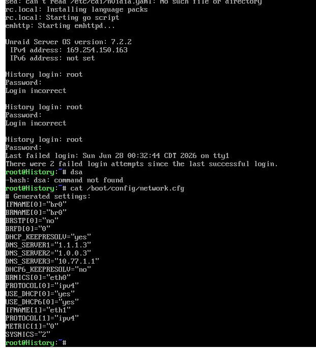

  9. Thank you for your reply. Would you like me to run this command on terminal? Perhaps this configuration is wrong?
