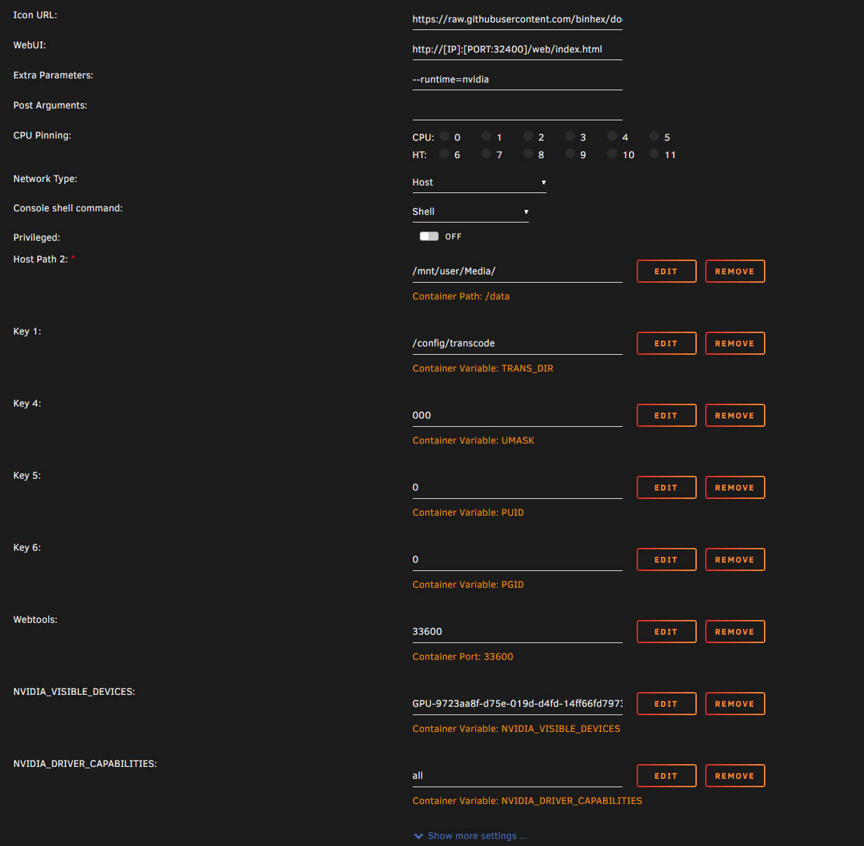

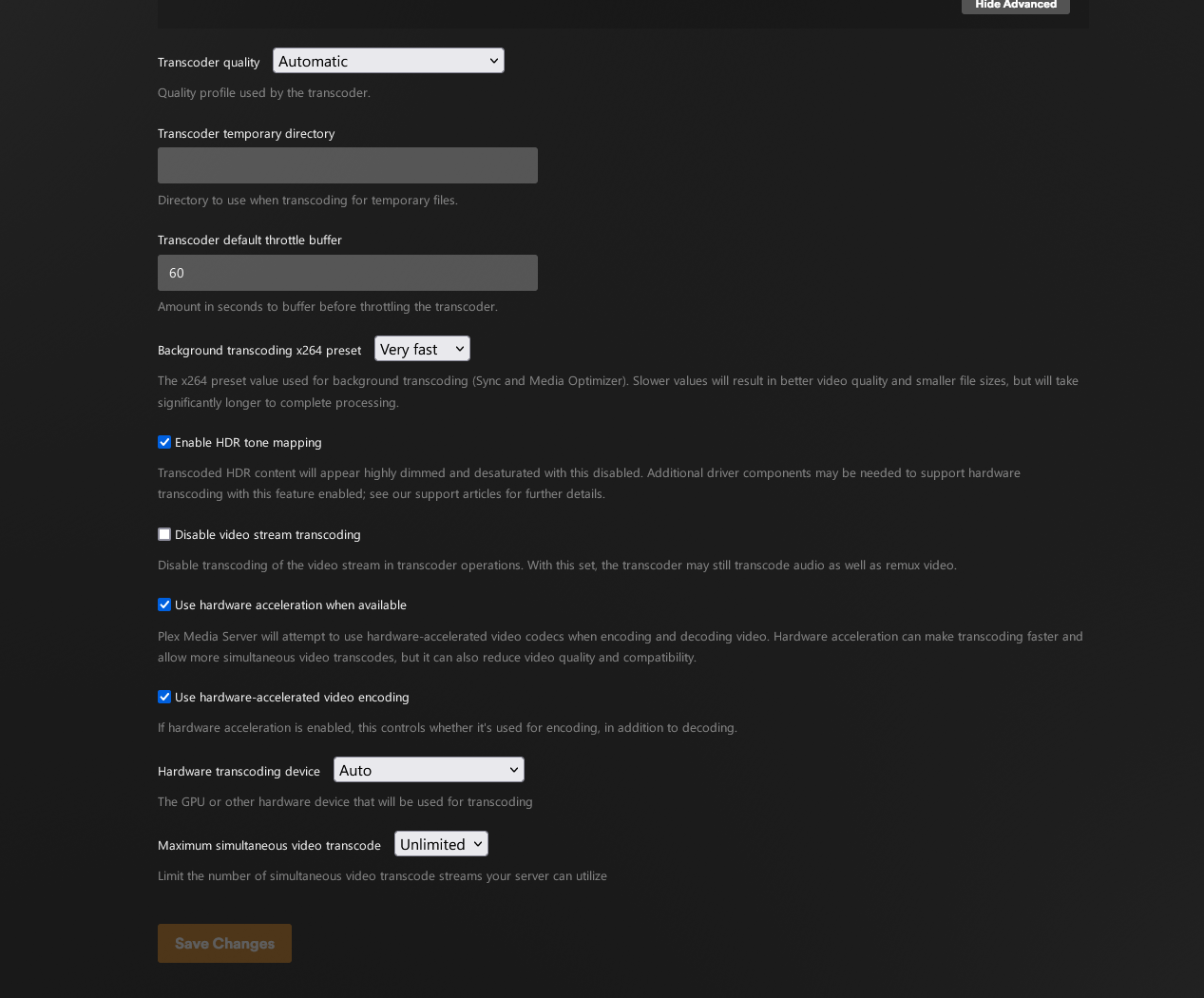

  6. Just installed a P400 Quadro to help out my old ryzen 1600 af with Plex transcoding. I set it up per the instructions, but every time I try to go into the nvidia-driver plugin settings, my entire server gui locks up and never recovers. I can't open the settings or get any other pages to load. I have to ssh in and reboot. I've attached my diagnostics. Any ideas what could be causing this issue? Plex docker settings: Transcoding settings inside plex: unraid-diagnostics-20240307-1746.zip
