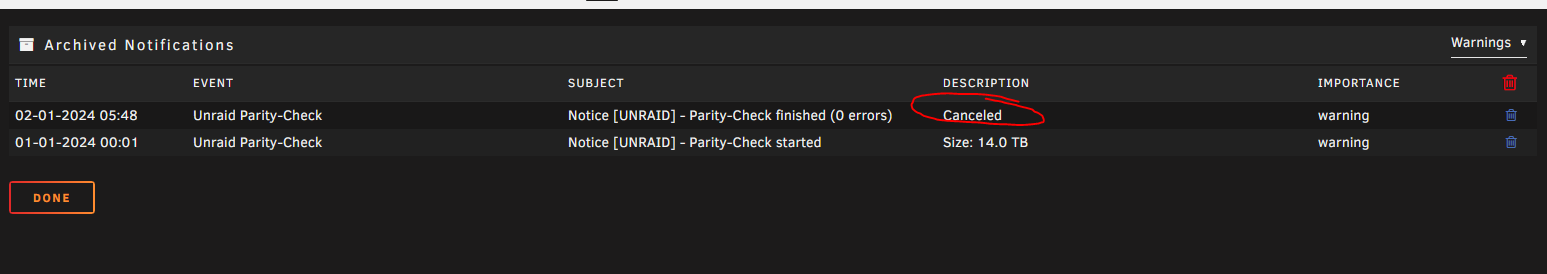

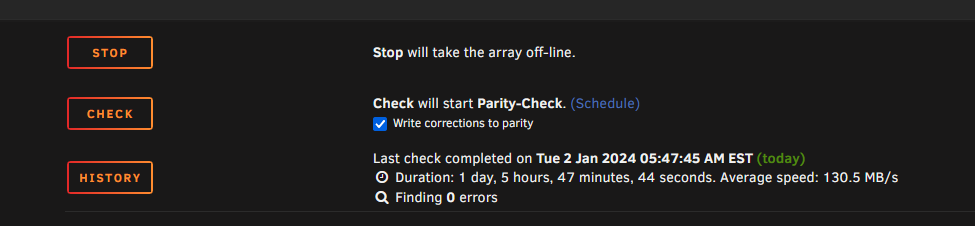

Notification that Parity Check was cancelled, but it shows finished in GUI.
Hello, I got a warning notification that the parity check was cancelled, but on the main page it says it was finished with zero errors. I have been having some issues with the server locking up, so the server is booted in safe mode right now to see if I can rule out any hardware issues. Could that be causing the error? unraid-diagnostics-20240102-0645.zip
