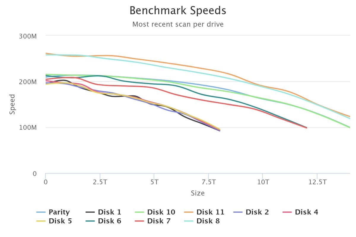

I have my Unraid Server with a 2.5G NIC and the Shield has a gigabit ethernet. I've run an iperf test and gotten 800Mb between both devices. I exported it and attached it below. I have benchmarked my drives and attached an image below. I've also attached my diagnostics.

Disk speeds look normal, I assume there's nothing else reading or writing to the array when that happens?
Yes, nothing else reading or writing to the array.
