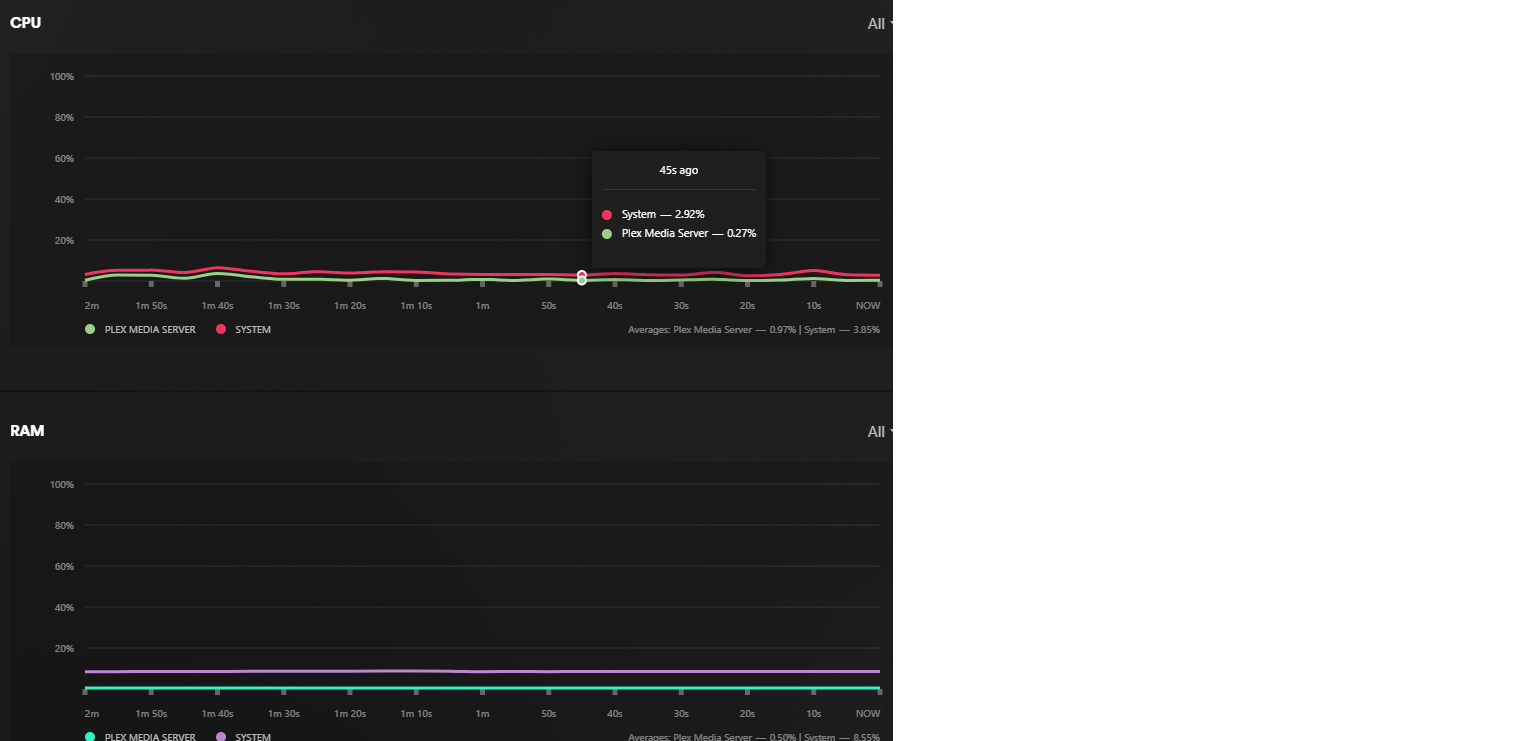

15 minutes ago, vedadechiee said:
plex shows the gpu but is not using it for transcoding. anything im doing wrong?
and you are sure the stream needs to be transcoded ?
like Browser playback ... what does the plex dashboard say ?
btw. syslog only is not really helpful, rather a diagnostics like always asked for.

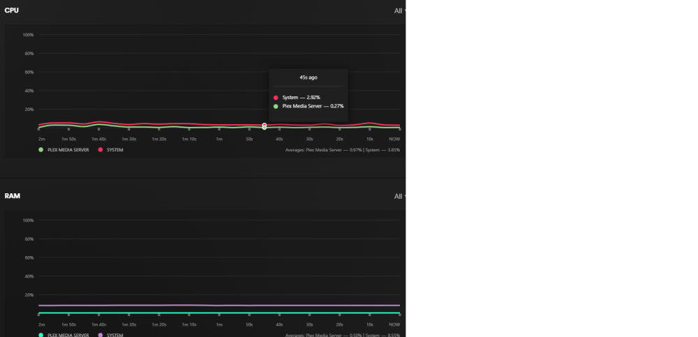

my bad ive only used unraid for 5 days so im a real greenhorn to server stuff. dashboard only show cpu and ram usage for 1 user. im upgrading cpu to a i9 9900ks. id like to start using unraid for more then a plex server. i have an extra evga 1080 would that be enough for 4 users? im thinking about using the 3080 for other projects.

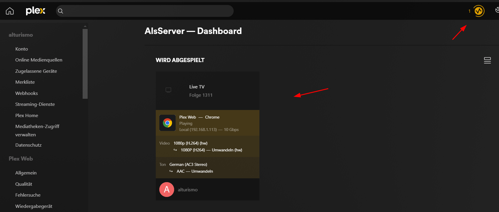

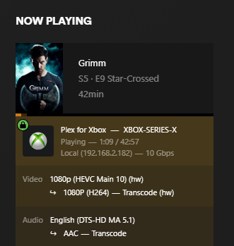

actually has nothing todo with Server or Unraid, your Dashboard while you have a Playback running ...
like this ...
if you are talking about transcodes, yes ... @home you should avoid transcoding and look forward for direct play, just as note ... makes no sence to transcode @home ... only remote to spare bandwith.

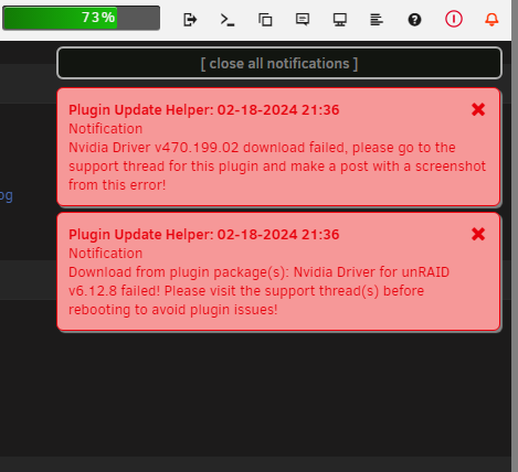

Issue with upgrading to v6.12.8.  I received this alert and not really sure what to do about it other than follow the instructions and post the screenshot..
Do you hve a AdBlocker or Unifi network hear on your network who are maybe blocking the GitHub API?
If you have a active internet connection on boot then it should be safe to reboot because the plugin will pull down the new driver on boot but please be aware that the boot can take a bit longer sonce it downloads the driver on boot (about 200MB).
Thanks.  No AdBlocker on my network and I'm not running any Unifi network equipment either.  I'm in the middle of transferring some files, but I'll give it a reboot and monitor it on my screen.  The box is connected directly to my Asus Router.  Here's hoping everything works out.  :)
If you got further issues feel free to create a new post, I'm here to help.

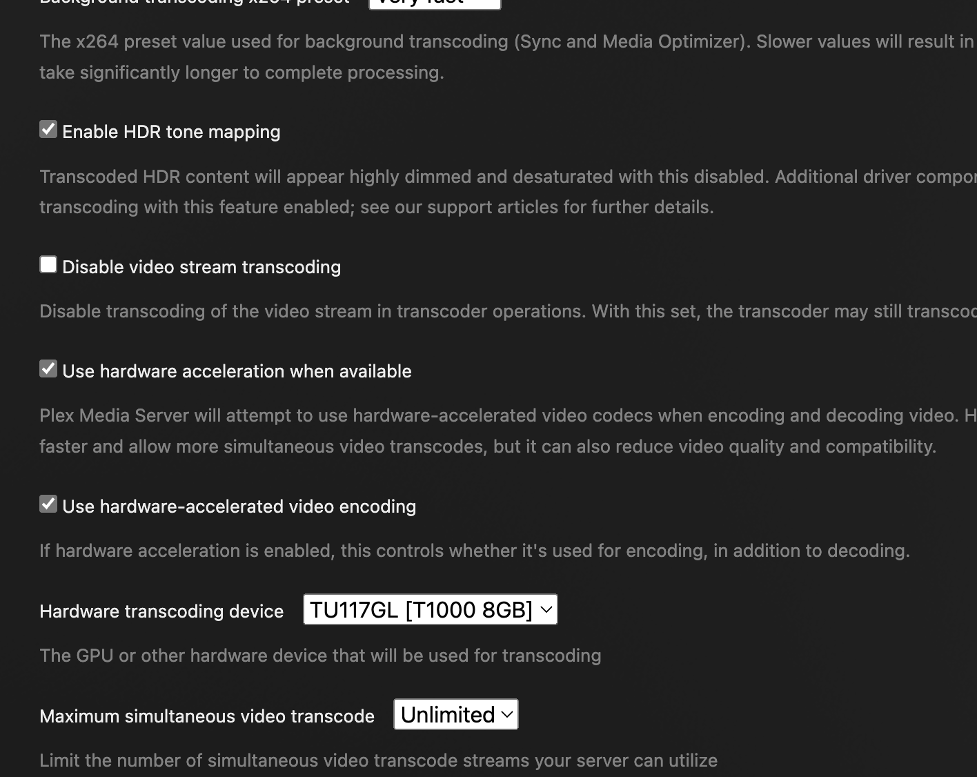

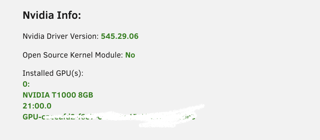

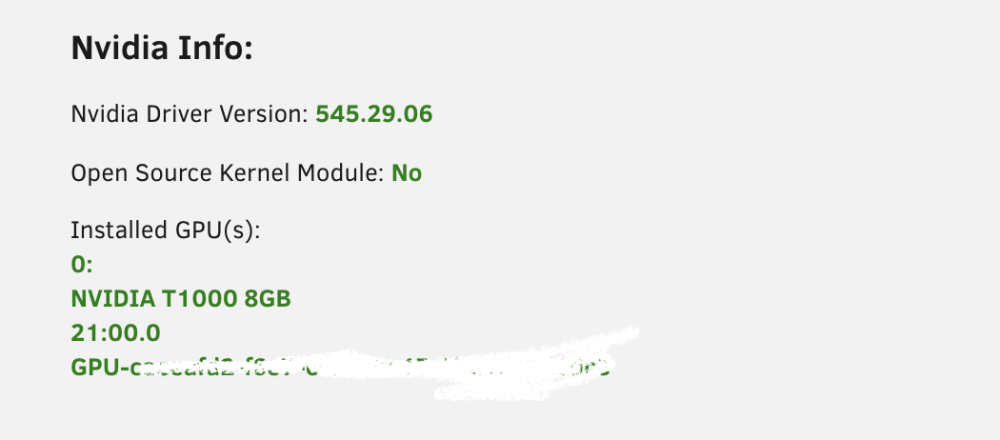

After the reboot I saw it downloading like you said.  However, when I go into Plex settings now I don't have the ability to select my video card for Hardware Transcoding.  It only gives me the option of Auto.

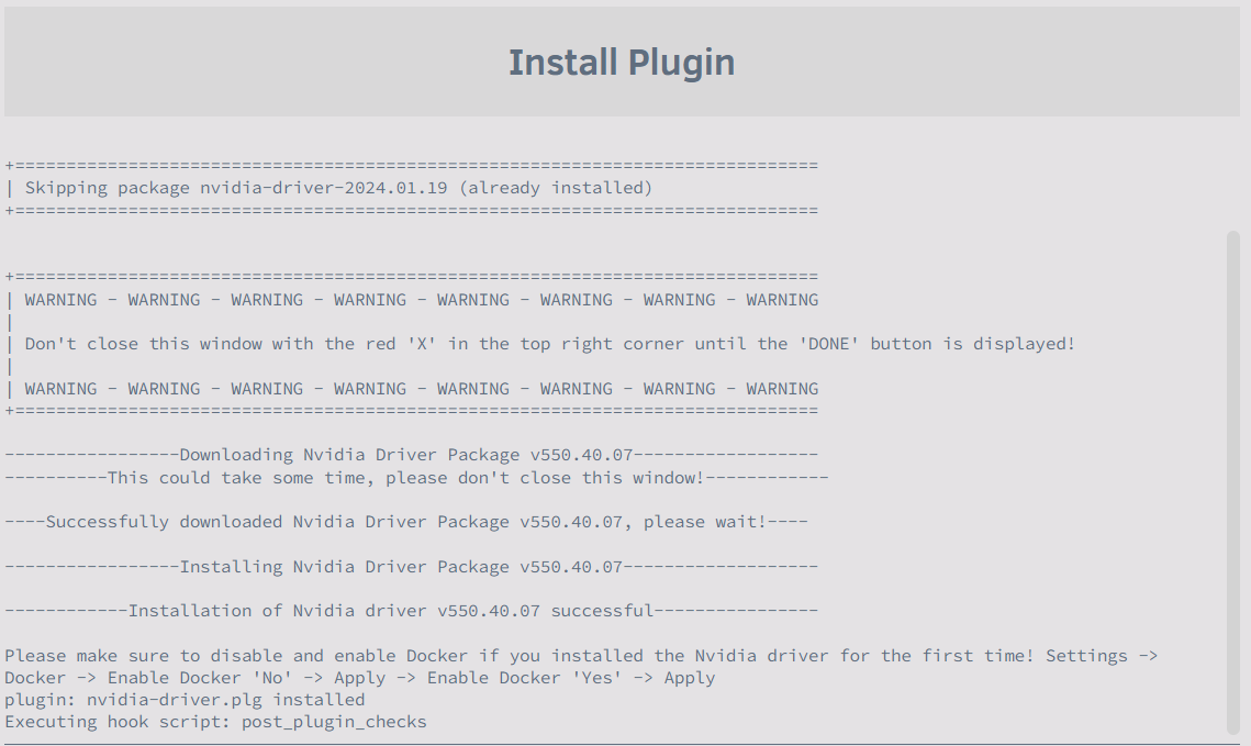

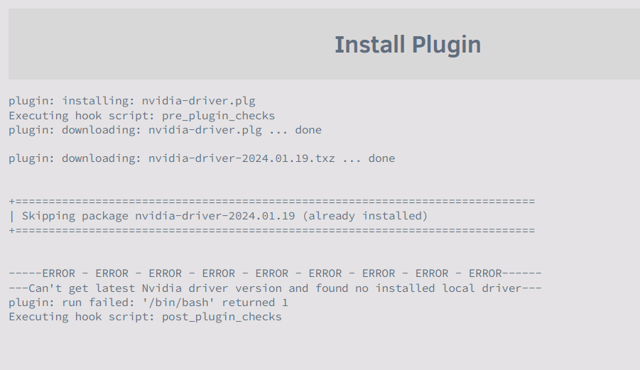

Hi ich777,
Thanks for your plugin and it help me a lot since 2021.
Today I update my server from 6.12.6 to 6.12.8, and found that the plug-in is down and unable to reinstall. Here I attached the screenshot of installation failure and my diagnosis zip.
Thanks in advance for your help, I am unable to trouble shoot by myself.
tower-diagnostics-20240219-1653.zip
May I ask where you are located in the world?
Did you wait while you where upgrading Unraid itself that your server said it is now safe to reboot?
Please go to your plugin page and see if you have a Plugin Error tab and if the Nvidia Driver plugin is in there.
Do you have any AdBlocking or Unifi network gear on your network somewhere?
Please open up a Unraid terminal, issue this command and post the output here:
wget -qO- https://api.github.com/repos/ich777/unraid-nvidia-driver/releases/tags/6.1.74-Unraid | jq -r '.assets[].name' | grep "nvidia" | grep -E -v '\.md5$' | sort -V | tail -1
Diagnostics or anything a bit more helpful. Is the plugin installed, does the card show up in the plugin? Very little information to troubleshoot.
Well, it looks like it is working so I think I'm fine.
image.png.7840be1681742d4a7e41b44f68b8cf7b.pngimage.png.64d47a7233cf22b135c5da9383fd2658.png
Thanks.  I was just updating while you were typing this.  Looks like it is working.
I am physically in Mainland China, my server is connected to global network through a HongKong VPN.
It shows nothing.
However, I switched my VPN to the USA and reinstall the plugin, it seems everything back to normal. I guess either there is something wrong with my Hongkong node or Hongkong internet itself.
5 minutes ago, timetheonce said:
It shows nothing.
Then your VPN also blocks the GitHub API, it should return:
nvidia-550.40.07-6.1.74-Unraid-1.txz
I've know already that China is problematic with the GitHub API some times but not always which is very strange.
Glad to hear that it is now working again.

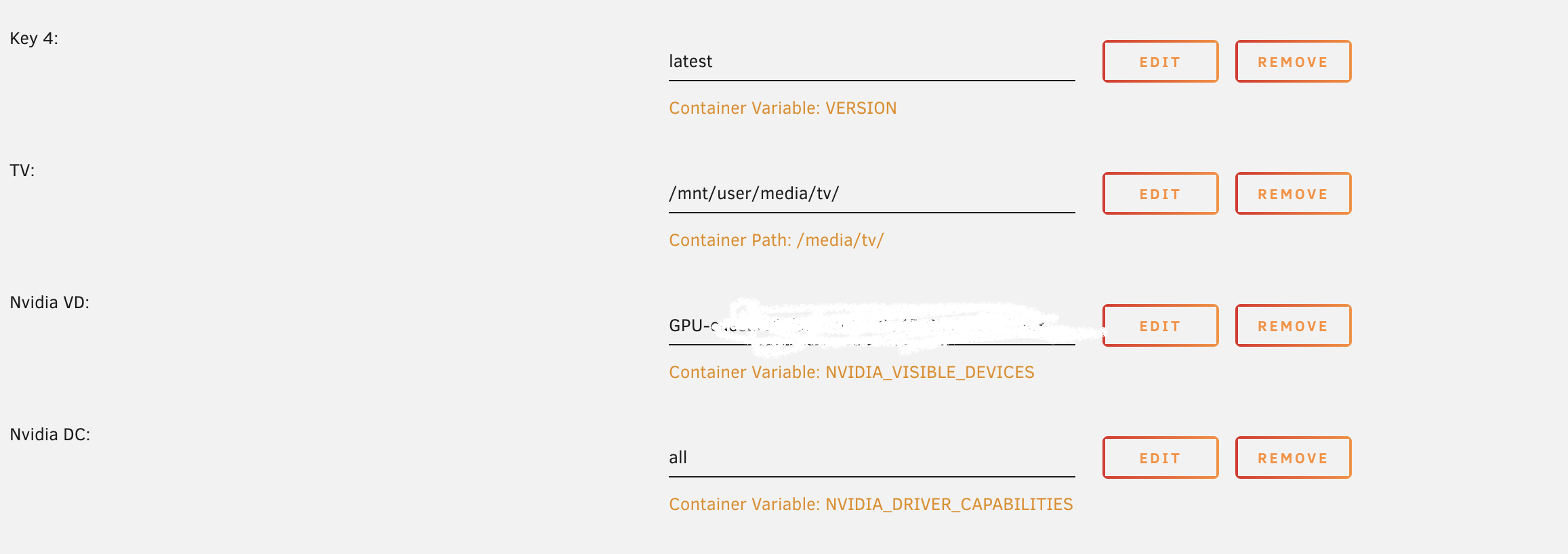

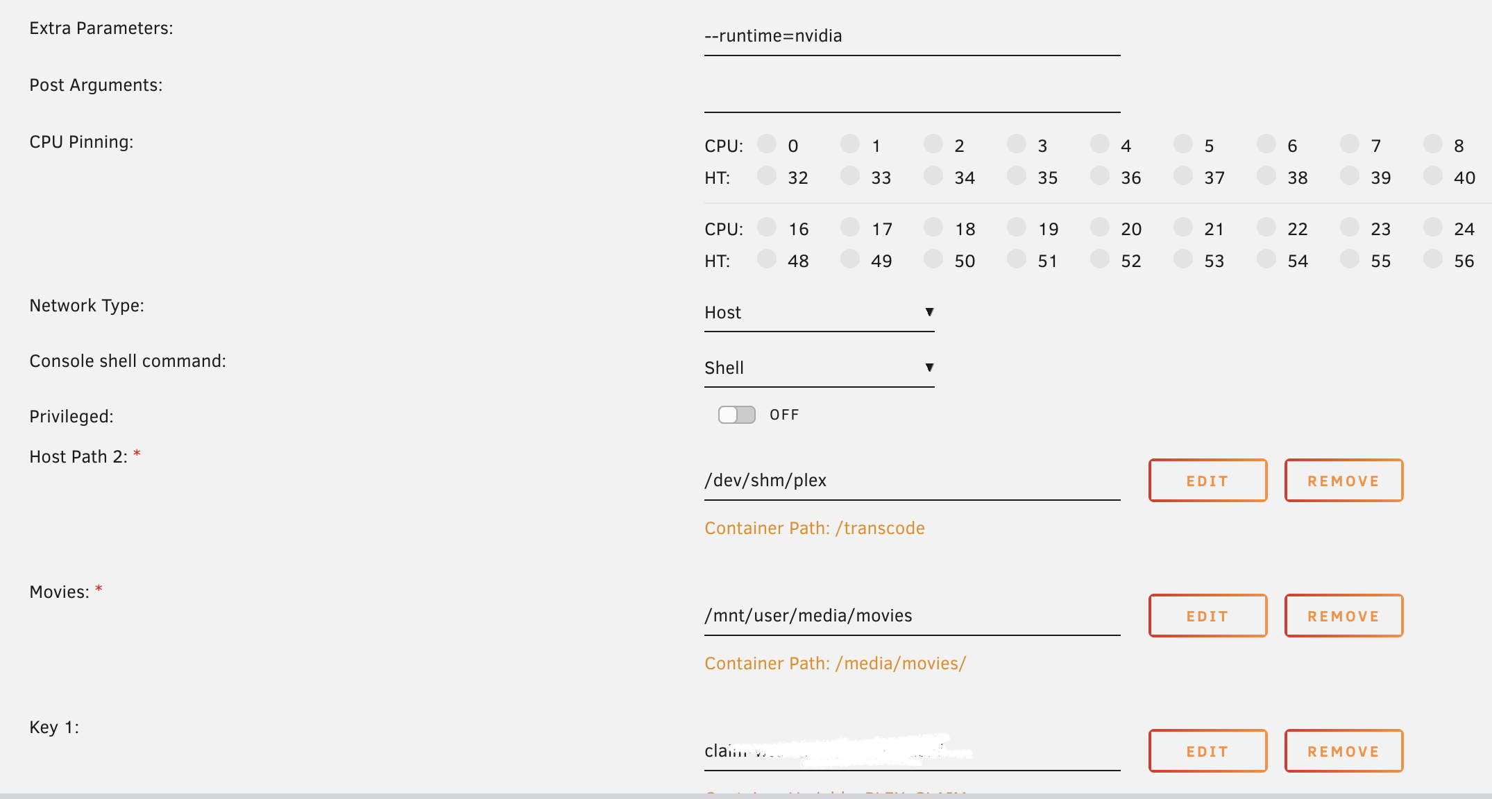

I just set plex up to transcode, but when I do it just gives me a black screen.. Nothing happens
If I revert back to direct play everything works fine
Not sure what i'm doing wrong
