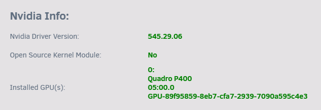

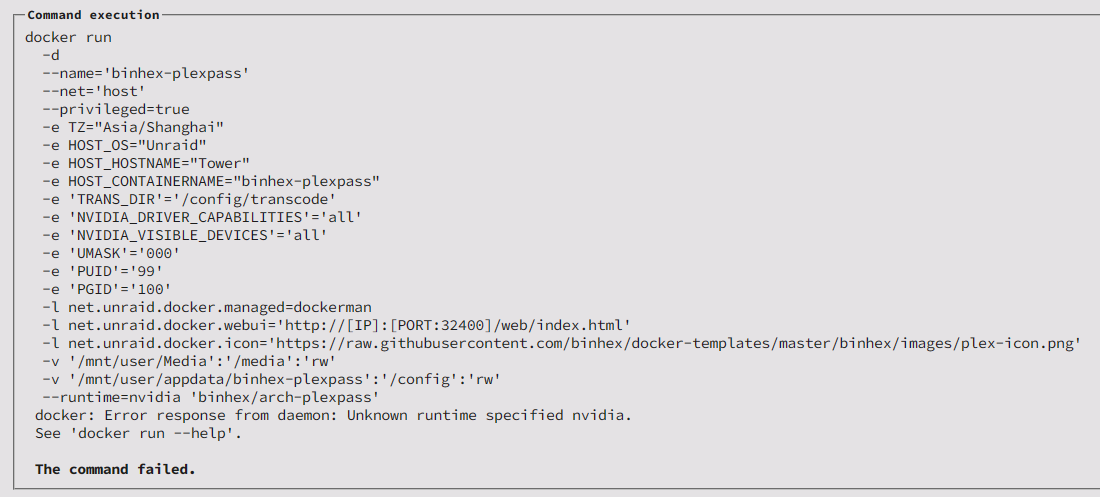

  6. Thanks for your rapid response, yes I rebooted my server several times, and restarted the docker service several times as well. I agree that the driver seems to be working fine, but I do reboot server/docker several times, and even more, I deleted the docker image, uninstall the nvidia driver plugin and do it over again step by step following the instruction. Problem still, unsolved. May it be a problem of docker service itself? Any idea I can get a clean/total reinstall of docker service?
  7. timetheonce changed their profile photo
