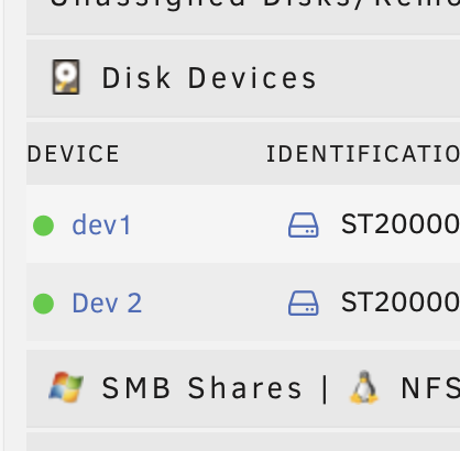

  1. Is this a plugin issue or an unraid issue? Is it even a bug, or just my ocd I'm on .18 and UD 2024.02.17, I just put in 2 drives to preclear.. Noticed the lower vs upper case - pre array start once the array is started, They both become uppercase like everything else

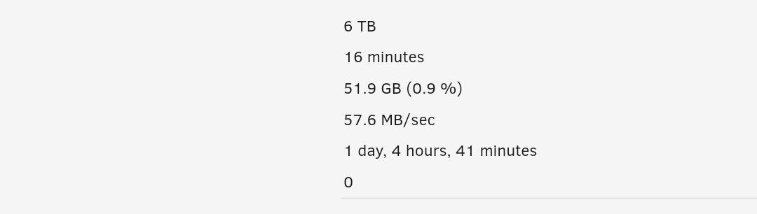

  10. Hello, Received a Dell R530 with onboard H730 Tested both BIOS and UEFI boot, Tested on Newest RC and Stable Card is set HBA, boot shows 8 Non-Raid Disk.. I can see Smart Etc.. Tested all Drives with Disk Speed = All drive performance is within a few MB/s at most Drives set to spin down - 15 Minutes XFS Now the issue... Parity Check... If drives are spun down - I start parity check... Drives will spin up, and parity check will begin... It maxes out at 60MB/s Per Drive Not normal performance.. If I cancel... and start it again same speed... even with drives spun up.. If I spin down drives... Then Spin UP - Star Parity Check I get Full performance 200MB/s etc.... I can repeat this endlessly, on both rc and stable. I was thinking of trying to set the raid card to spindown cards after 30mins of inactivity, but not sure if unraid will force them back up?? Disregard Disk Invalid in Diagnostics.. my parity hasn't synced tower-diagnostics-20220504-1658.zip
  11. I think you missed the original issue, the above is me spinning up the drives and starting.. it will do the parity scan at full speed "according to the benchmarks" for the full duration. On the other hand When unraid starts parity, when disk are spundown It won't hit over 60MB/s, 1min..40mins.. doesn't matter.. doesn't catch up.. doesn't slow down
  12. Total size:6 TB Elapsed time:44 minutes Current position:525 GB (8.8 %) Estimated speed:193.1 MB/sec Estimated finish:7 hours, 53 minutes Sync errors corrected: 0 Everything is 100% fine when I spin up drives
  13. First minute sure, not 16mins 26mins still same Stop parity, try again same Spin down, spin up
