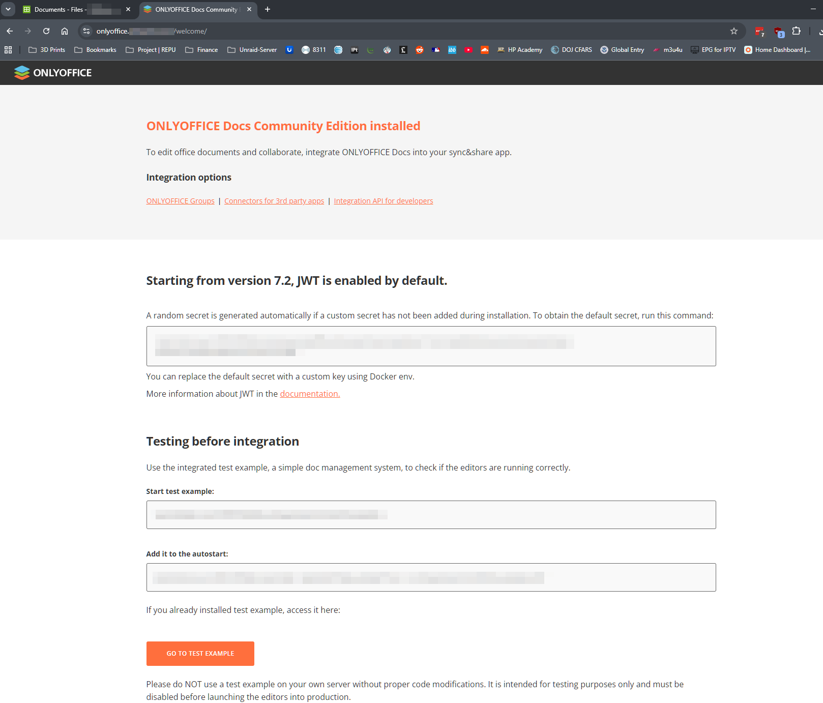

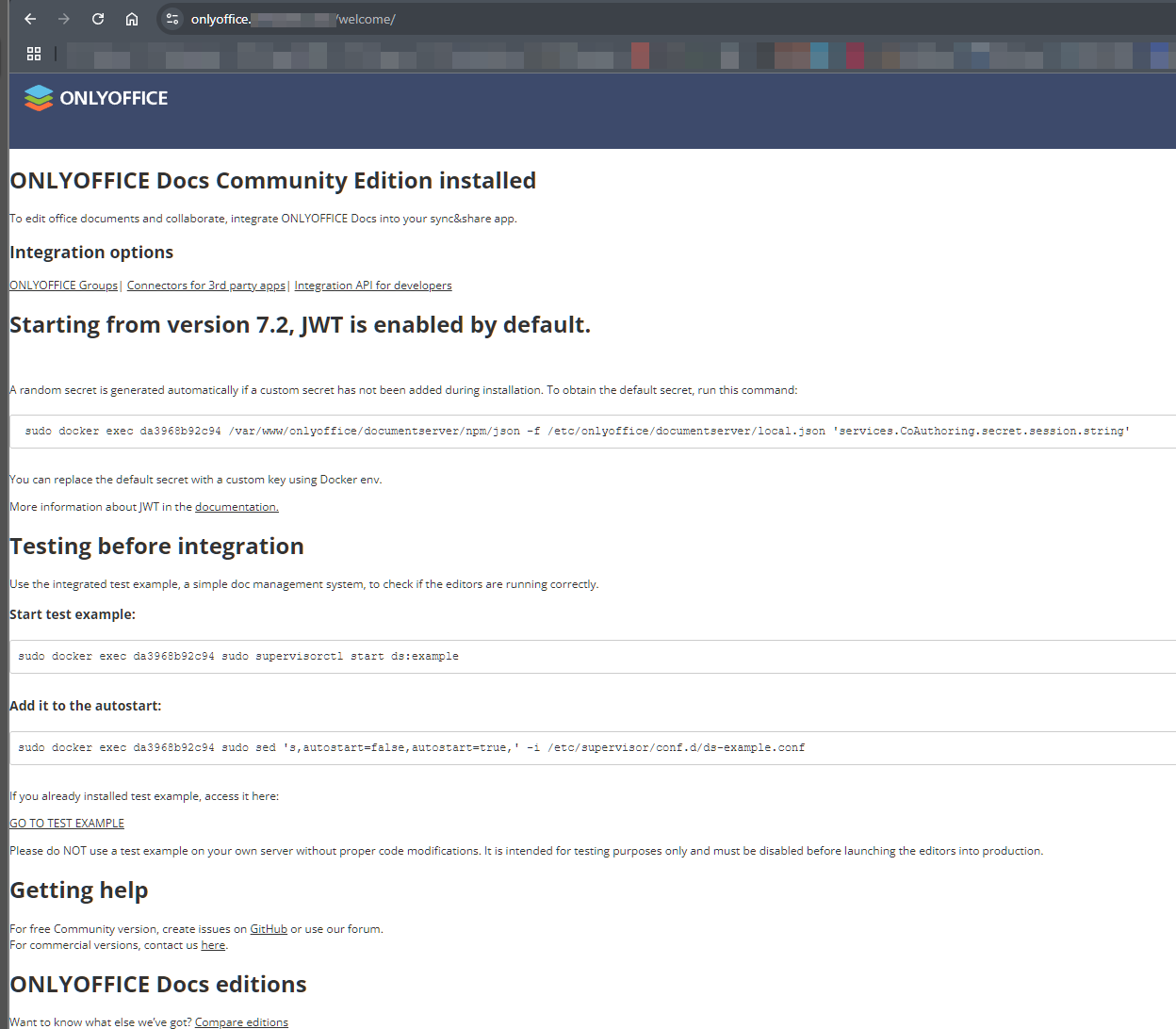

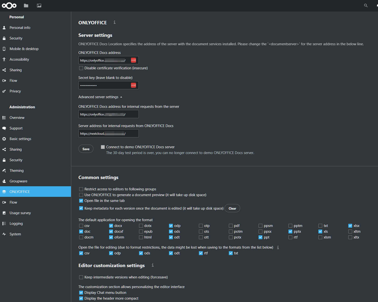

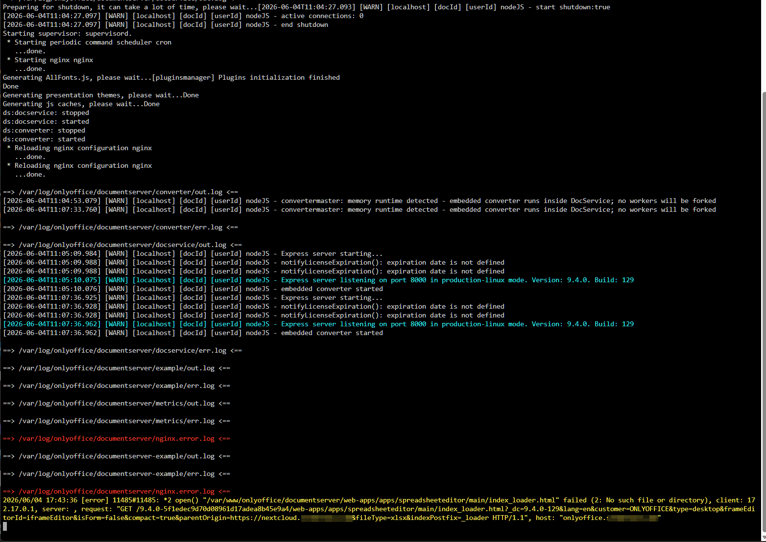

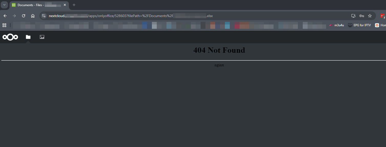

  2. Hey everyone, I am hoping someone can help me out. for some reason unbeknownst to me, OnlyOffice can no longer open any documents. I get a 404 Not Found Error The file itself is there, and I can download it successfully Onlyoffice web loads up just fine But I cannot open any office document in Nextcloud, the OnlyOffice settings are all correct. This was all working, and it just stopped. The logs for OnlyOffice show an error that says "No such file or directory" but as I said, I can download the file all day long and edited outside of nextcloud/onlyoffice and re-upload it which is what I have been doing. So I know the file is there. I did have my parity drive go offline because of a failure, I was able to replace it and get it rebuilt. But I don't know or understand how that would be causing this issue. All the other drives are working just fine, and nothing else on my server is broken. OnlyOffice is up to date, along with all the other dockers associated with Nextcloud. So if anyone has any suggestions on how to resolve this, I would be very grateful. As I said I've just been downloading my files, editing them, and re-uploading which is a pain.

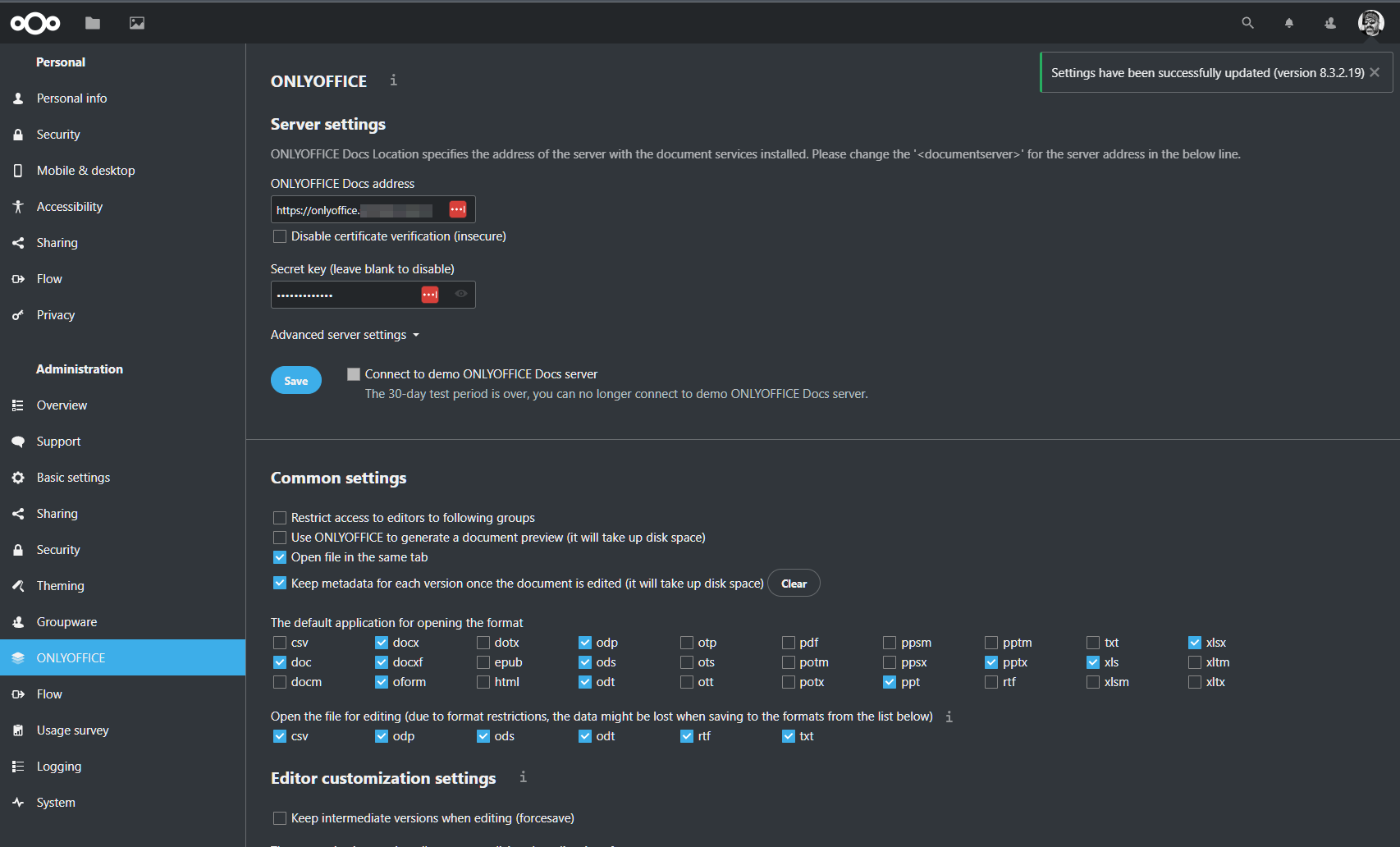

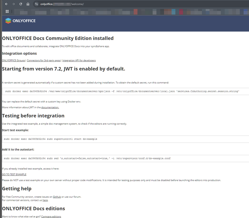

  5. This is still BROKEN! Even after the latest update. Can anyone help with this?????
  6. Hey everyone, I need some help, my onlyoffice in Nextcloud has stopped working. I recently updated my server to 7.0 and then 7.0.1. I noticed that my onlyoffice docker went missing. I re-installed OnlyOffice and was able to get it back up and running. I figured this is all I needed. But when I try to open any of my documents I get the following error in the upper right hand corner I figured maybe it just needed to be updated on the Nextcloud side of things. So I made sure the OnlyOffice connector was working And I made sure to check the app was up to date as well But like I said now it won't open any of my documents or create any new ones. When I try to create a new document I get the following error So if anyone has some insight on how to fix this it would be greatly appreciated. Not sure if I should have posted this on the Nextcloud thread but if I am in the wrong place can a Mod please move this to the correct location. Thank you!

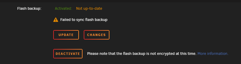

  8. So I did the steps mentioned above but I am still not able to get flash backup to work. Anyone have any other ideas on how to get this working???

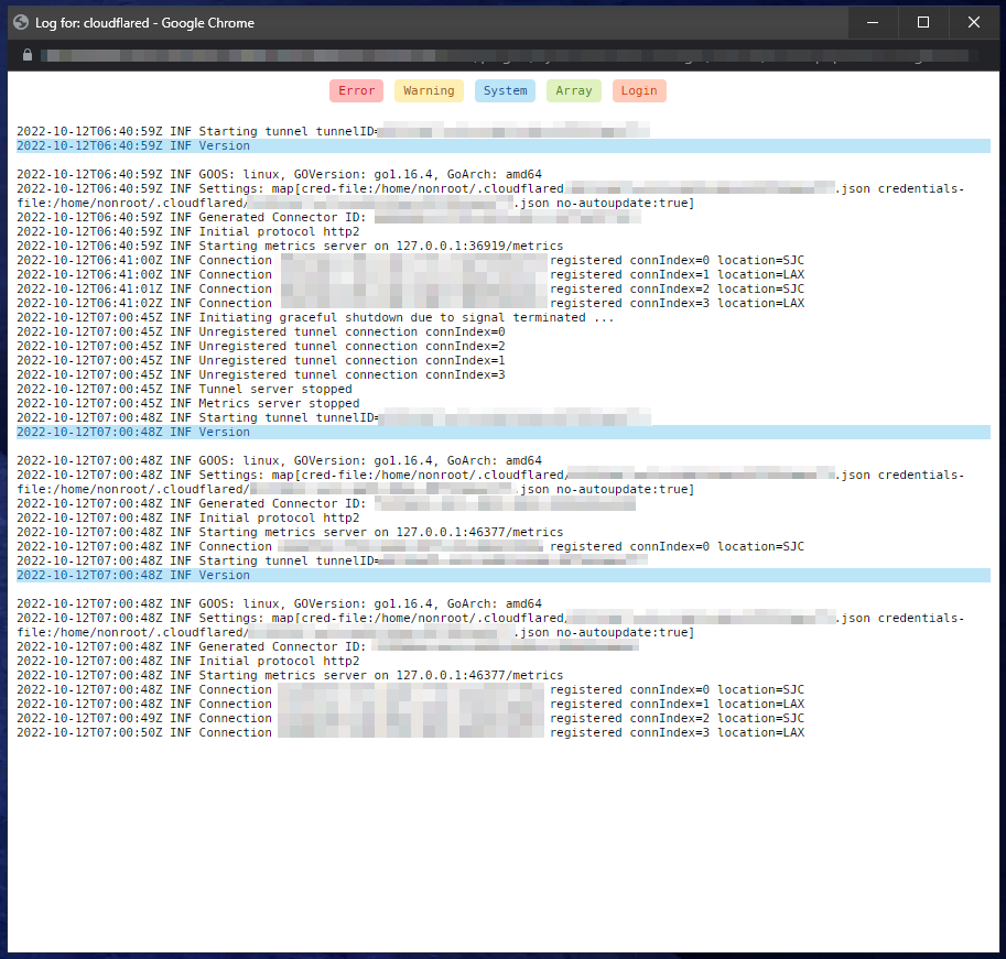

  13. Was able to figure this out last night ... turns out it was the Cloudflare tunnels that seem to be the ones having issues. 🙄

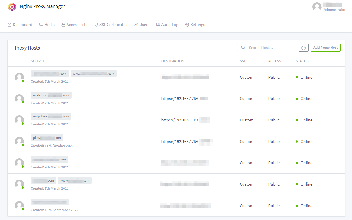

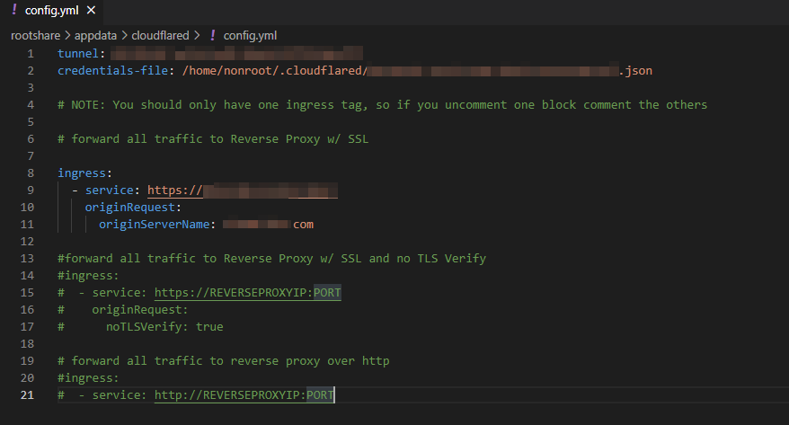

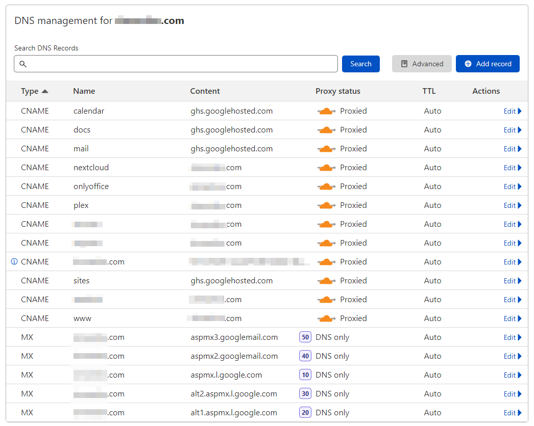

  14. Hello, Not sure what is going on with NPM, but as of today it no longer wants to work. I've had this running for over a year and have not had any issues until these past couple of days. I can no longer get ANY of my sites to connect, there are no errors in the logs for any of my dockers and they all work when accessed via the local web gui ... has anyone else been experiencing issue with NPM? Anyone know what I need to check to get this back up and running?
