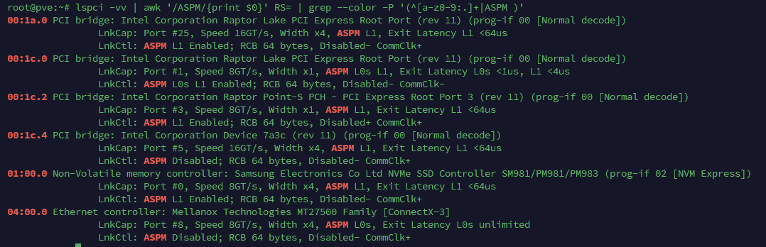

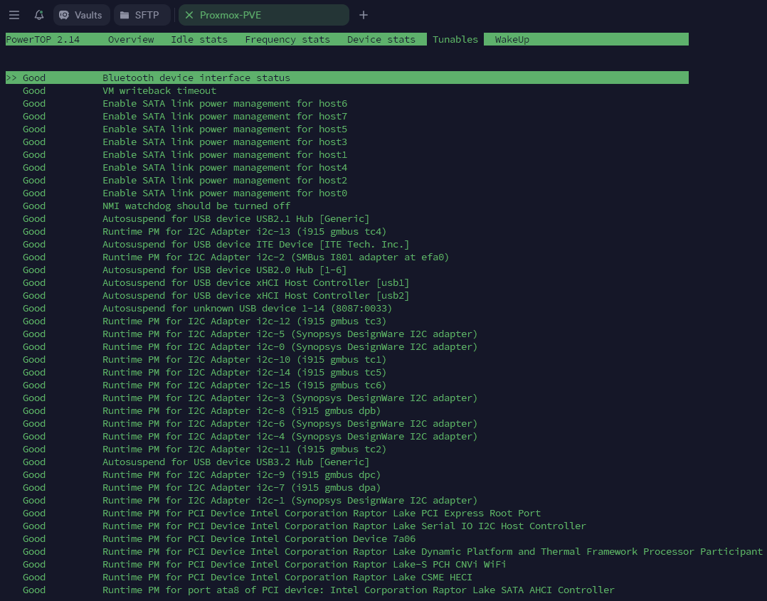

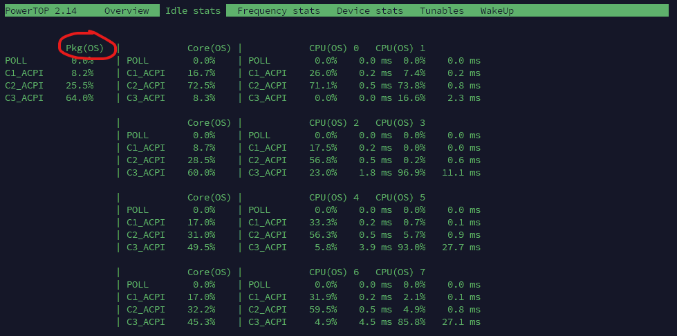

  1. Hey guy´s, i have a small problem with powertop and i thought my mainboard is the problem, because with a gigabyte Mainboard and TruenasScale it works well. But i´ve already change my Z690 Taichi to a Gigabyte b760 aorus elite ax and the Problem is still the same: I only get "Pckg OS instead of Pck HW" - is there a BIOS Setting i´m missing? Other Screenshot: Devices: The Mellanox card will be changed to a X710-DA2 - but what is the device 00:1c:4? Mainboard: Gigabyte b760 aorus elite ax Best regards Marc

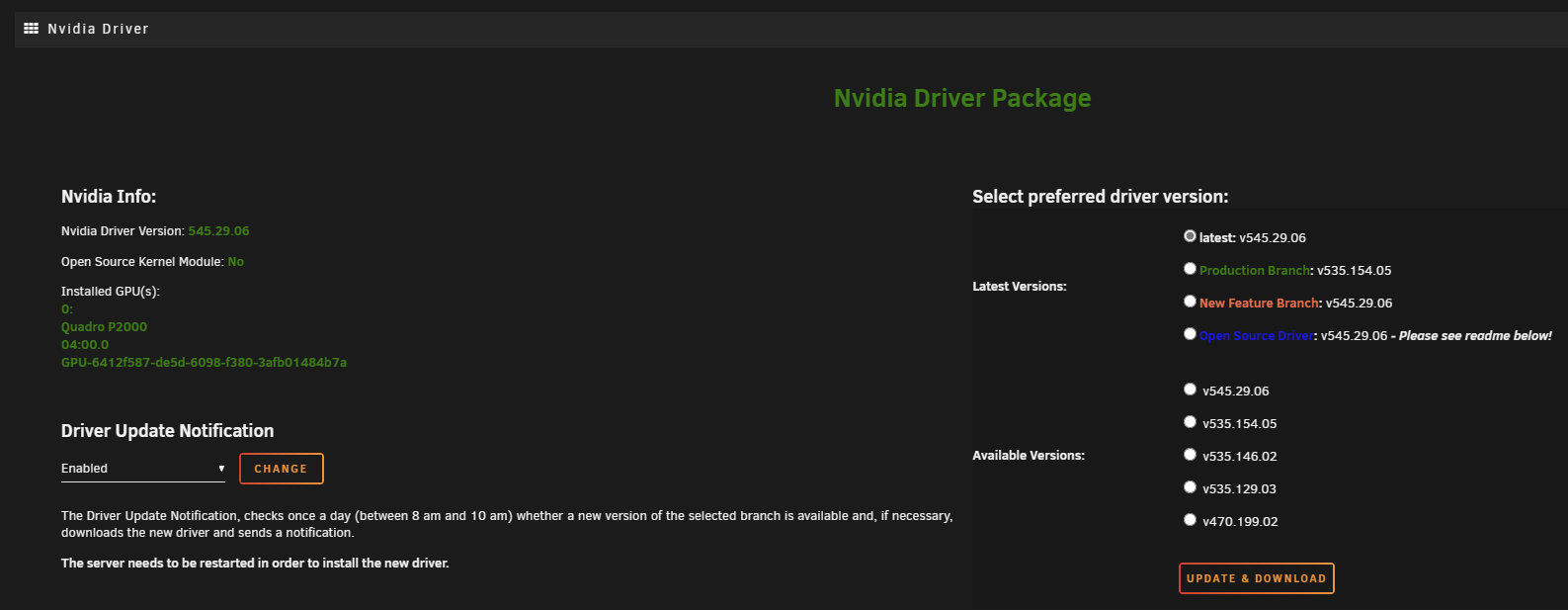

  4. Ok i did some research and it was the last thing i thought about. I´m using the R730xd with 2x750W PSU ,CPUs are 2x120W ,P40 250W, so i thought i´m fine with the 2x750W (i´ve also tried non redundant mode). After some research i found out, that Dell is limiting the GPU TDP to 150W (even if you use the 225W Riser) if you are using the 750W PSU. So my GTX 970 is working fine / P2000 is also working just fine. But the P40 doesnt work..... I´m trying to get 2x 1100W PSU´s now..... Yep i did use the Spaceinvader Script, i´ve deleted it now and put the nvidia-persistenced command in to the "go file" And yep i´m using your Driver for a long time So a little conlusion.....if my Dell server would give the p40 250W - it should work out of the box with the driver? 😮 😮
  5. 🥰Ok let´s try it Attatched the Diagnostics / Screenshot from the P40 in System Devices / Screenshot from your great driver with the working P2000 r730xd-diagnostics-20240120-2122.zip
  6. Hi guy´s, i think i fucked up. I´ve got a P40 for real cheap and i thought it would be a great card for Unraid - Docker - Stable Difuion / Comfy-UI. But i think it is not supported in the driver v545.29.06 Is there a way to get this to work in docker? My System Dell R730xd (no reBar Support - only above 4G SR-IOV etc.) 2x E5-2680 V4 128GB DDR ECC RAM A lot of SSD Storage With best regards Marc
