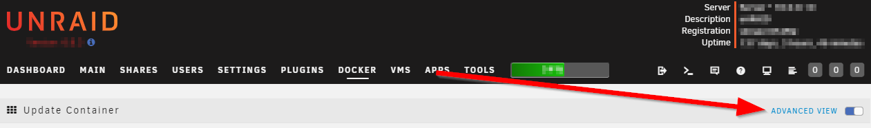

PLEASE READ: You must also set a static MAC address on this container!
AMP is designed to detect hardware changes and will de-activate all instances when something significant changes. This is to stop people from sharing pre-activated instances and bypassing the licencing server. One way of detecting changes is to look at the MAC address of the host's network card. A change here will de-activate instances.
By default, Docker assigns a new MAC address to a container every time it is restarted. Therefore, unless you want to painstakingly re-activate all your instances on every server reboot, you need to assign a permanent MAC address.
In order to do this on unRAID, please follow these steps.
1. Visit this page: https://miniwebtool.com/mac-address-generator/
2. Put 02:42:AC in as a prefix.
3. Choose to format with : colons
4. Generate a MAC address.
5. In the container template during install (or edit) please make sure the "advanced" toggle is on in the top right corner.
6. In the "Extra Paramters" enter your MAC address like this
--mac-address="02:42:AC:XX:XX:XX"
