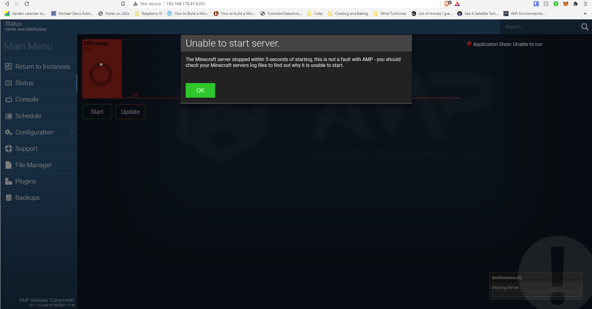

I may be having a too tired moment, but I have got this installed, and able to login with the webui. I am trying to run minecraft on it. When I try to even set up a vanilla world, making no changes to the config, I get the error of "minecraft stopped within 5 seconds of starting", and saying due to java.
I didn't change much in the install, just added my own password, mac address, and my license.
Am I missing something simple?

I recently added Java 16 to this image so maybe something went wrong. Thanks for the report! I will investigate.

I just created a brand new install and immediately created and started a Minecraft server without problems. Can you check the console for errors and also check what the Java section is showing you? Also are you using a normal AMP key or an old McMyAdmin key out of curiosity? (If you don't know then it's probably a normal key)

So java is showing as 11 (openjdk)[system default].
I am using an AMP key.
Have attached the screenshot of what comes up.
Here is the console output:

java.lang.RuntimeException: java.nio.file.FileSystemException: .: Operation not permitted
at cyg.<init>(SourceFile:98) ~[minecraft_server.jar:?]
at cyg.a(SourceFile:105) ~[minecraft_server.jar:?]
at net.minecraft.server.Main.main(SourceFile:117) [minecraft_server.jar:?]
Caused by: java.nio.file.FileSystemException: .: Operation not permitted
at sun.nio.fs.UnixException.translateToIOException(UnixException.java:100) ~[?:?]
at sun.nio.fs.UnixException.rethrowAsIOException(UnixException.java:111) ~[?:?]
at sun.nio.fs.UnixException.rethrowAsIOException(UnixException.java:116) ~[?:?]
at sun.nio.fs.UnixPath.toRealPath(UnixPath.java:860) ~[?:?]
at cyg.<init>(SourceFile:96) ~[minecraft_server.jar:?]
... 2 more
Edited by ptchernegovski
Have had a read back over the posts here again. Saw about changing permissions possibly in Krusader due to being denied access when go into the appdata from a Windows PC. I am being denied access when try that, but can't seem to change permissions from Krusader.
What would be the commands I need in command line to change it?
I don't know anything about Krusader but this line from your logs tells me Java doesn't have all the permissions it needs to run the server:
I'm not sure how it happened, maybe you're onto something with your Krusader research, but I would suggest restarting the Docker image/container. I have built in a startup script that fixes all file permissions on startup which may allow you to run the server.
Edited by MitchTalmadge
