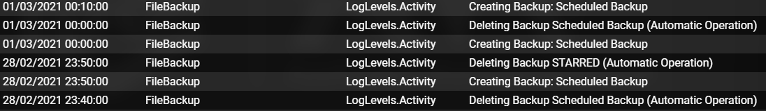

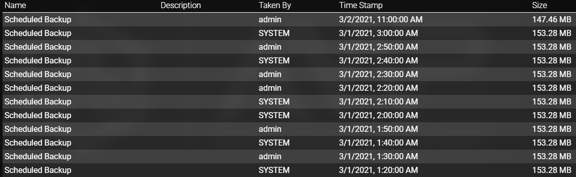

I really love the idea of sticky backups.
To test this, I created a trigger to run a backup every 10 minutes from within the Minecraft instance under "Schedule".
I limited the backups to 12 under "Configuration > Backup limits" (the size options were left extremely large so as not to be a factor)
I let the game run to create a couple of automatic backups
I created a manual backup called "STARRED" with a description, and Sticky = On.
Any ideas as to why my sticky backup is still getting deleted?
I would think it should keep it at the bottom, and cycle through the 11 remaining backups every 10 minutes.
Might it have something to do with some backups being created by "admin" and some by "SYSTEM"?
Edited by -Daedalus

So I honestly have no idea. I don't use sticky backups personally in my instances, but this is definately more of how AMP works rather than the docker. You might have better luck with questions on AMP itself over at their support forums.

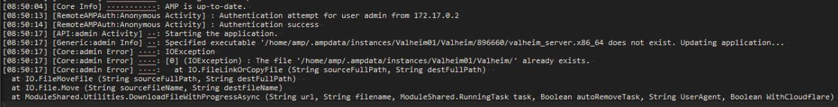

Im having some issues setting up an Valheim server. So i have tested to download a CS server that was working fine but i get the following error every time i try to start or make the server create it self. I have followed the guide and everything
The docker is running in bridged mode.
Any ideas what this might be caused by.

Yeah i thought so to but im not getting this issue on my other instance that i made before
this is the error Im seeing
Hmmm, it's saying the file/folder already exists. Have you tried making a new Valheim instance with a different name? This should change the name of the folder it ends up in. Worth a shot!
Otherise, you could try deleting the whole folder it references /instannces/Valheim01/Valheim/ and try re-starting it after that?

I just looked in the discord for this error and someone suggests stopping AMP, go to genericmodule.kvp (inside Valheim instance dir), edit it, and change
"UpdateSource":1,"UpdateSourceData":""
to
"UpdateSource":4,"UpdateSourceData":"896660"
Hopefully this works
Hey look at that it worked. I did as for help there earlier but since i was running it in unraid and i mentioned it i did not get any help so i stopped searching but normally i look around there for awnsers. So yeah the solution worked.
Thanks :D will make sure to look extra ;)

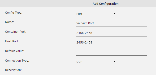

Is this how you add extra port for AMP? image.png.cfac2bc4f53a12a7ab13ed545ca41390.png
You can edit existing one, the example one there was for Minecraft.
If you want to run a different game, either edit that port or add a new one.
The best bet is actually going to be to create a NEW port listing.
At the bottom of the container template, you'll see "Add another Path, Port, Variable, Label or Device"
Click that, and then you can give it a name, and select a port (or port range), and be sure to pick if it's TCP or UDP as well, different games will be TCP and others will be UDP.
For simplicity, make the container port and host port the same (advanced users can change this if needed).

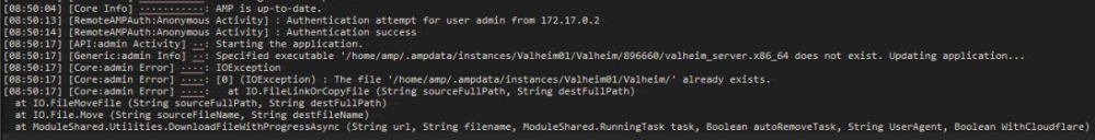

I'm having an issue though.
I'm trying to setup a Valheim server with the default ports 2456-2458 just to see if I even can get it to work.
I've added the MAC address into extra parameters, and forwarded the ports to AMP, and added the ports in the network configurations of AMP. The license was added without issues as well and I can see it being used in the license management on the website.
The server is not showing up. I headed over to the Discord and asked about it. As in the quote, they pointed me here. I did ask about the usage since I wasn't sure how to use it.
When I go into mange of the Valheim server, I'm getting this:
How do I proceed from here?

That's something CorneliousJD can't fix for you. It's an old AMP bug they even tell about on Discord. They normally would fix this for you in a second, but I guess you told 'em you're using the Docker application through Unraid.
Fix: Right click your instance > Browse Datastore > Edit the GenericModule.kvp > Change the matching 2 lines to those:
App.UpdateSource=Multi
App.UpdateSources=[{"UpdateStageName": "SteamCMD Download","UpdateSourcePlatform": "All", "UpdateSource": "SteamCMD", "UpdateSourceData": "896660"}]

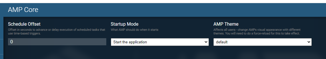

But I also got a question to you guys. Any clue why my instances don't start anymore after rebooting? I would guess it's something about the mac address parameter, but it doesn't matter if I use it or not, the instances won't start. They say they're started but turn offline as soon as I wanna manage 'em.
In settings - amp core, make sure startup mode is "start the application"
This actually causes it to start the instance AND startup the server.
Also make sure your instance itself is set to start on boot too.
