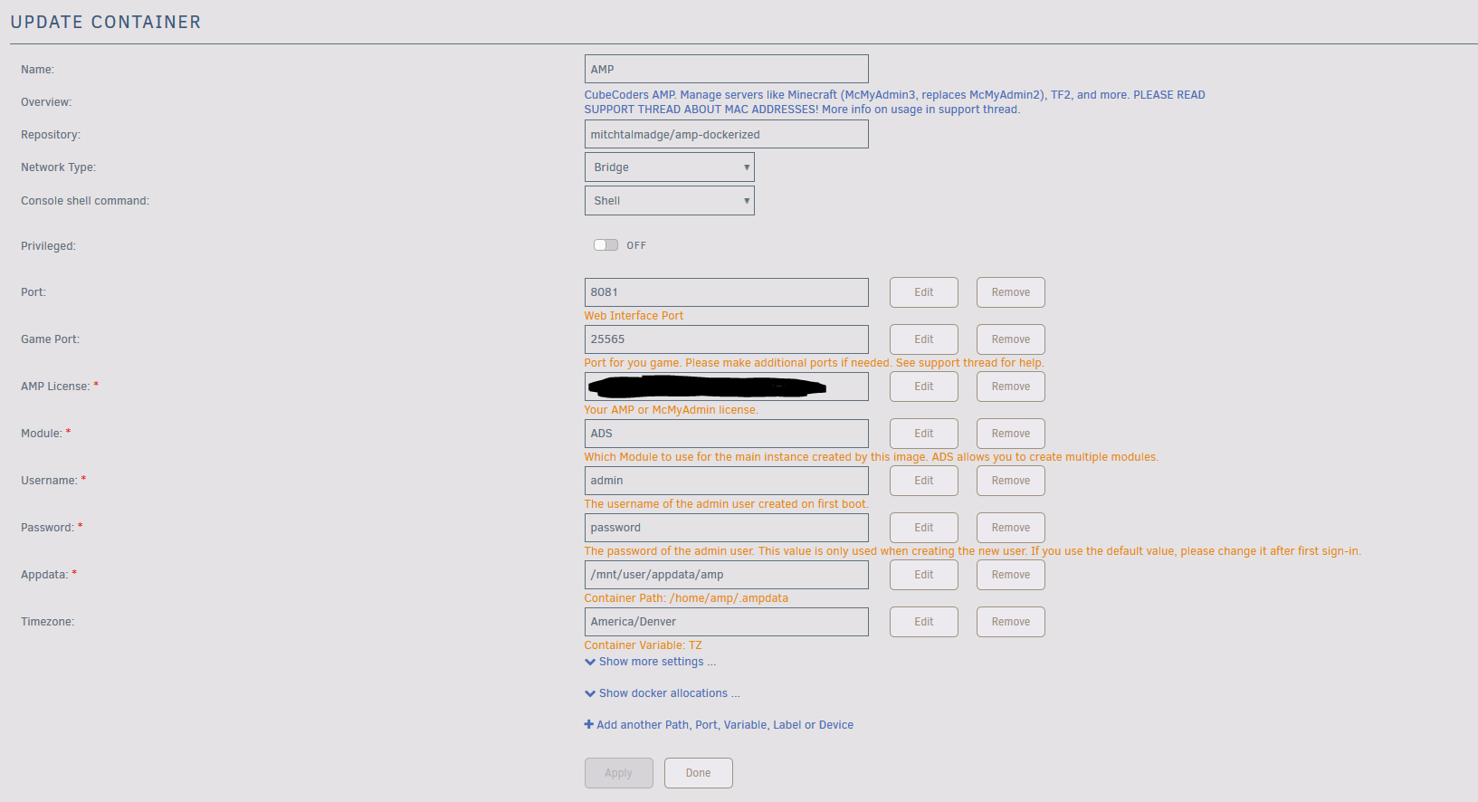

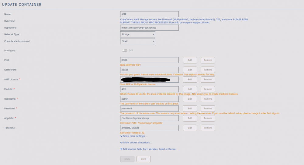

Adding another port. Under the Docker Setup for AMP, "Add another Path, Port, Variable, Label or Device" at the bottom, then I have to choose TCP or UDP. Defaults Java version is TCP, vs Bedrock is UDP (from github page). I believe @CorneliousJD was going to post some screenshots, but I didn't see any yet! So here's one...
I did notice on unRaid > Docker tab
172.17.0.4:25349/TCP192.168.11.53:25349
172.17.0.4:25565/TCP192.168.11.53:25348
So something about that isn't quite getting forwarded correctly.
Looks like it's listening on the right ports
root@rubble:~# lsof -i -P -n | grep LISTEN | grep 253
docker-pr  4314   root    4u  IPv6 745985546      0t0  TCP *:25348 (LISTEN)
docker-pr  4329   root    4u  IPv6 745990325      0t0  TCP *:25349 (LISTEN)
Tried changing host type, from Bridge to Host, got error
/usr/bin/docker: Error response from daemon: conflicting options: mac-address and the network mode.
The mac-address thing is important. I wonder why that was a problem.
Looks like you're doing it correctly in your screenshot, the TCP vs UDP just depends on the specific game and if it's using TCP vs UDP, so you'll have to pick accordingly based on the game.
In regards to the "Something about this isn't quite forwarding correctly" though I do not understand.
This is mathcing your screesnhot above perfectly.
What isn't forwarding correctly?

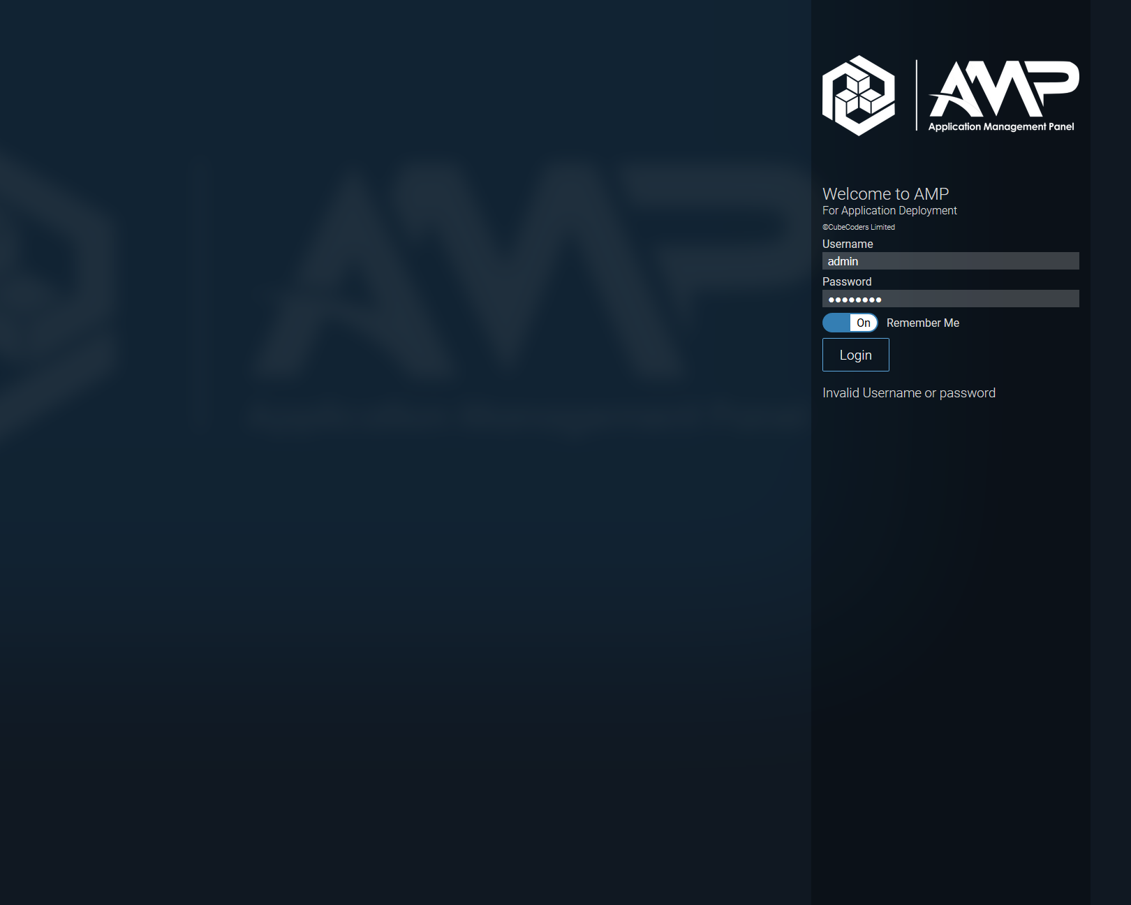

Trying to start a clean install of this with the default username and password and I continue to get "Invalid Username or password". Any tips on how to just login?
Weird, I've never had the defaults not work. Wild suggestion but check for trailing spaces on the username or password. Maybe one snuck in there. Alternatively try recreating the image. Sorry for the trouble, I'll do my best to help you get this working!
I'd also suggest just picking a different user and pass too and see if that works if Mitchs suggestion above doesn't.
Thanks y'all, I have ensured no spaces and have tried different username/password combos. Still won't let me log in. Definitely a weird issue that I'm not sure how to get around.
Edit: I've tried in Microsoft Edge and still the same problem. I've deleted the container and tried without changing anything other than adding the MAC Address and my license. Still giving me the same error.
Edited by J_Hizzal
EDIT: Solved the problem. For some reason, there were two "amp" folders in my AppData. Not sure how that second one got there (I did something to jack it up I'm 100% sure) but removing the container, deleting both folders, and then re-installing AMP solved my problem.

I have this setup on a custom network, with a static IP, if that makes any difference. (networking is not my strong suit).
Anything else I can check, or any ideas on where to look?
