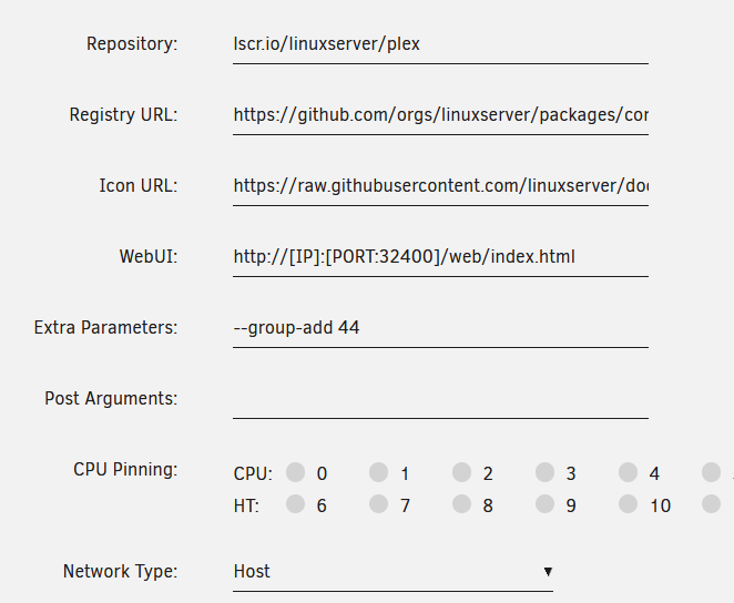

  13. AI pulled me through this one. For those of you who hate it (I almost do hate it!) Here's what I did to make it start working. I was coming from an nvidia gpu. When I pulled the card, Plex docker (lscr.io/linuxserver/plex) stopped working. I had to remove all the custom entries I'd put in years ago for that nvidia card - including a --runtime=nvidia thing that was behind the Advanced toggle. AI wanted me to change my Network from Host to Bridge. That broke port forwarding and I couldn't connect to my Plex server, so I changed that back to Host. I had to add two Devices to the docker template. Add another Path, Port, Variable, Label or Device Select Device Name: /dev/dri/card0 Value: /dev/dri/card0 If you want to make sure these things are present, like I did, you can run: root@mayorgoodway:~# ls -la /dev/dri total 0 drwxrwxrwx 3 root root 100 Oct 1 03:42 ./ drwxr-xr-x 17 root root 4080 Oct 1 10:46 ../ drwxrwxrwx 2 root root 80 Oct 1 03:42 by-path/ crw-rw---- 1 root video 226, 0 Oct 1 10:44 card0 crwxrwxrwx 1 root video 226, 128 Oct 1 03:42 renderD128 root@mayorgoodway:~#(formatting blah) (formatting blah) (formatting blah) I did add this into Extra-parameters "--group-add 44". This is what AI said about it: C. Add the video Group Access Docker containers often need to be part of the correct host group to access the GPU device nodes. Since your ls -la output shows the devices belong to the video group, you must grant the Plex container access to this group. AI asked me to double check I had some boxes ticked in the Plex settings. They were already checked because of the previous nvidia stuff I had in there. They were: Go to Settings (wrench icon) → Transcoder. Check the box for "Use hardware acceleration when available". Check the box for "Use hardware-accelerated video encoding". Click Save Changes. I put on a South Park, forced it to transcode, and badda bing: (HW) showed up and I could see the card doing it's thing. Doing it's thing. I optionally installed a Community Apps > "Intel-GPU-TOP; ich777" This added a command line interface program called intel_gpu_top. That was slick for watching the card do it's thing. it cal also give you a list of your available devices. Here's mine root@mayorgoodway:~# intel_gpu_top -L card0 Intel Dg2 (Gen12) pci:vendor=8086,device=56A6,card=0 └─renderD128 root@mayorgoodway:~# So anyhow, no really biggie. Ah another slightly unrelated thing. I have a PiKVM v3 Pre-assembled to help manage this headless server. Because my CPU has no onboard GPU, the HDMI on my motherboard is dead. When I put the new Sparkle Intel Arc A310 ECO in there, and it detected there was no monitor attached: no POST/boot. I had to swipe the monitor mouse and keyboard from my gaming rig to get the unraid server to BOOT. I ordered one of those dummy HDMI things. I also posted over at pishop.com forums about WTH. I'll probably end up buying the V4 of the PiKVM so I can still remote access this puppy.
