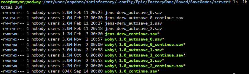

Satisfactory save games. I had a helluva time finding them! They're in /mnt/user/appdata/satisfactory/.config/Epic/FactoryGame/Saved/SaveGames/server It was the DOTconfig/ that got me. Doesn't show up unless you do an ls -a, otherwise stuff preceeded with a period is hidden.
