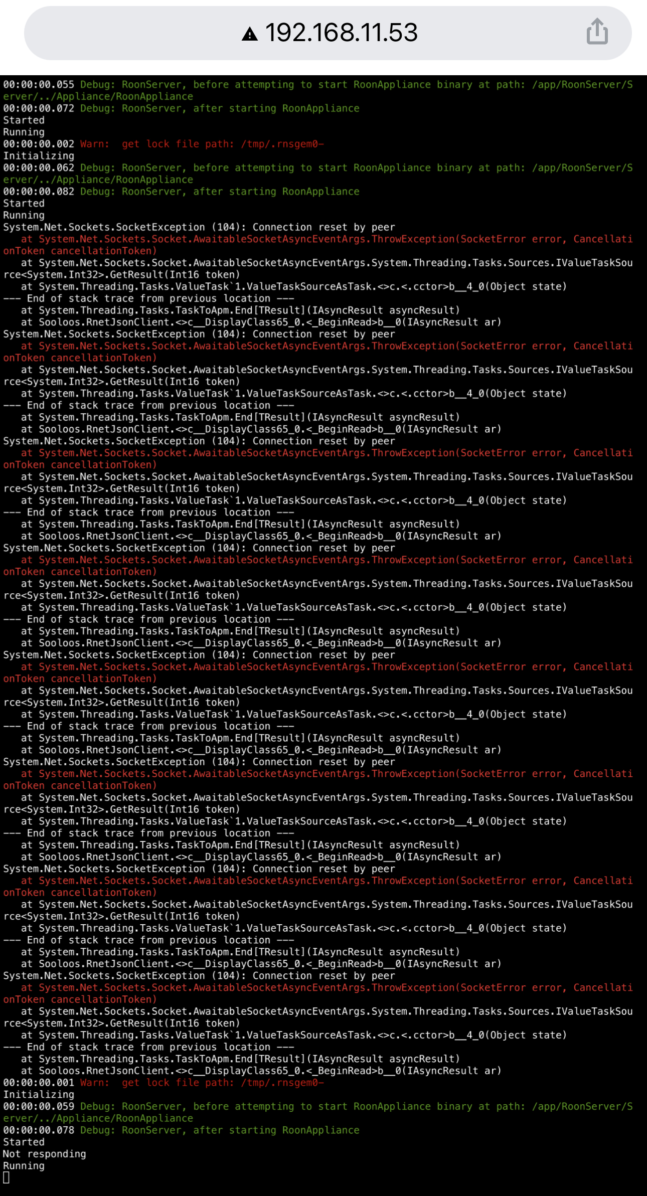

00:00:00.002 Warn:  get lock file path: /tmp/.rnsgem0-
Nothing helped. Not nuking/reinstall. Not installing into /.../mount/user/apps/...  instead of /mount/cache/apps/... - i'm a bit sick of it, because the same thing runs easily on my other (Synology) NAS as a docker. Any more ideas? Shouldn't there be mapping for temp files also (i had this with Unmanic, where it is helpful to map tmp to RAM in any way.
Any ideas?
Roon Docker does not have good logging. As I’m thinking about this, I think it may have more to do with Docker and your system more than the Roon Docker specifically. It’s real odd that you can’t stop the Docker container. I’ve never had a Docker container like that.

It was a docker related issue: Somehow my docker installation changed from "image" to "folder type docker" - perhaps automagically during a major update of unRAID. This lead to a "/mnt/user/system/docker/docker" instead of
"/mnt/user/system/docker/"
under "Settings/DockerSettings". So i had to
  1. shut down the dockers (and make a backup)
  2. move the content from "/docker/docker" to ".../docker"
  3. restart.
Also i noticed, that roon still is slow (about 15 sec), when shutting down. This seems to be related to the general docker "cache vs. /mnt/user" problem - fuse filesystem is slowing down things, when the app share is addresed through the "normal" /mnt/user/appdata directory. After some reading i followed directions to
  1. start mover (to transfer all "appdata" to cache)
  2. shutdown array (to finalize this)
  3. restart array
  4. change share appdata to "cache only"
  5. adjust the paths in the docker template(s) especially roon from "/mnt/user/appdata" to "mnt/cache/appdata" - the same way the template creator made this in his template from the start
Reasons for doing so are described elsewhere, but this indeed did speed up things (and brought down the standby power consumption a few watts).
hth
