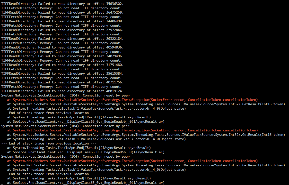

Hello! Can I please ask, what can be the problem behind?
I have Roon installed in the docker @ Unraid, steefdebruijn/docker-roonserver (latest version).
Client is Win11 machine, playing to Topping DX1 and sometimes the playback stops, saying that "Roon has lost the control of the audiodevice". If I'm playing through antoher output, Arturia Minifuse 4, from the same Roon Core, I've never faced (at least I don't remember) such an issue. Sometimes it's quite stable, and can play for an hours without a stop. And sometimes it stops just every minute or so.
A part of the log is here:
   at System.Threading.Tasks.TaskToApm.End[TResult](IAsyncResult asyncResult)
   at Sooloos.RnetJsonClient.<>c__DisplayClass65_0.<_BeginRead>b__0(IAsyncResult ar)
System.Net.Sockets.SocketException (104): Connection reset by peer
   at System.Net.Sockets.Socket.AwaitableSocketAsyncEventArgs.ThrowException(SocketError error, CancellationToken cancellationToken)
   at System.Net.Sockets.Socket.AwaitableSocketAsyncEventArgs.System.Threading.Tasks.Sources.IValueTaskSource<System.Int32>.GetResult(Int16 token)
   at System.Threading.Tasks.ValueTask`1.ValueTaskSourceAsTask.<>c.<.cctor>b__4_0(Object state)
--- End of stack trace from previous location ---
What can be a reason for my issue?

This appears to be an ongoing issue, it's been going on for a couple of months now. It'l interrupt the music session, roon client will say "looking for roon server" and then after a couple of seconds, sometimes up to a minute, itl refind the server, because the docker has restarted on its own. I then have to press play again to resume my listening sessions. There doesn't seem to be any rhyme or reason behind it, it happens randomly throughout the day, high/low disk usage, high/low internet usage, nothing seems to affect when it happens.image.thumb.png.c69e402343061934ca7df0c82423bb6f.png
This may be an issue with Roon: https://community.roonlabs.com/t/investigation-ticket-in-sudden-device-disconnection-and-music-interruption/272107/33
I personally have zero issues with the docker or Roon and have these errors in my log as well. Playback is never an issue for me.
