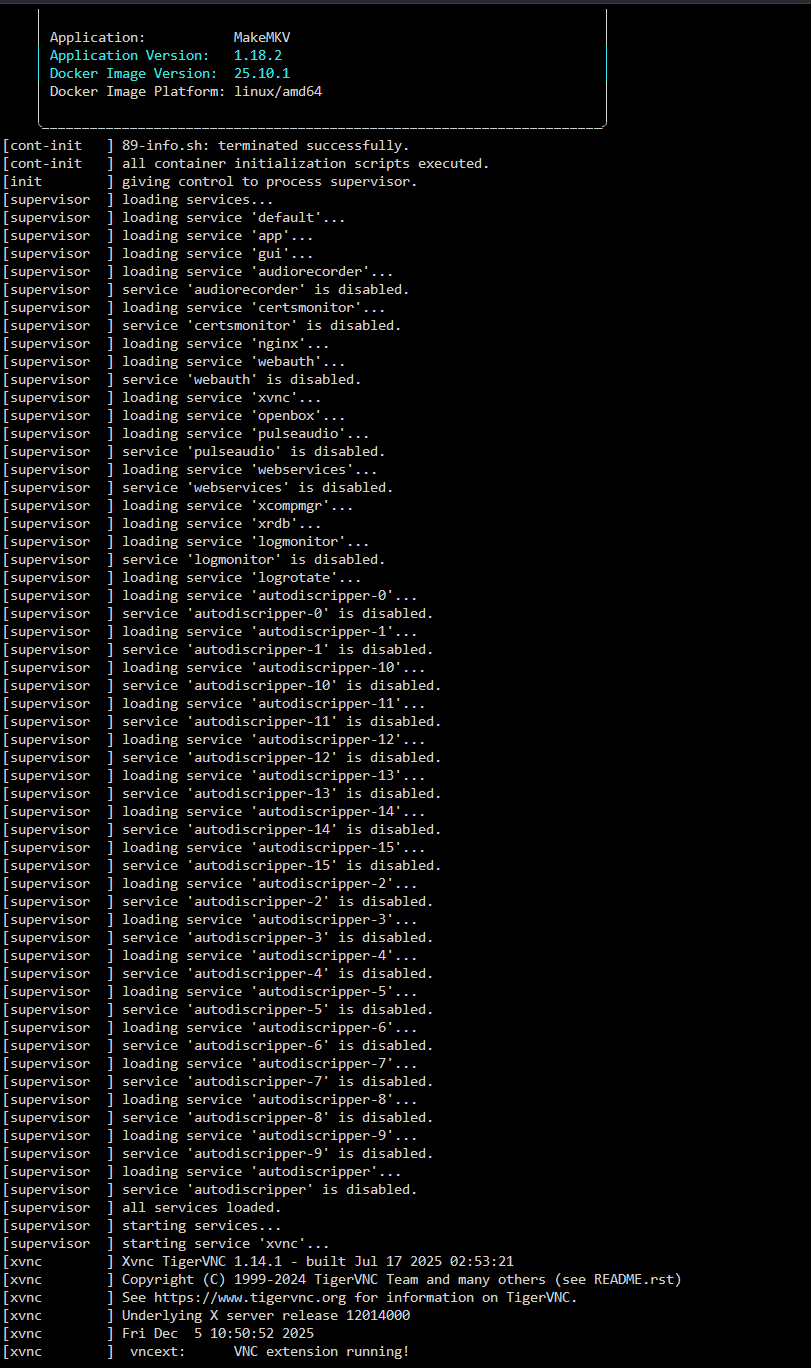

  7. I just completed upgrade from 6.12.13 to 7.2.2 and converted all my drives to XFS. The only issue I had were my Docker Containers. PLEX and Roon Server were recovered via adding new templates but MakeMKV would not run. I left things alone for a few hours and now I cannot connet to the WebGUI. The server is running because I can access all Shares and even play movies via PLEX. Please point me in the right direction Thanks

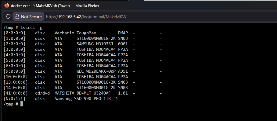

  9. Figured it out...mapped to both sr0 and sg11. sg11 was the actual drive designation. I found that by running lsscsi -g in the unraid terminal and not the docker console. Thanks again
  10. I ran the ISSCSI -g command but didn't get the last 2 columns showing the devices to expose. Am I approaching this correctly?
