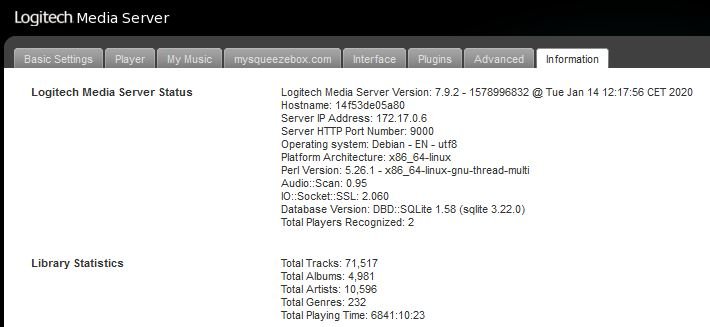

  11. I did. Post and response is here: Logitech Media Server forums The response was: This really is the hostname, given by the underlying system. But you can change LMS' name to something else in the Basic Settings/Media Library Name. Please note that this would change the name shown in apps, but not eg. the URL you'd have to use to access LMS. I've made this change within the app in [Basic Settings -> Media Library Name]. Fixed!
  12. Hopefully a simple question, but I haven't been able to figure out how to change the hostname of my LMS docker. Would like to have something a little more friendly than "14f53de05a80" show up in iPeng, and SqueezePlay, etc... Thanks in advance! Brawny
