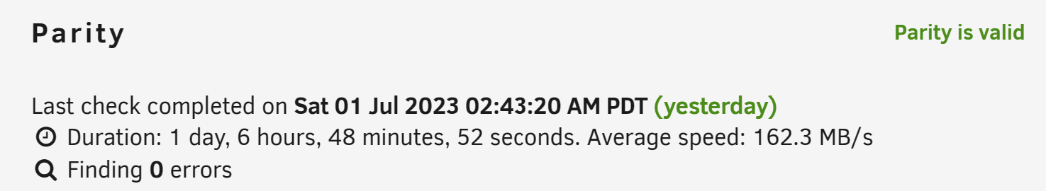

The problem is I cannot rebuild disk 4 when it says "disk not installed", right? How can I rebuild disk 4? How can i get it to stop saying "disk not installed"? I know the cables are good because the replacement disk shows up in UD. But I cannot get disk4 to stop saying "disk not installed". Here is diagnostics. tower-diagnostics-20230706-2259.zip

Here is info from my email warnings over the last week, in chronological order, oldest on top: June 29, 6:09 PM Subject: Alert [TOWER] - Disk 4 in error state (disk dsbl) Description: ST8000DM004-2CX188_WCT0VFC8 (sdf) June 29, 6:09 PM Subject: Warning [TOWER] - array has errors Description: Array has 1 disk with read errors June 29, 6:43 PM Subject: Notice [TOWER] - Parity-Check finished (0 errors) Description: Duration: 2 days, 18 hours, 1 minute, 18 seconds. Average speed: 75.7 MB/s June 29, 7:55 PM Subject: Notice [TOWER] - Read-Check started Description: Size: 18.0 TB June 29, 8:18 PM Event: Unraid Disk 7 SMART health [199] Subject: Warning [TOWER] - udma crc error count is 1 June 30, 9:33 AM Event: Unraid Disk 7 SMART health [199] Subject: Warning [TOWER] - udma crc error count is 2 June 30, 10:03 AM Event: Unraid Disk 7 SMART health [199] Subject: Warning [TOWER] - udma crc error count is 3 July 1, 2:44 AM Event: Unraid Read-Check Subject: Notice [TOWER] - Read-Check finished (932 errors) Description: Canceled

Last night i powered down the Unraid tower. Today before turning on, I swapped the 18TB replacement back to the 8TB original disk4. Powered up and it will not show up on my network - will not run headless. I swapped back to the 18TB that had previously worked headless, but it remained off the network (not headless). so for any suggestions on what to do, I will be doing it with a monitor and keyboard plugged in. UPDATE. I plugged in monitor and saw the IP address changed. Using this new address, I am able now to run it from the network GUI. I am back to showing the 18TB in UD, and array disk4 is "not installed". How do I rebuild when "not installed" ? My dashboard showed this:
