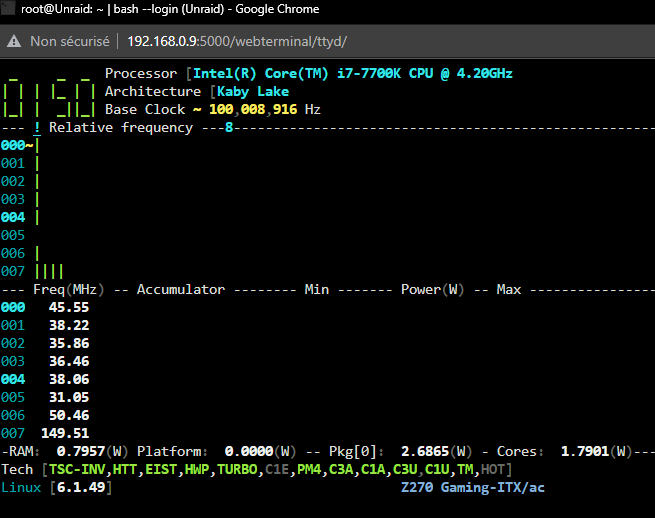

Correct, my 90W TDP, unlocked 7700K will draw under 3W when idle when the C-state settings are done right to allow for it.
