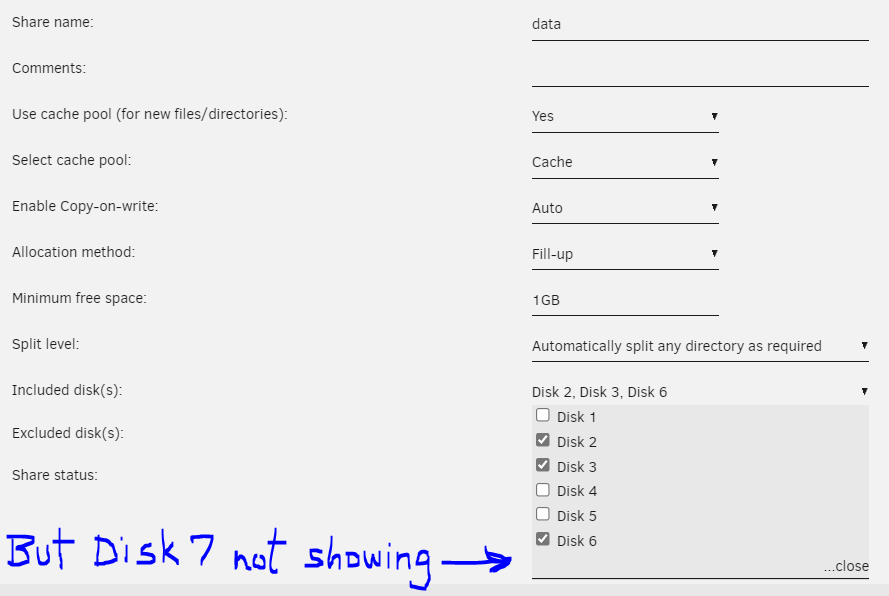

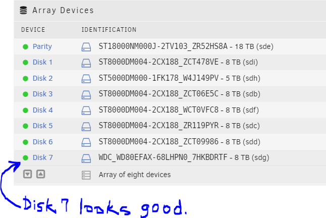

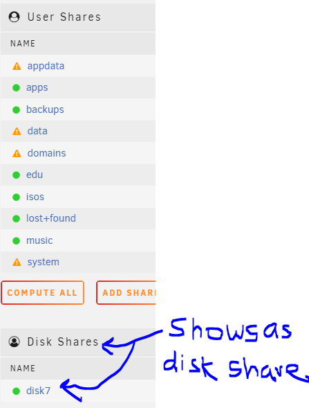

I added a drive to the array, but shares do not show it as a choice I can pick.
I had checked each disk to include in user shares. Maybe I forgot I did that when I added disks before. I will change it to be no disks checked, so all are included automatically. Regarding the "may" vs "will", for me it made the disk into a disk share, without me doing any checking of any check boxes. But as time goes on, I may understand it better. Thanks very much for the extensive help in your replies.
"Settings->Global Share Settings", "Enable disk shares:" was set to "auto". Now is set to "No". Then I could pick disk 7. So I am back to normal. Why did I not have this problem when I added disk 4, 5, and 6? Help says "If set to Auto, only disk shares not participating in User Shares may be exported." Question 1) If I add a new disk, does it immediately go to disk share before I have a chance to put it in User Shares? Question 2) Help says "may be exported", but for me it was exported. Why does help use the word "may".
I found this in the unraid docs: I guess I need to wait for my mover to finish, then stop the array, then see if I can fix it there, at "Settings->Global Share Settings". I did not do anything there previously to cause this problem. The only thing unusual, is Drive 7 used to be my parity, before I got a new parity.
I added drive 7 recently. It looks good on the "main" tab. But when I go to a share, I cannot pick the drive. Here is the 2 screenshots, and diagnostic zip: Notice below, I can only pick drives 1-6 for a share. Why dos it not show Disk 7? tower-diagnostics-20210908-2258.zip I just realized it shows as a Disk share. see below. I don't know how it happened. I am guessing I need to stop it from being a disk share. How do I do that?
