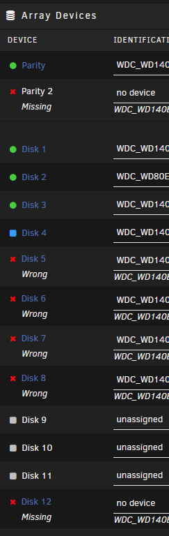

I tried following your procedure. In Step 2 I re-assigned all the drives so that the numbers would be sequential, and unassigned Parity 2:
However in Step 3 it doesn't allow me to start the array. I do not see the option "Parity is valid". Did I do something wrong?
According to your screen shot you have not unassigned disk12 and parity2 so they are shown as 'missing' and disk5-disk8 are showing as assigned but 'wrong' (presumably because their serial numbers are being reported slightly differently).   This will need correcting before you can start the array.
I see what I did wrong.... On the New Config screen, I did select "Retain current assignments", but I forgot to check the box "Yes, I want to do this".....

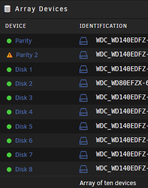

I now managed to go through the steps you outlined and Parity 2 is rebuilding:
Thank you very, very much for your help!! 😀
