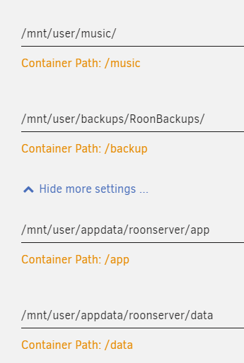

Add these Paths:
Config type: Path
Name: Container Path: /app
Host Path: /mnt/user/appdata
Access Mode: Read/Write
Description:
Config type: Path
Name: Container Path: /data
Description:
Config type: Path
Name: Container Path: /music
Host Path: /mnt/user/audio/music   (***for me, this is my location of music***)
Description:
Config type: Path
Name: Container Path: /backup
Host Path: /mnt/user/backup/roon/
Description:

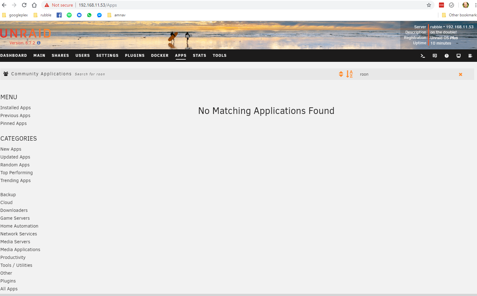

28 minutes ago, dkerlee said:
This Roon docker does not come up via the unRaid Applications search, updated 3/2019
It's on page 2
Yeah, I dunno, it's not in there! Is it perhaps because I only have one docker repository listed? Under Docker > scroll to bottom "https://github.com/limetech/docker-templates"
It's been a while since I've even added a docker, I might be in the wrong tab or something. But I did a little digging and didn't see it. thanks!

If you want any roon related dockers to show up under the Apps tab then you have to have enabled the option to search dockerhub under the settings.   Once you have done that plenty show up but what the difference is I have no idea :(
Thanks for that.
I got this message when I asked about a roon docker for unraid: "We haven't published any Docker images, but a member of our community did: https://github.com/steefdebruijn/docker-roonserver"

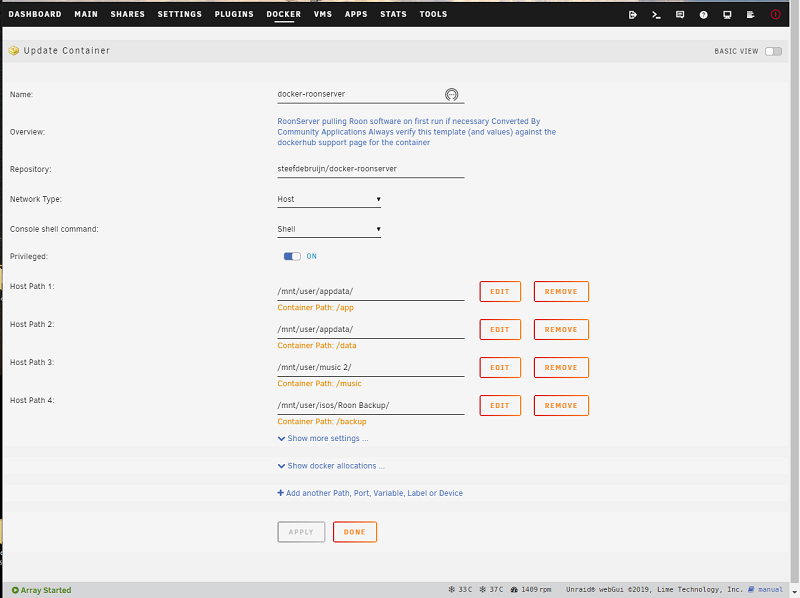

OK, I was able to install the docker listed above and it shows it in the docker tab as "started".  However, it doesn't seem to have installed the actual Roon Server from what I can tell.  Is it necessary to download the Linux based Roon Server (Easy Install Script) from their site and place it somewhere in my shares?
Did enable it, still no roon...? Or do we need to restart apps?
*edit* oh wait there is a tiny blue link you have to click that searches dockerhub... you would expect that it will search automatically when you enable the settings... at least i would.
I think that is deliberate so that the normal Unraid containers do not get buried amongst all the others.
having said that I do not see why you have to even enable that option in the settings.
Correct.  To give precedence to an app that already has a template created for it.
Because I don't want (nor do I think the forum as a whole wants) to be continually helping people with how to interpret the docker run command in the documentation for any given random container (if it even has any docs).  Just simplifies everyone's work around here.
I realized that even though it says the docker is started that there was no volume or port mappings.  It is in "bridge" mode.  I now understand that I must volume map to the app.  I assume that one does that by selecting "Add another Path, Port, Variable, Label or Device".  Are there updated instructions somewhere for this?  At the Github site: https://github.com/steefdebruijn/docker-roonserver it shows VOLUME [ "/ app" , "/ data" , "/ music" , "/ backup" ].  Is this what I should put in "Container Path"?  What about name?
Edit:
I mapped "/app" and "/data" to the appdata share from the pull down menu and "/music" to my music share.
Assuming I am on the right path here, for "/backup" is it OK to map it to my ISO share even though it is "secure"?  I left name blank.  I am now seeing that Roon files are in the appdata share.  However there is no port shown.
Edited by mikela
Ok, i'm lost. Roon docker is running, but now what? There is no webgui, nothing? Is there no gui? What about the paths that are mentioned, also by mikela?
I am using Roon Remote on my iPad to access the core which is now up and running on my unRaid server.  I had to set privileged to on and change network from bridged to host.  This is my first docker, so I'm am not completely confident in the mapping I did above but everything seems to be working now.  I read somewhere that it is best to remap "backup" someplace other than appdata.   Is it OK to map it to my ISO share even though it is "secure"?  Will it write to it?
Edited by mikela

I never specified a port setting.  This is what worked for me: "I had to set privileged to on and change network from bridged to host."
@mikelathat is awesome! Would you post a few screen shots of your settings for posterity?
Thanks Mikela, when i installed the docker, none of these 4 paths were configured or even present in the docker. I've added them manually and now Roon works like a charm 👍
