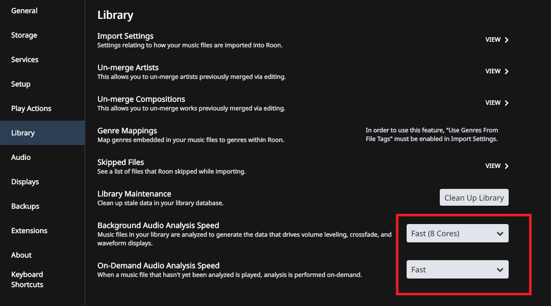

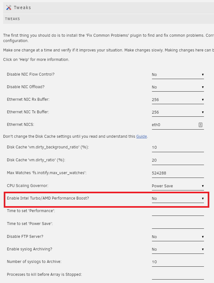

@jowi For what it's worth, Roon will take as much CPU as it's given while analyzing music. Perhaps scale it back some (set to throttled, or remove some cores)? I don't know if that's what's causing your array to lockup, but might be worth looking into. Also, I had an issue where my Xeon CPU would hard lock my system if I ever hit turbo speeds with any heavy CPU load (I could reproduce the hard lock during BOINC or fold@home). Try disabling turbo under the "Tips and Tweaks" app. Perhaps check your IPMI event logs to see if your lockup is hardware related (check for a "CPU_CATERR" event at the same time as the lockup)? If so, perhaps disabling turbo will help if you do have a Xeon 1230. I just realized the i3 in your sig doesn't offer turbo so ignore those steps above if so (just struck them through).
Roon settings for reducing CPU load during library analysis
Where to disable turbo on your Intel CPU (I'm running an ASRock E3C246D4U & Xeon E-2288G so this may not apply to your setup).
