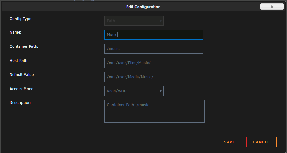

Hey Mikela, can you provide us with a screenshot of both of your music folder settings - the one that currently works and the one that gives you an error? Here is what mine looks like just for reference:
Yeah, a pic of your settings would help. If you're getting an error message indicating a duplicate mount directory it's likely that you're using the same mount point aka container path for the two different host directories.

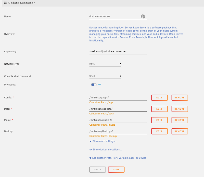

Here are my settings without adding the additional path:

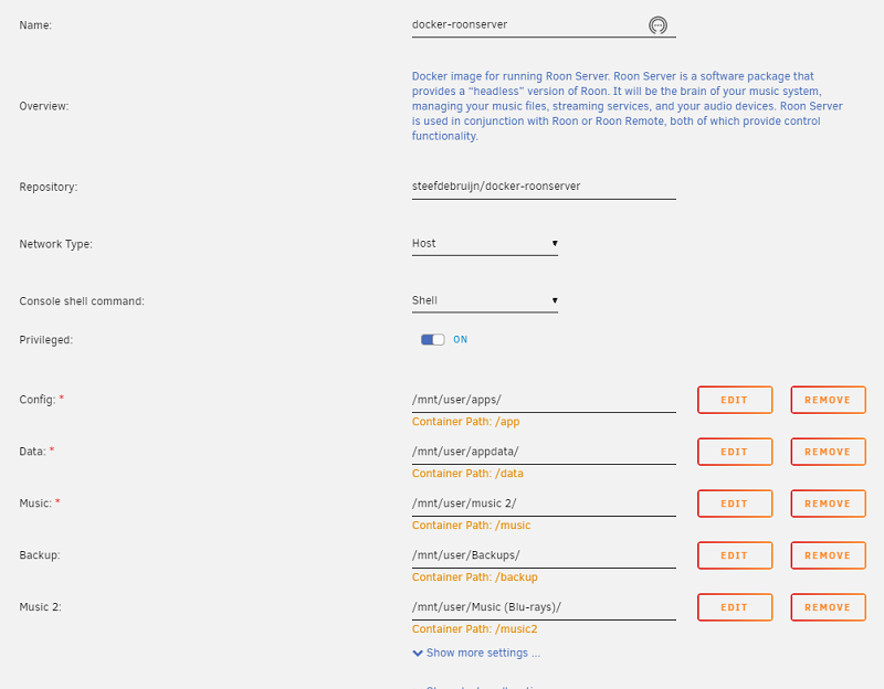

I tried to add another path:  /mnt/user/music (Blu-ray)/ to the Container Path: /music
I just noticed that my share is actually "Music (Blu-ray) and now I can't remember if I used the lower case in my attempt.
Edited by mikela
Mapping two locations to /music is probably the issues. Just map to another folder. For instance:
1. music 2/ > /music
2. music (Blu-ray)/ > /music2
Then, in Roon, simply point it at BOTH /music and /music2
Ahhh...that makes total sense.  I'll give it a shot and report back.
That worked!
Thanks!
Edited by mikela
