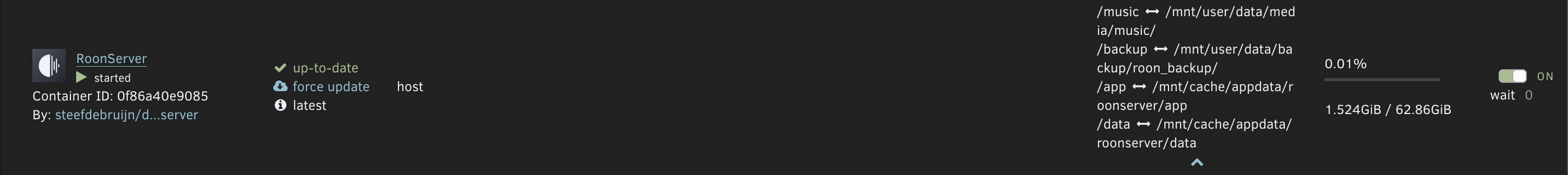

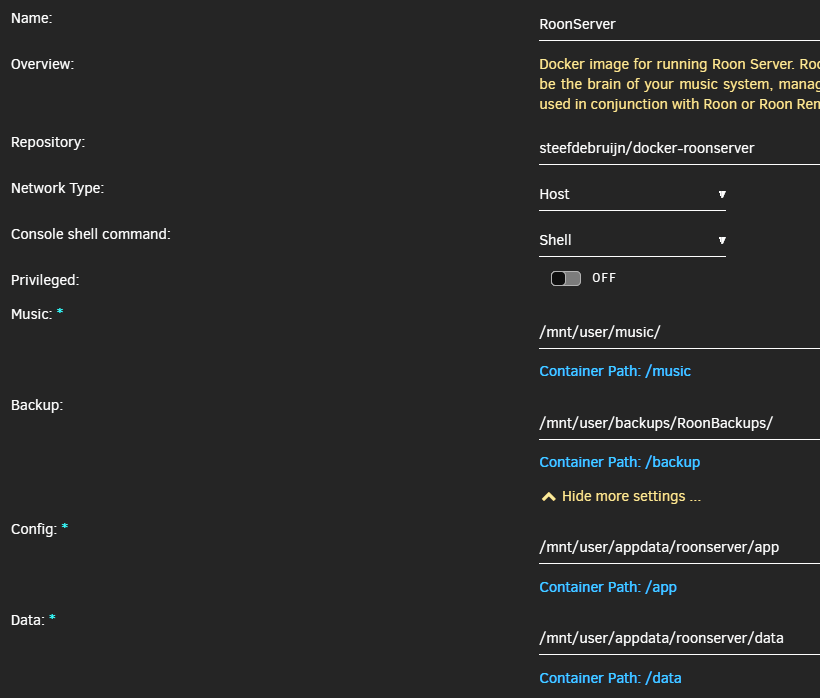

I use SSD cache for the appdata directory.  Here is my mappings:
If I recall correctly, the last path, the data path, is a secondary location for some of my music.  Maybe I should delete that path map.

You shouldn't see any ports (or question marks) associated with your RoonServer container, since no ports should manually be assigned to the RoonServer container and your container should be running in host mode. Based on your screenshot, you do have your container network running as Host, which is correct. As I mentioned previously,  Roon's developers have stated that Roon runs on ports 9003/UDP and 9100-9200/TCP, however they've also mentioned that Roon may randomly assign TCP ports, and other troubleshooting has indicated that Roon conflicts with Emby and Roon, due RoonServer using port 1900, despite the devs never mentioning this. The way Roon manages port allotment is very annoying, and it's frustrating that Roon's devs can't (or won't) be more clear about what ports RoonServer uses.
I looked into changing RoonServer's ports when I was considering rolling my own RoonServer image (to replace Steef's), but it is not possible to change the ports RoonServer uses. You can map your RoonServer container ports to different host ports if you run the container in bridge mode, however, there is no way to tell your various Roon endpoints and apps that your CORE server is running on a different port, so they will not be able to find your Roon CORE server if you do this. I don't know why your container shows three question marks for the port. In my experience, there should not be any ports listed at all, since the container is running in host mode. See my configuration, you'll notice no ports or local container IP listed:
930420219_ScreenShot2021-11-08at12_50_16.thumb.png.2473ba5dfcae8dc601a8e3cbeba499a8.png
The only way to make sure that your RoonServer ports do not conflict with any other running container on your UNRAID server is to make sure not to map any other containers ports to 1900, 9003, or 9100-9200. My suggestion is map your Emby DLNA port to another port, or just remove it as you already did. If you choose to stick with removing it, I'd also turn off DLNA and automatic port mapping within Emby. (In Emby, in Devices>DLNA, turn off “Enable DLNA Play To” and “Enable DLNA server”. In Advanced turn off “Enable automatic port mapping”). Roon plays well with Plex, which also uses port 1900 for UPnP discovery, so the problem seems to be with Emby rather than Roon. Apparently this is a known issue with Roon and Emby. You can read more about it here. Your safest bet for now is to keep port 1900 open, along with 9003 and 9100-9200.
The data path contains Roon's database, logs, and cache files (including those for RoonServer, RAATServer, and RoonGoer). Deleting this directory alone will only cause you more problems. If you want to reinstall RoonServer my suggestion is that you delete your entire appdata folder, delete your RoonServer container (and RoonServer image), and reinstall using the template in CommunityApps.

If you want to see the 3 question marks for roon ports, go into any unraid docker container setting screen, and click the image.png.23da70edb1fe599b15b27943e90f730b.png and you will see it.  But now with your reply, I know what really is going on with the roon ports.  I also posted at roon labs forum and steef replied that he does not recommend messing with assigning ports for roon in the container settings - that when he tried it, it did not work well.
