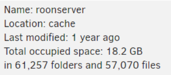

Roon site told me to not run the database on a hard drive, and it should be run on SSD.   I replied:
No. I am not saying the Roon database is running on hard drive. I checked my Roon docker container settings and the music is on hard drive but the app is on SSD cache. Here is info about the folder for Roon app on cache:
When Roon 2 came out, did it require reading the music files again? Why is Roon thrashing my hard drive(s)?
My Roon container is set like this:
My appdata share is set to cache "Prefer".
Roon says I have 135,000 tracks. Lately I do not hear the thrashing. Maybe it was related to update to Roon 2, and maybe the worst is over.

At Roon, garym replied to me:
after I installed roon 2.0, it rescanned all my 130,000+ files for volume normalization. that took almost 3 days on my NUC.
Good chance that was my problem.
Glad you were able to figure it out @xrqp

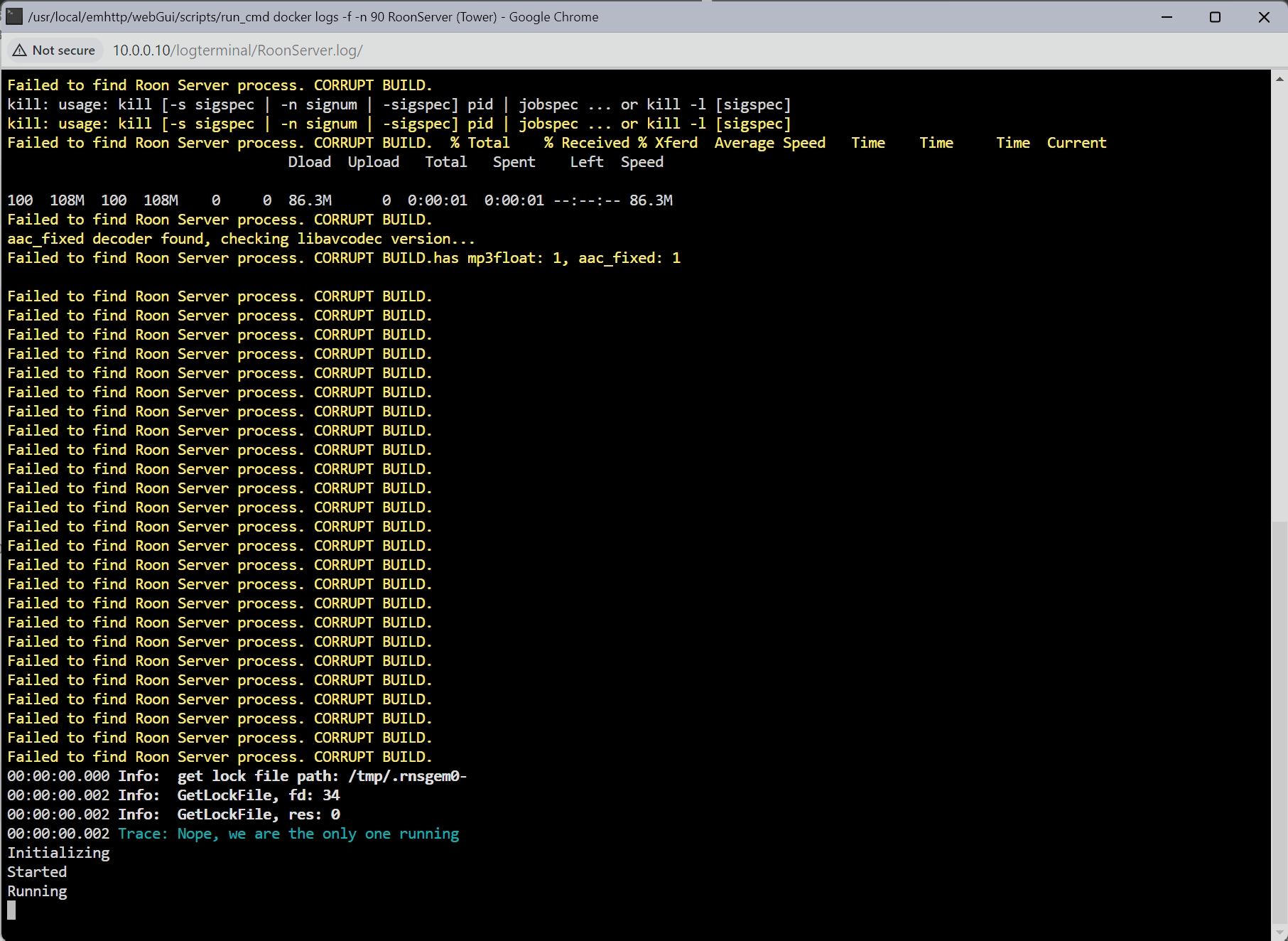

I've had issues with my docker build becoming corrupt, without any action from my side. It would always work when i reinstalled it, and then end up not working.
I recently upgraded from 6.12.6 to 6.12.10 and now it seems to work, which i find quite strange..
Anyways, wanted to share. I'm just happy it's finally stable for me.
