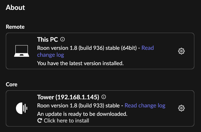

How to handle Roon updates if the Roon core is on Unraid NAS in a docker.  Trying to refresh my memory on this:
Is it correct that:
  1. We should only upgrade the Roon core via Unraid's docker page?
  2. We should NOT update the Roon core via Roon app nagging to update?
  3. If you updated the core from the Roon app, it does not work, but it does not harm anything?
When the Roon app gives a nag to update, it gives a choice of "update all" or "view details" or "x" to close the nag.  I clicked view details then it showed that it is my Unraid Tower that it wants to update.  Here is screenshot:
I think one time i clicked it to "update all", but nothing happened to the core.  So it seems the core update fails, but maybe there is no harm done to the core.
I usually update via Windows nag screen and it seems to work aok for both Core (on Docker) and local client.
I will second updating both Core and the Roon endpoint sw install from the nag screen with no problem.
Thanks for replies.  I will try updating the core and all, from the nag next time, and pay attention if it works.
I think for most programs we should only update dockers from the unraid docker tab, but the Roon core docker is unusual, so I guess it does not apply.
It's not really that the Roon docker image is unusual, just that some docker images are designed in such a way that each release of the image is pinned to a specific version of containerized program, whereas for the Roon docker image this is not the case.  As others have said, updating your CORE via Roon running on another system (PC, Mac, or Linux {via Wine}) works perfectly at this point.
Good to hear that.  That is ideal.  Can it also be updated from the Unraid docker screen?  Does it do the same thing either way?
I always dismiss the nag screen.  It always updates the next time I start my server.  Unlike many, I shut down my server daily.
