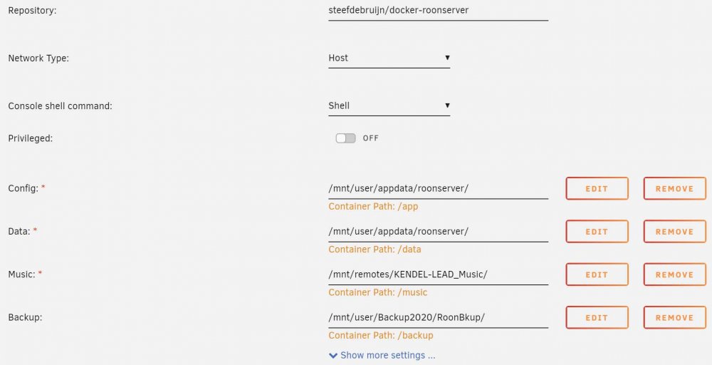

6 hours ago, Kendel said:
Looks like you are sending both the roonserver app and data to the same location.

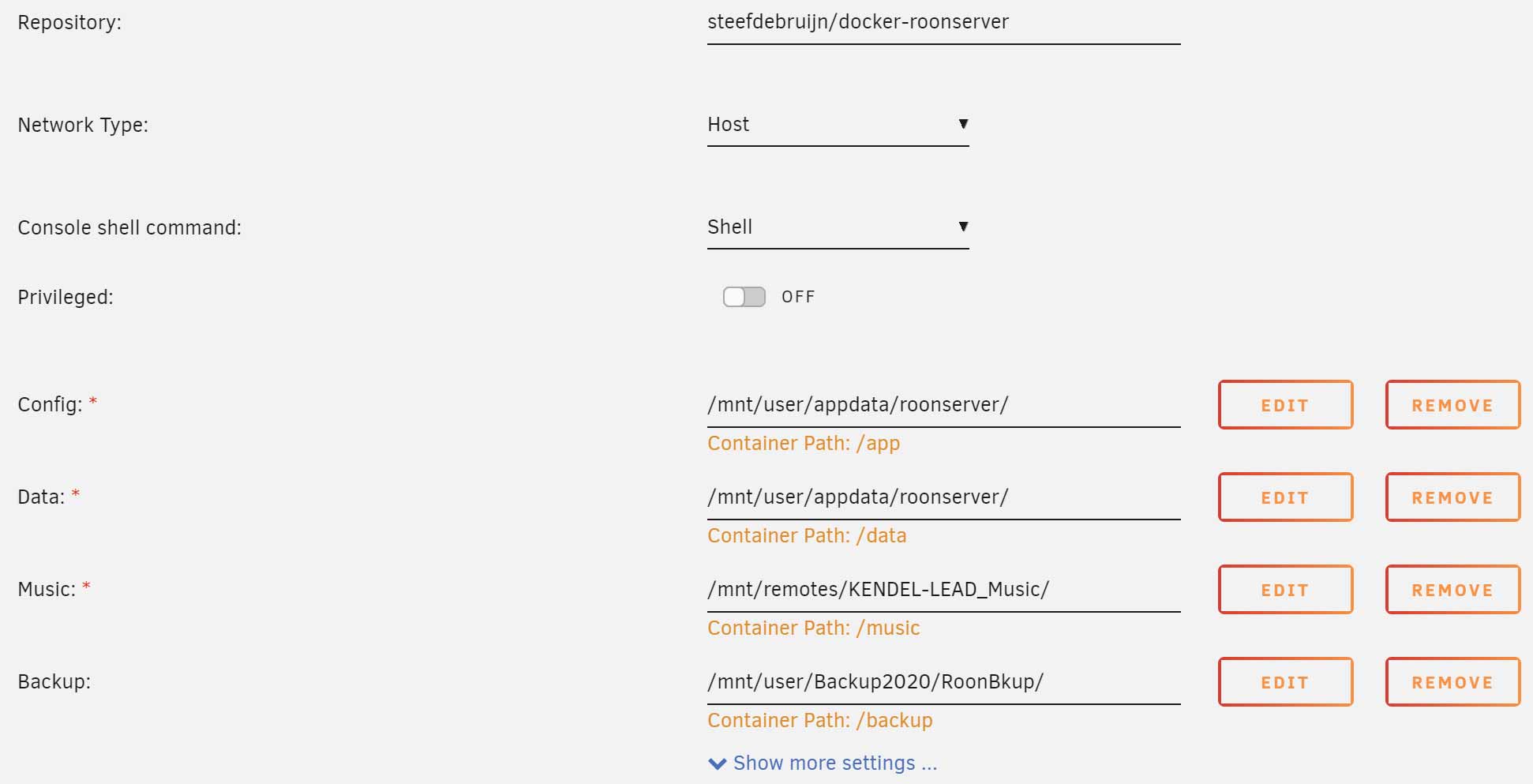

7 hours ago, Kendel said:
Config photo
Yep, as @mikela suggestes, your problem stems from the fact that you have the /app and /data directories mounted in the same host directory. We previously identified this as the causes of some major problems associated with updating and I then updated my template. You should be able to fix this problem fairly easily by either:
A) Choosing one of the options I describe here, if you want to try to keep your existing library. More work, but you get to keep your existing library data.
or B) if you'd prefer to start from scratch (which will be easier, but will require you to delete your appdata folder and rebuild your library), you should change up your container configuration to match something like this (the backup and music directory location are up to you of course):

You won't necessarily need to do to this manually - if you remove your RoonServer container and delete your RoonServer appdata folder, then search for Roon in Community Apps and my most recent template should be available, which has the correct directory mappings.
1125319966_ScreenShot2021-02-26at6_58_52PM.thumb.png.2e4305df0f2205577be22fe67a6920e4.png

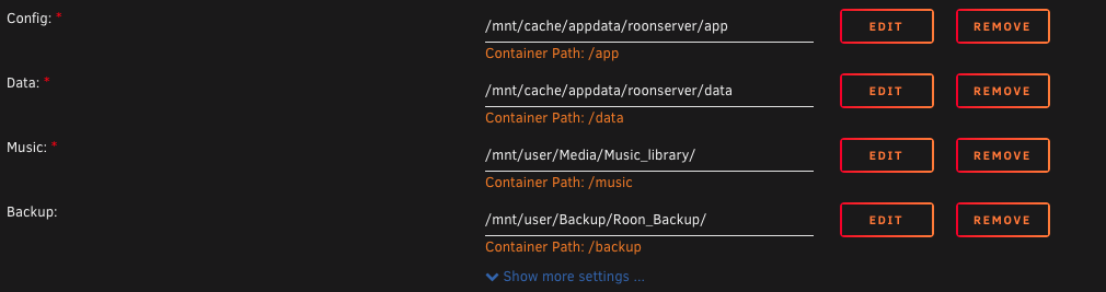

Thanks All!!
I'm trying option B since I've already lost my earlier libraries.
Roon is running now building my "new" library.  Hopefully this will work whenever the next Roon update comes along....
Thanks again for your help!

Just as a followup.....   Roon just had the latest patch to 1.8(build 778).  The update went great and no issues.  All of my library was still there.
Awesome!!  Thanks for the help all!

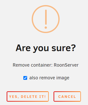

First, make sure you have a backup of your Roon data. You do this via the App. Those details are sorta outside this Docker Thread - but relevant to what you're trying to do.
https://help.roonlabs.com/portal/en/kb/articles/backup
I'd also take a screen shot of your docker setup details. That will also avoid re-doing some work.
Then: remove the docker, and nuke the appdata/ folder. That will send you to ground zero.
Re-download the docker
restore backup
Bob's your uncle.
Couple important notes: Don't ROOT while drunk. Be SUPER CAREFUL with the command
rm -Rf foldername/<enter>
This will indiscriminately trash everything. You can make A LOT of work for yourself in a short amount of time if you nerf this command.
