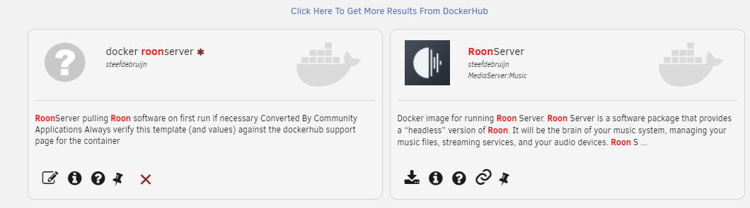

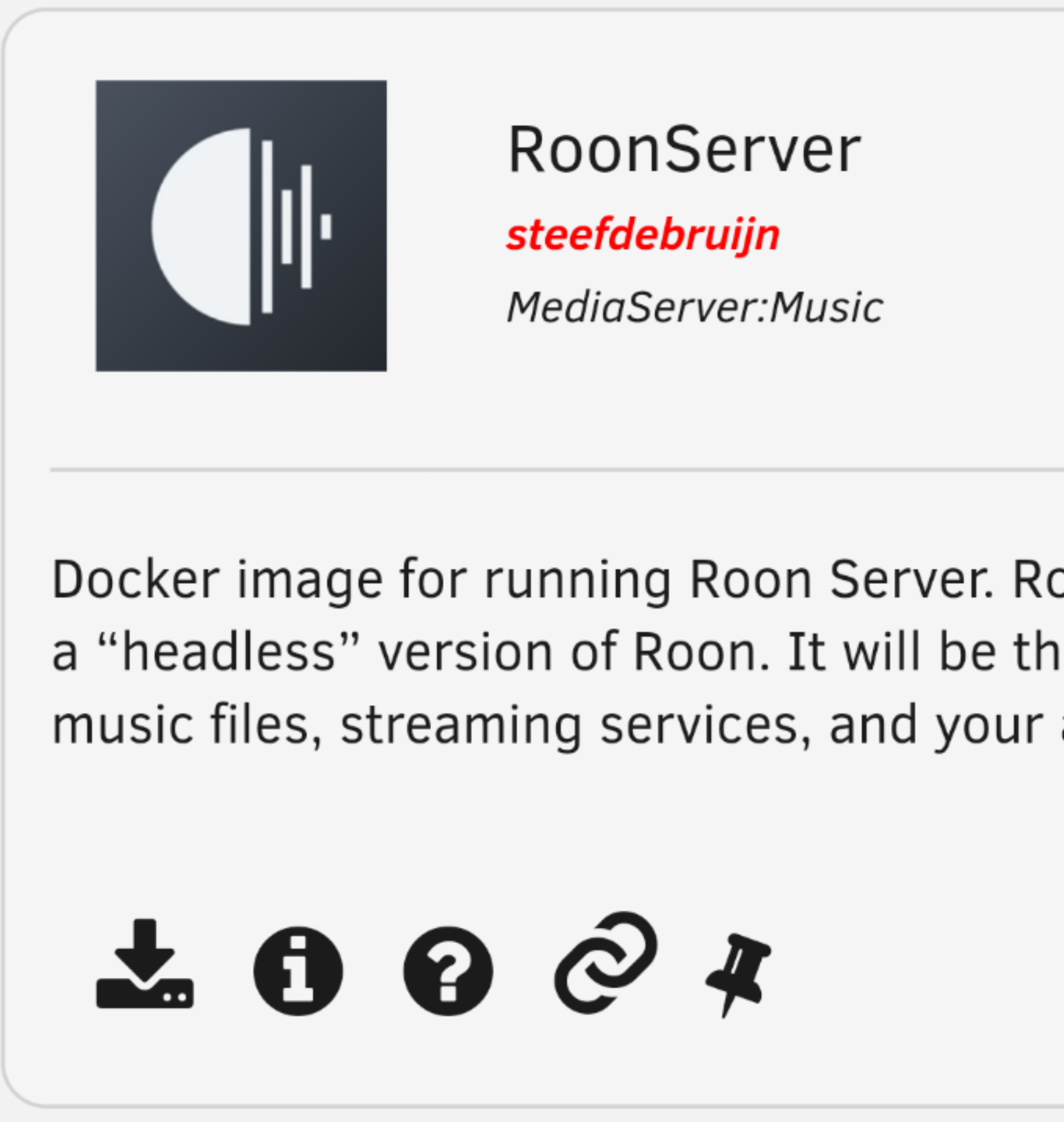

Hey folks, just to let you know, I've made an UNRAID template for this RoonServer docker that should be showing up in Community Applications now (since I have a linked template repo). Thanks for your work getting this working @dkerlee. Cheers and feel free to let me know if you have any problems here:

@xthursdayx really cool. Before I dump this one, and switch to yours, can you tell me about it? I only have a remedial understanding of Docker and how that works, and it appears that you're using the same image that "roon-server" uses? Why is one different than the other? Thanks again!

If it's from the same repo (e.g. "steefdebruijn/docker-roonserver") then no diff. What he did was just to create Unraid template for the docker so the necessary mappings are visible.

Exactly, I just made a template for other folks since people seem to stumble over creating their own volume mappings. No need to dump your existing config as it's probably the same as the template (minus the container icon).
Terrific, great. Ya, I wish some of those things were filled out for me! Thank you.
