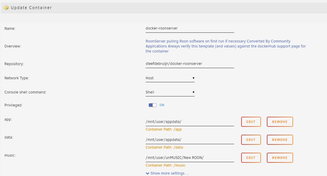

can someone tell me what explicitly I have to put into the template and how to do it? I have roon running and tried to add a path to my music share but for the life of me I cannot find that path in the roon interface.
Any help would be appriciated
Take a look at the first post of this thread. In the picture following "Now install the Docker via Apps. Here's the setup:"
You can see the settings for one of the entries. To get that entry option to pop-up, hit the "+ Add another Path, Port, Variable, Label or Device" button. Then make the entries match the examples given in the first post.
Hey brill it worked and I finally get it, I am essentially creating a link between the container and the unraid?  Well anyway its important lets see how we get on!
Thanks for your help
