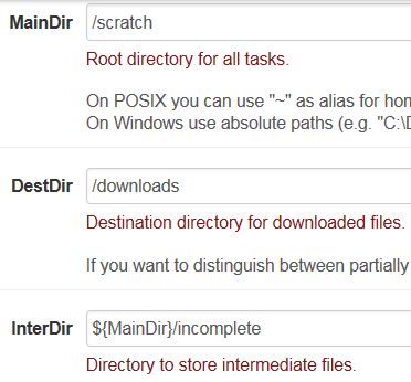

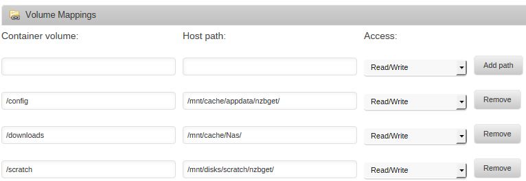

I've not noticed this behaviour.  Post a screenshot of your NZBGet settings, sometimes a second pair of eyes can help...
I've just started using NZBGet and noticed that when a download completes my array spins up.
Normally I have all processes with unRaid take place on my cache drive and only spin up the array to manually archive data.
I've checked my volume mappings and there's nothing pointed at the array proper, just the cache drive and a SSD mounted outside the array.
Array is 5 drives formatted with reiserfs and 1 drive formatted XFS.
All 5 reiserfs drives get spun up after every download. The 6th (XFS) never does. unRaid reports some read action on the 5 drives, never any writing. NZBGet shouldn't even know the array exists let alone spin it up and read from it.
Anyone else notice this behavior? I rarely spin up my array unless necessary so this is very annoying. I used to run SABnzbd on a VM and this never happened until switching to the NZBget docker.
The way it's setup is that NZBGet will download to an externally mounted SSD (/scratch). The files will then be unpacked from the /scratch/incomplete folder to my cache drive where Sonarr or CP will process them. None of these dockers are mapped to the actual array in any way, only the /scratch and /cache drives. It's a mystery as to why my array spins up, and oddly, not the XFS drive.
