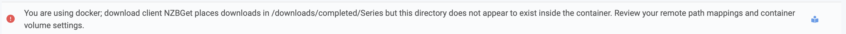

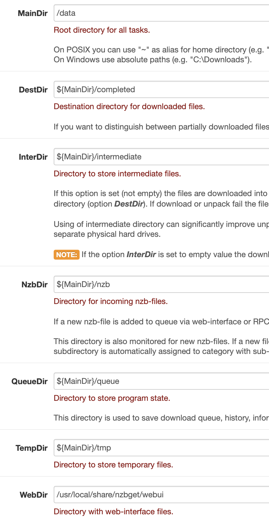

Hello

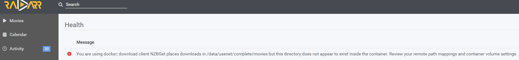

I am new to Unraid and have been farting around for days but cannot get my Radarr/NZBGet working.  I would appreciate it immensely if someone could explain to me in plain English, how I get rid of these errors?
Does it have anything to do with this?
or maybe on of these?
Thanks legends...
EDIT:  While I am at it, I get this in Radarr but not in Sonarr..?
EDIT2:Now I am getting it in Sonarr also.  I don't get what it means "inside the container"...

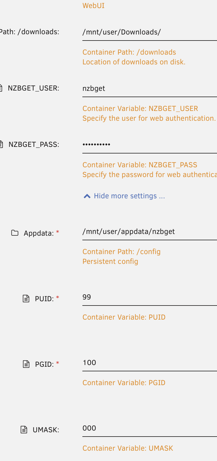

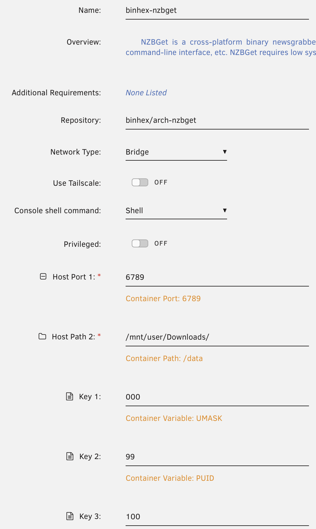

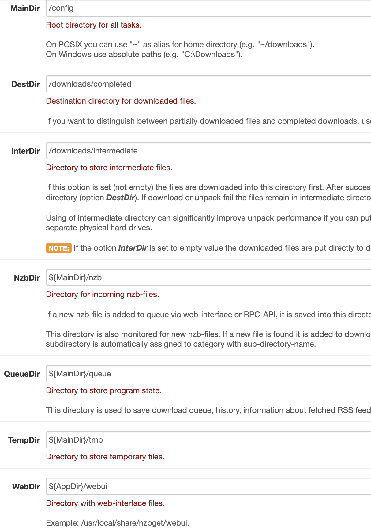

Im trying to switch from binhex to your docker as the binhex unpack process continually fails every couple of hours (known issue with binhex NzbGet). I'm having an issue where by Sonarr cannot rename/move the file to media following download with linuxservers NzbGet. binhex NzbGet is working fine with Sonarr, is im unsure how mappings could be an issue.
Im unsure if this is path mapping or permissions issue, but im really stumped. Would appreciate some advice! refer images for set up of both dockers, including path mappings and Sonarr errors.
Binhex working mapping
Linuxserver set up

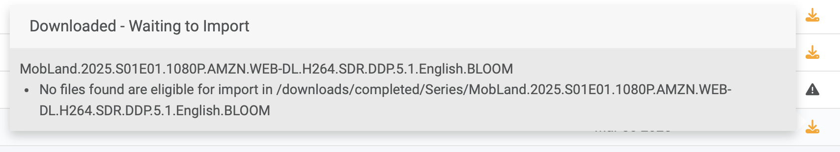

Sonarr errors
