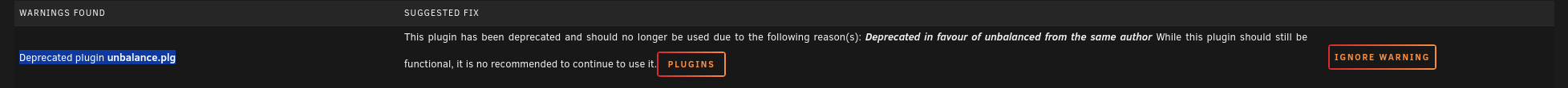

  3. So I got a warning in Fix Common Problems that Unbalance is deprecated? Anyone know what's the go with that? It was really useful.
