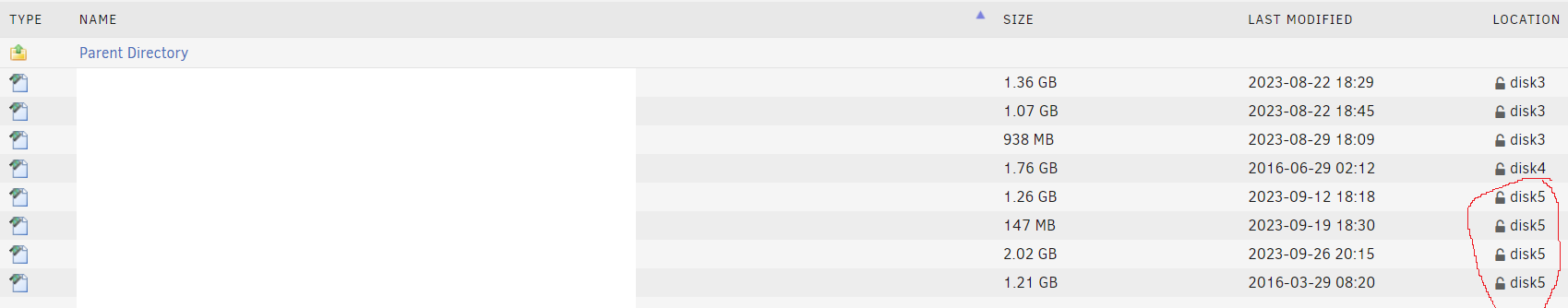

Uninstalled Sonarr, deleted it's appdata, reinstalled: fixed. Weird. <shrug>

My Plex install is reporting it can't see episodes 6-9. Episodes 1-5 are spread over several drives, and eps 6-9 are all on the same Disk5. Sonarr reports the same thing: can't see those episodes and thinks they're missing. When doing into Docker icon > Console_, and I navigate to and see the files no problem. Krusader can see them. Main > Console can CLI over there, looks the same. Same owner, same permissions. I did recently have a full Cache drive that caused all sorts of issues. I set the Min Free Space, hopefully avoiding that in the future. Any ideas what might be causing this odd file behavior? I have restarted the server once or twice. Doesn't seem to fix anything. rubble-syslog-20231105-0512.zip
